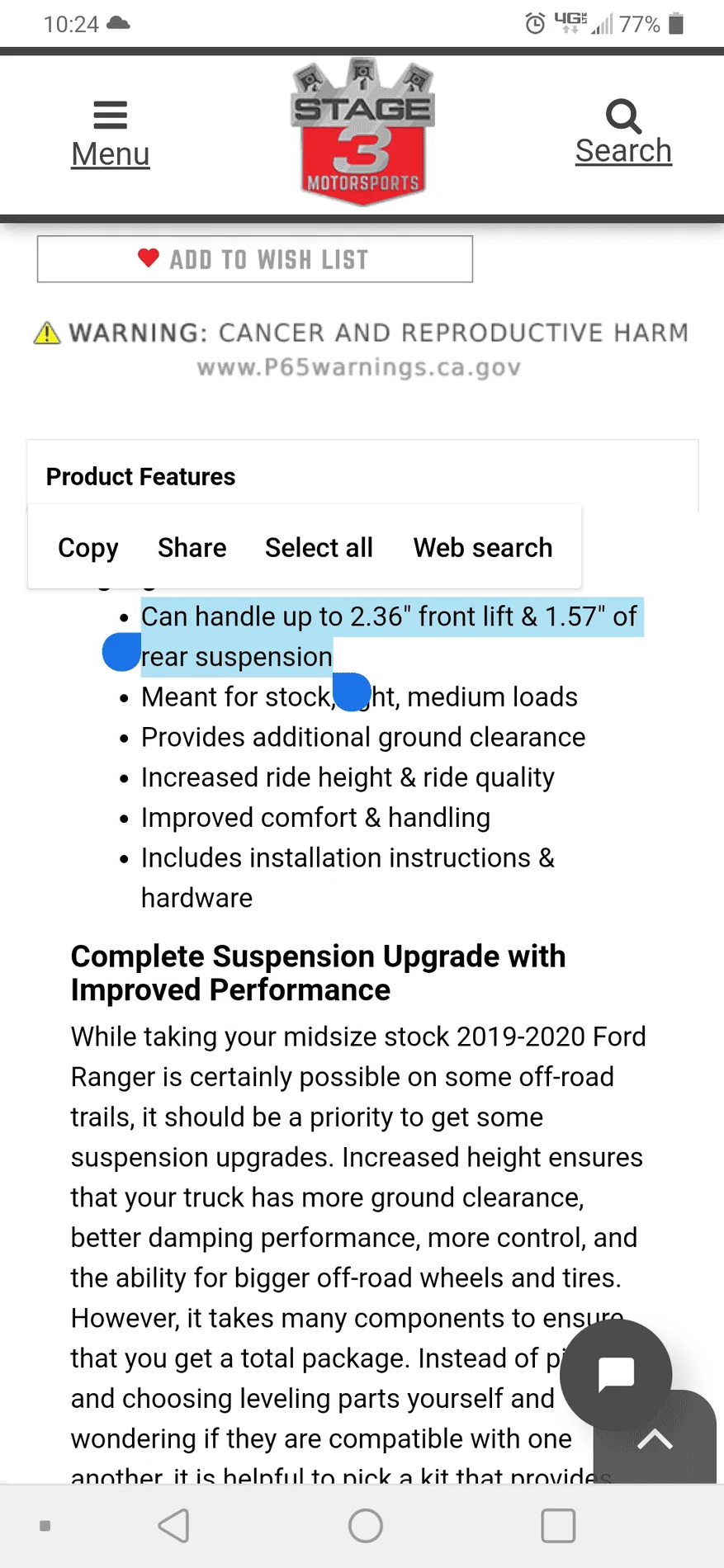

Having discussed this with friends in the offroad community, I decided to get the OME system. But alas, not available in Canada. Stage 3 has a shipping quote request system but they have never gotten back to me. Might have to use a redirect shipping company to hotshot it across the boarder.

This is something I have thought about. I have heard of rusting issues on jeep OME. And it gets very salty up here. I got a quote for shipping and it's $300 plus duty and tax.

Ah, that would be nice, but I have no estimate on how long I would have to wait. I can't find anything about those for rangers being worked on. Also I was wrong on my shipping estimate. It was $483.10 USD plus duty and GST

Ended up finding the lift $200 cheaper through a local distributor so I'll have it in a couple months. Ome it is. And if it has too much rake I can throw in a .5" strut spacer in the front.
