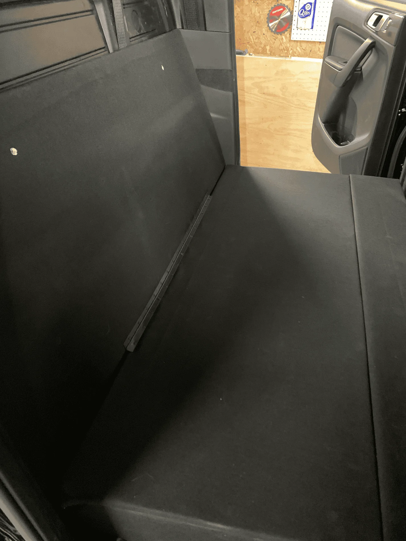

that looks really nice, i want to do something similiar, how is the noise in the cab with your set up? i took out my rear seat in the supercrew and the noise through the vents on the back wall is horrendous
Kinda hard to quantify as I only had a rear seat for about a week. However, I decided to forego putting any sound deadening material on the back wall of the cab despite that being my original intention. As it turns out the extra dampening is not entirely necessary, couldn't have hurt but, the 1/2" plywood and cordura do a superb job of keeping things quiet.

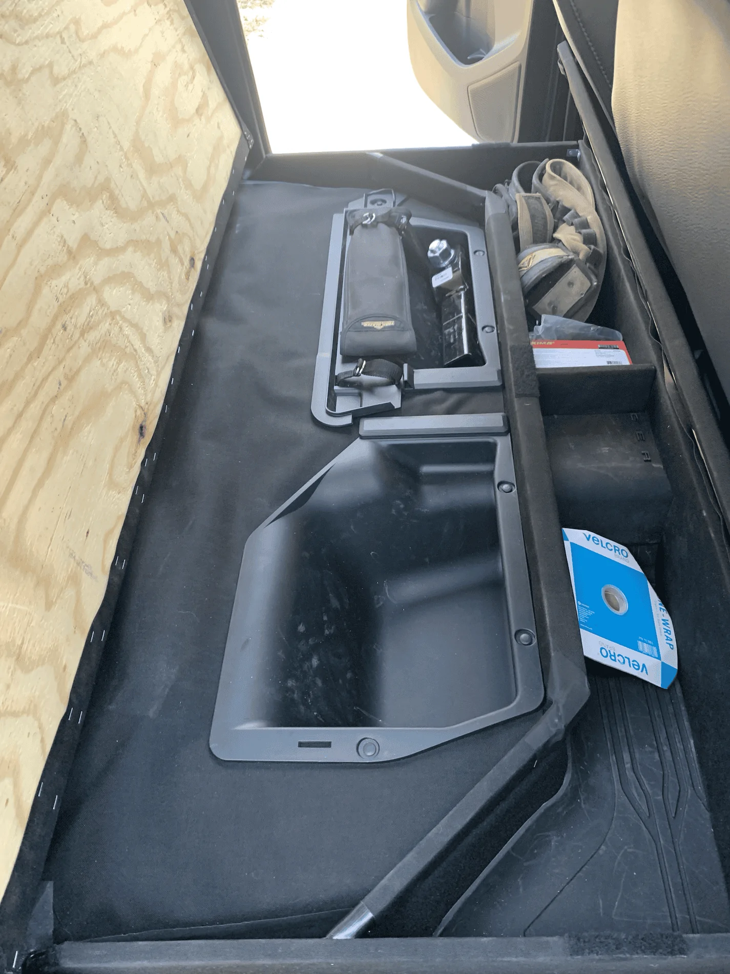

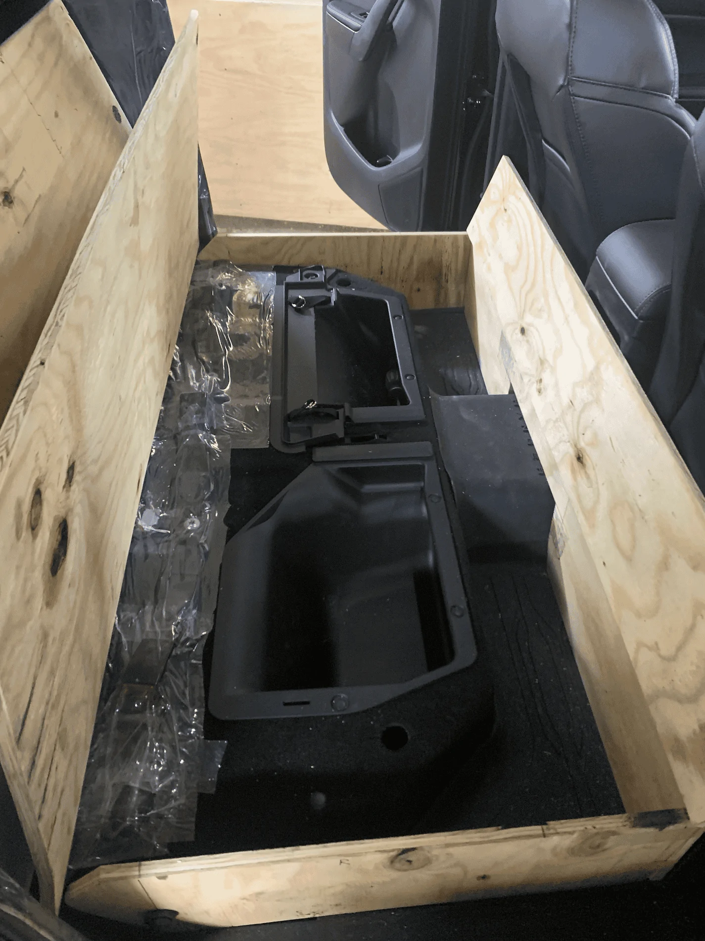

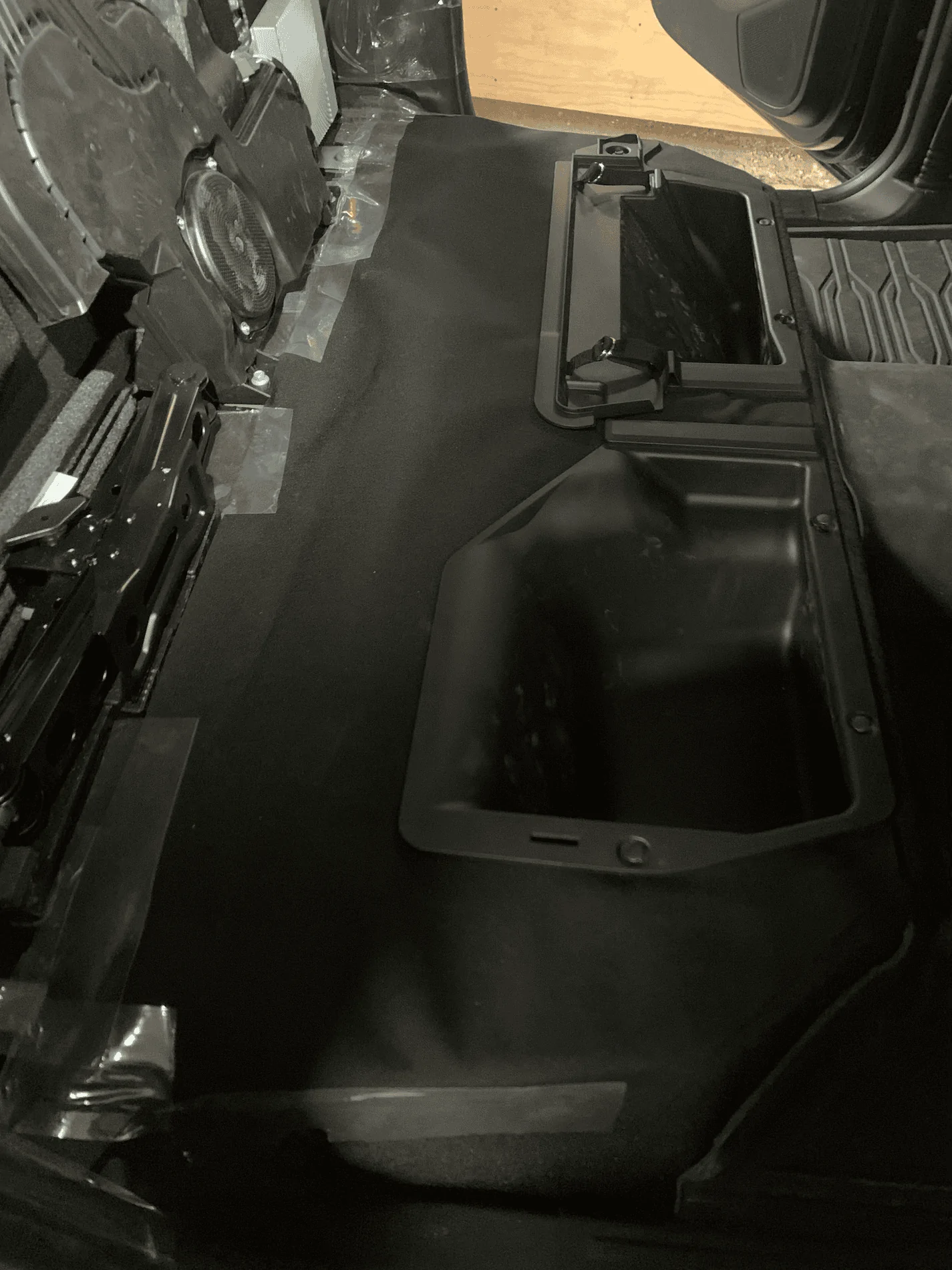

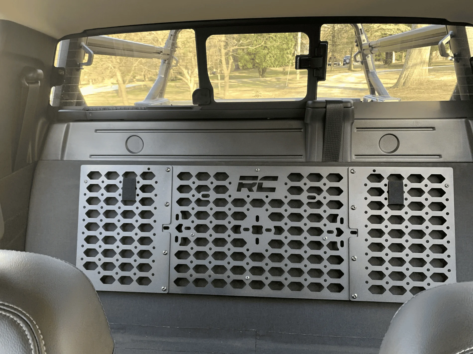

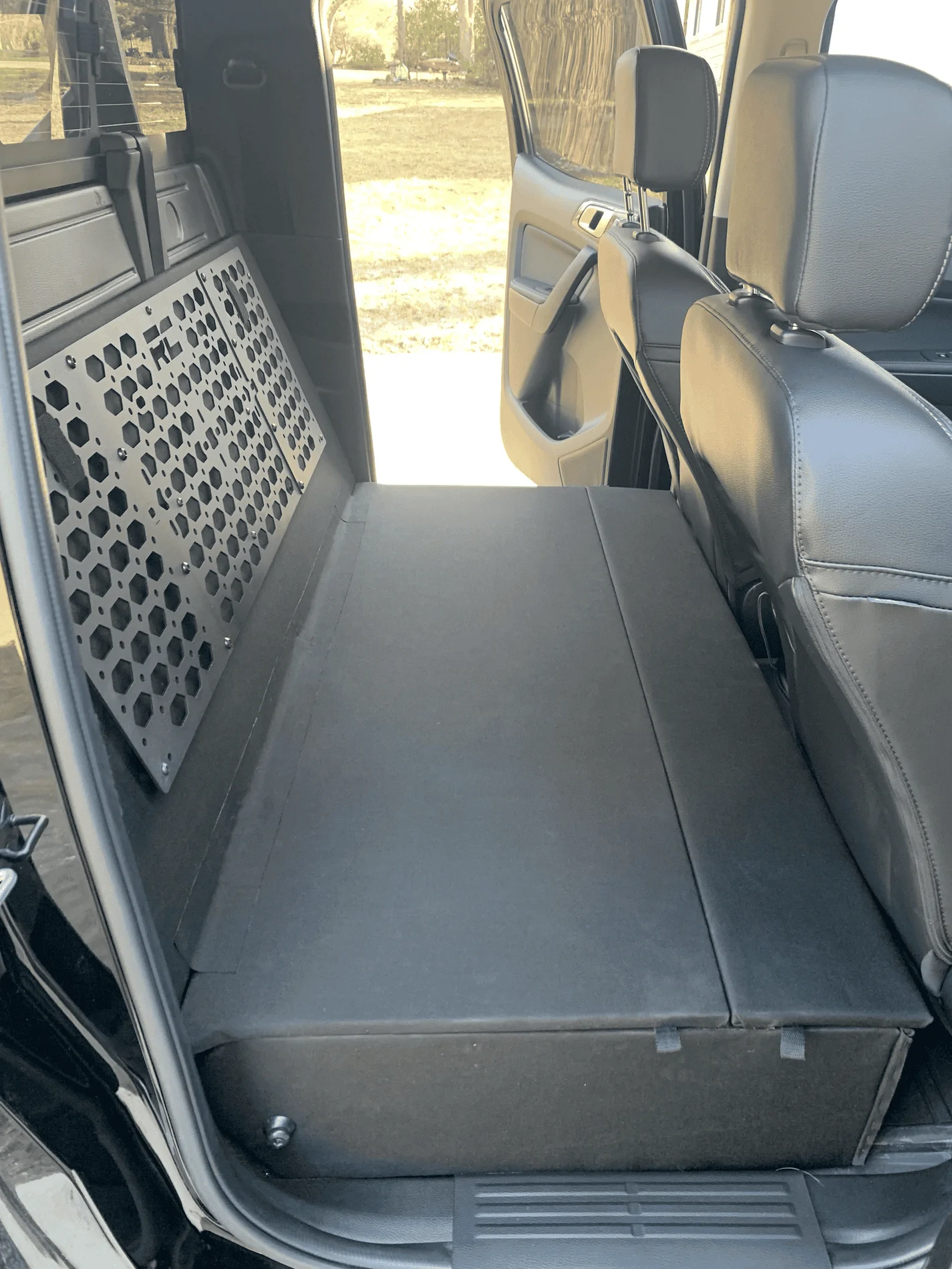

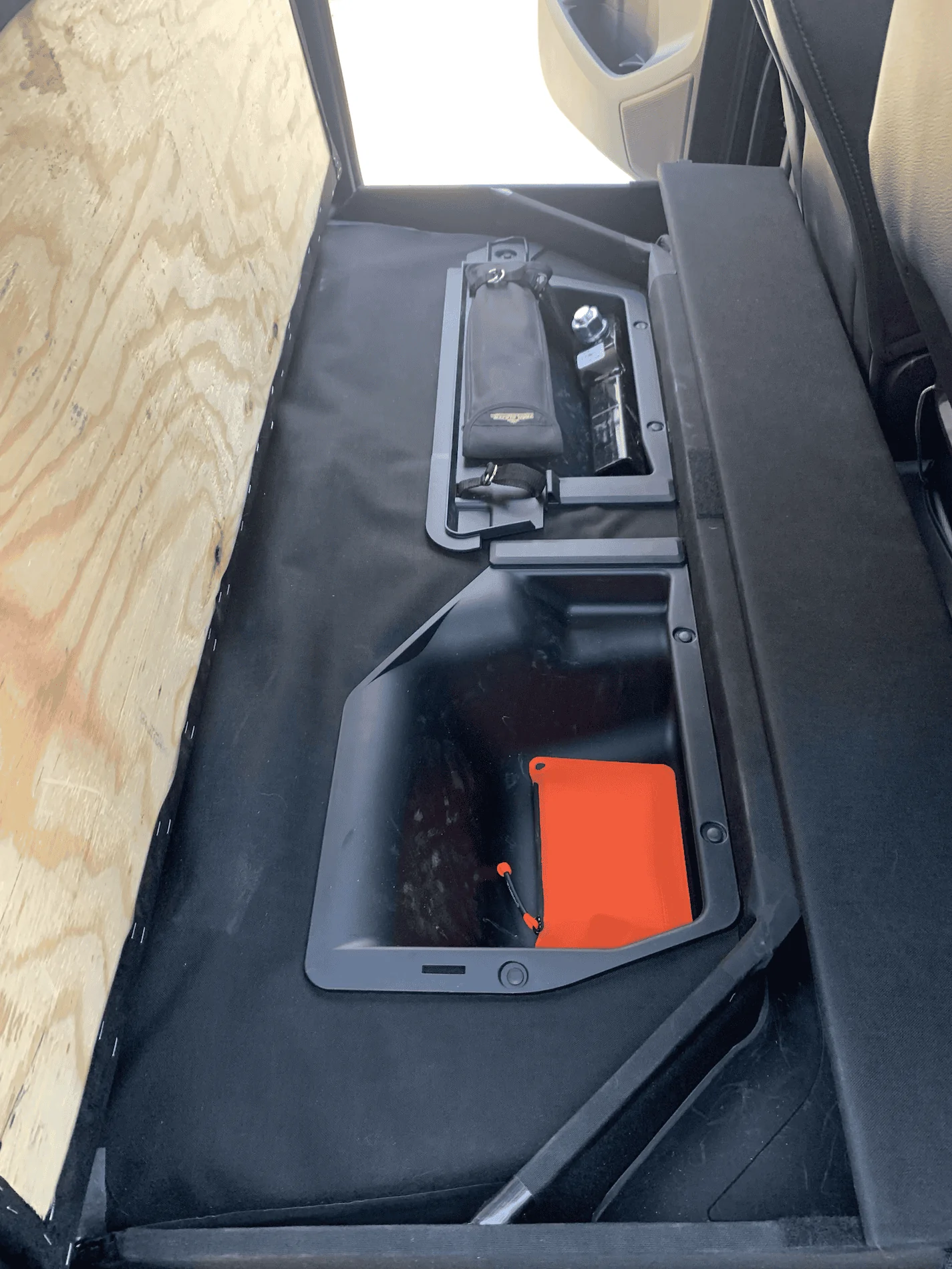

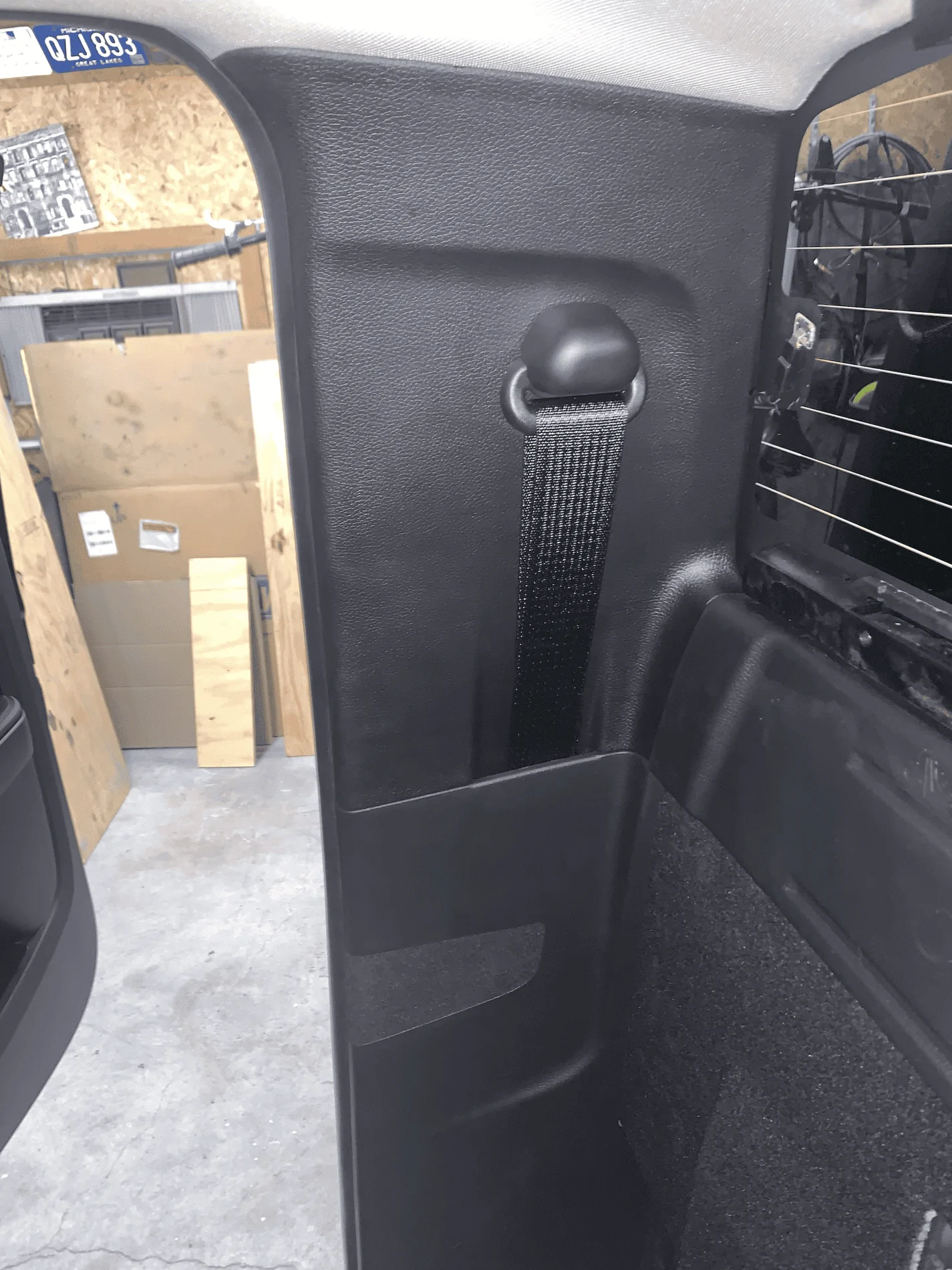

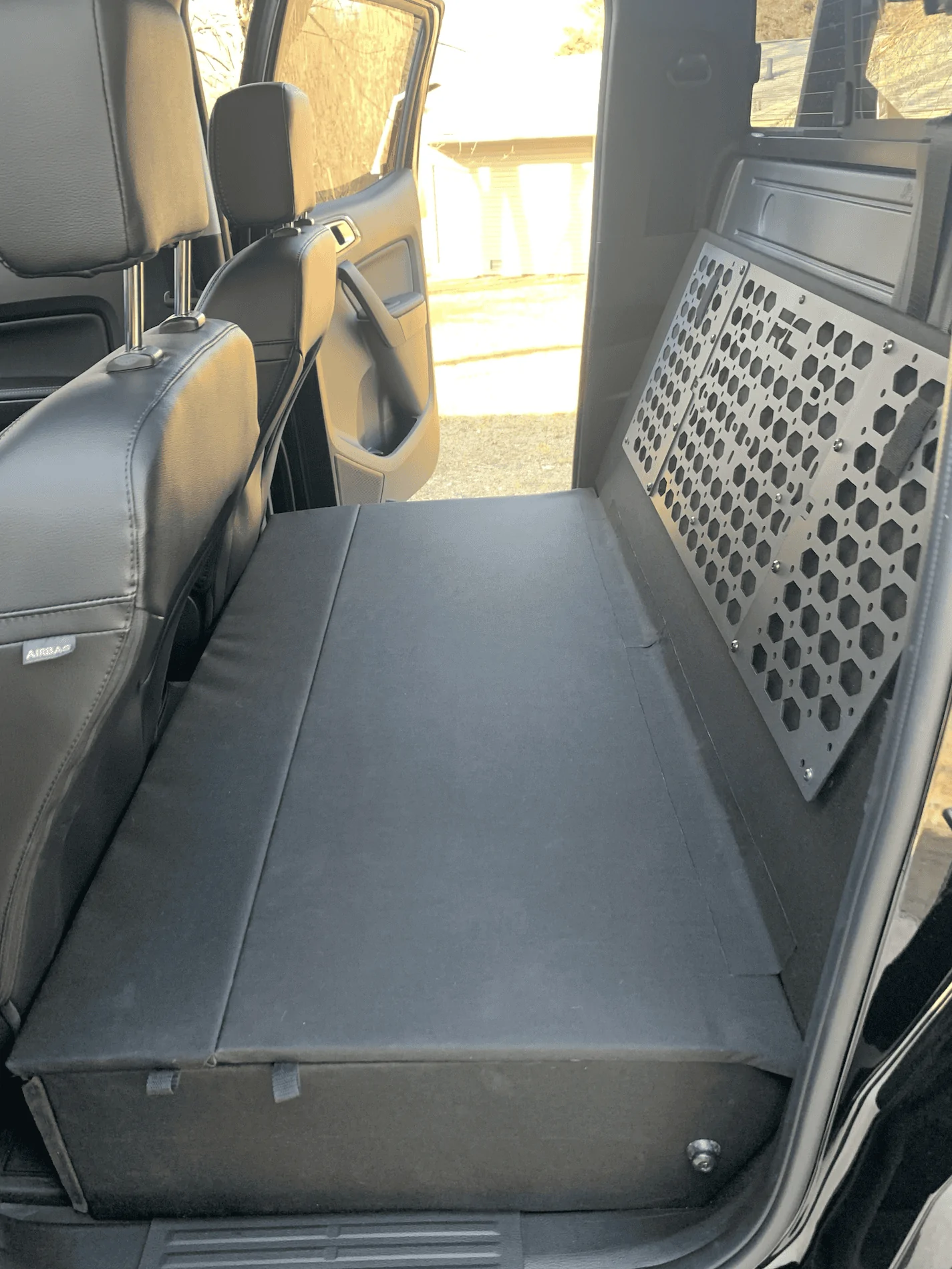

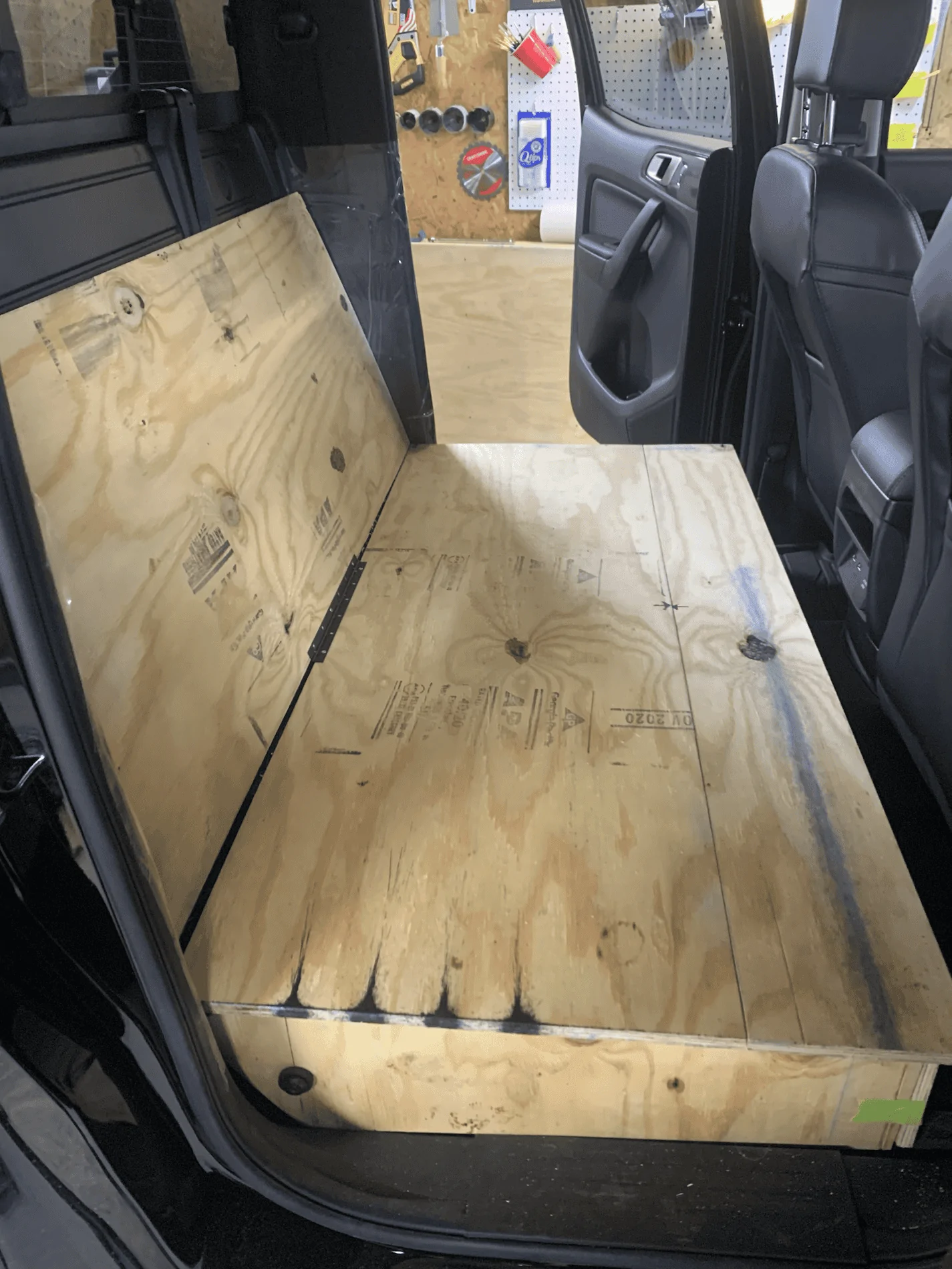

I bought my Ranger knowing I would be removing the rear seat. I have no need for it and a flat floor is much more useful for me. Storage along with it a bonus. Searched them internets, made a few calls and emails, no dice for anything pre made....yet. I don't hang my hat on "coming soon" or "pre-orders". So for about $300 in materials and about 24hrs labor, I solved this pesky problem....came out pretty good....in my opinion.

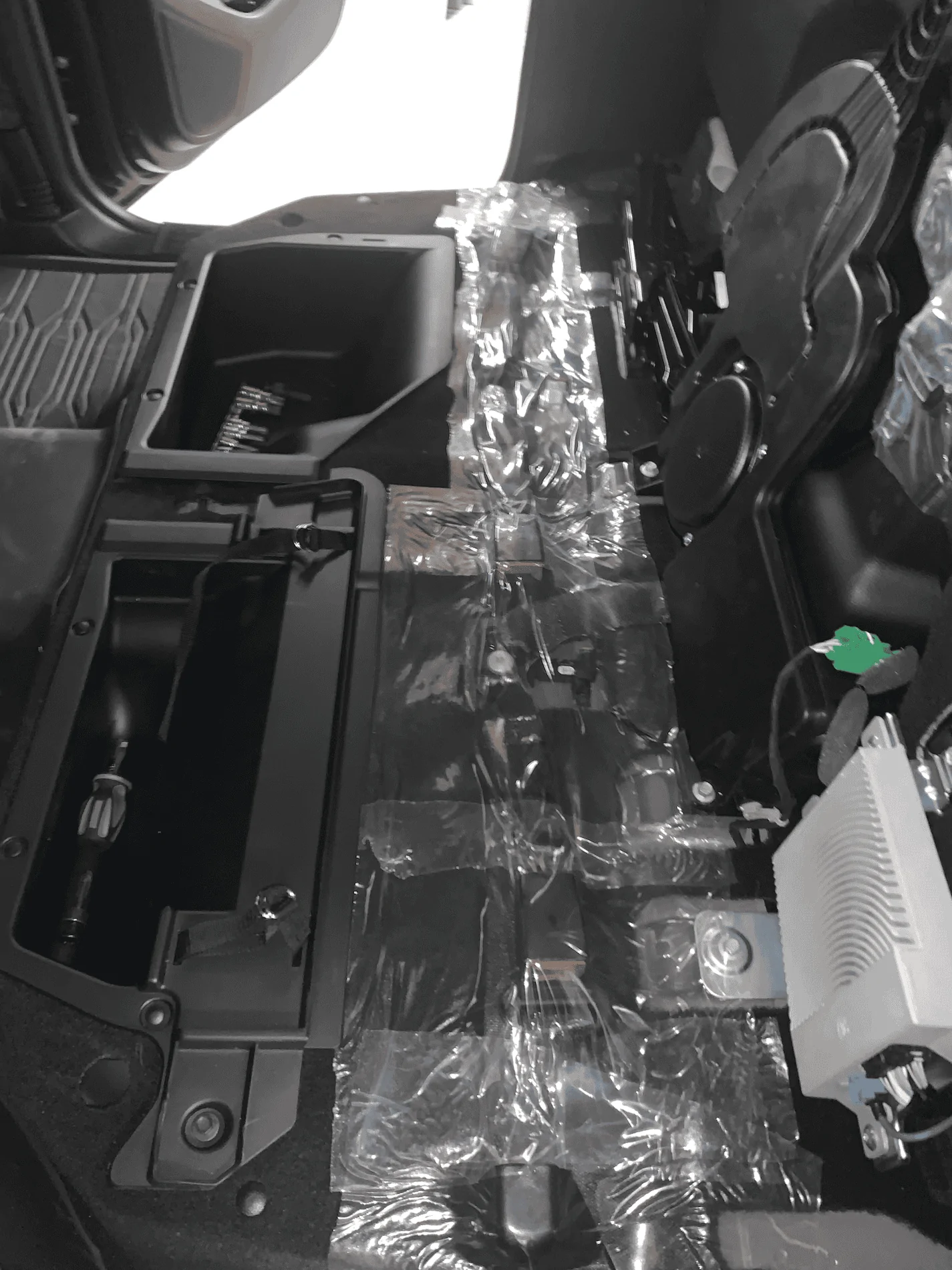

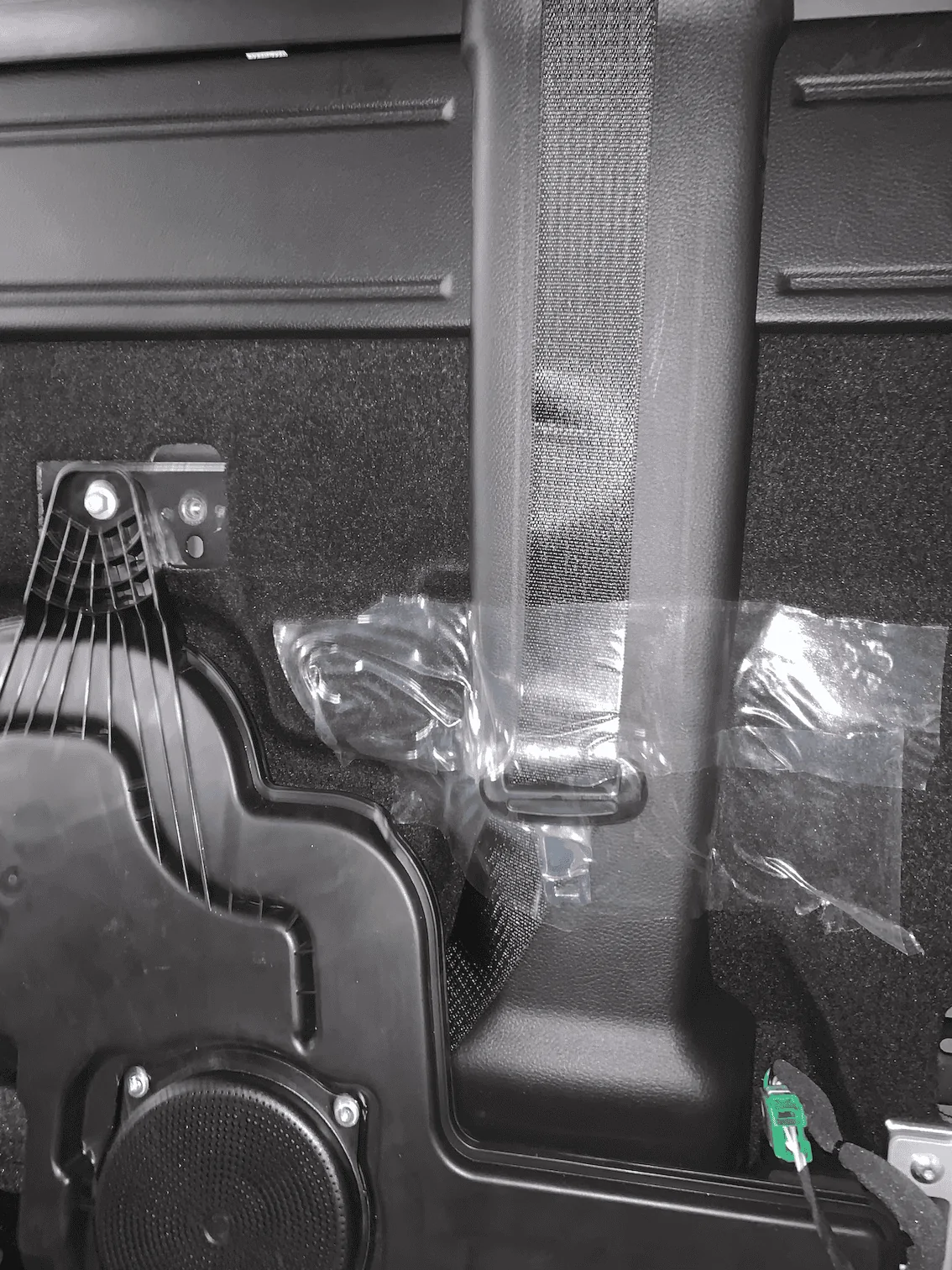

No physical modifications necessary. View attachment 76220 I wanted to be able to put the truck back to completely stock with no trace of modification. I used the lower seatbelt mounting bolts to secure the base and, the back is bolted to the threaded inserts where the seat back mounts were. The seatbelts were re-routed behind the trim panels. I didn't feel like re-wiring the seatbelt/airbag sensors so, I left them and worked around them. I used some of that sticky plastic protective sheeting to secure them. They now act as support for the floor. After I wrapped all of the panels I still had some fabric left so, I removed the cubbies, laid the fabric over the floor and reinstalled the cubbies. The center spine where the lids meet is secured to the sides of the base and also via brackets that use the push fasteners for the cubbies. The whole unit is super solid. The back has a hole cut for the subwoofer and folds forward for access to the jack and sub/amp, should I ever need to get at them. The front seats have full range of travel and recline. I also got a significant bump in sound deadening in the back. It's also already dog approved.

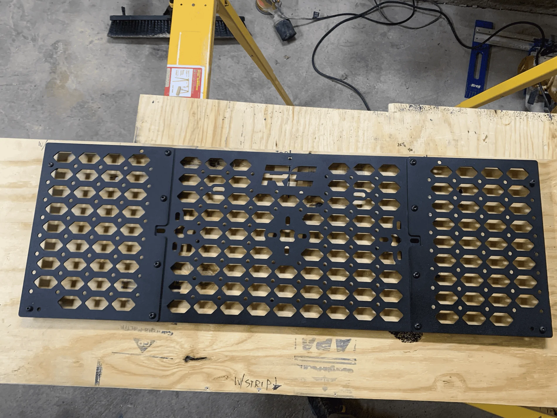

Materials used: (2) sheets of 5/8" plywood, (4) yards 1000D Cordura, (2) yards 1/8" closed cell foam (shelf liner), Rough Country molle bed rack for a Tacoma, and various assorted hardwares and adhesives. Most of the stuff I had in the garage from past projects. The rest was just ingenuity, trial and error, and a lot of experience in making something from nothing.

I'm about 2000 miles due east of you. Kinda far for a weekend jaunt. If I get some time or, the right offer...I might tear it apart and make some cut sheets so it can be replicated. I though about doing this as I was building but, I have a hard time stopping once I get going.

The fabric is 1000D Cordura. The kind of stuff that backpacks are made from. Definitely not as forgiving to work with as carpet but, it's water and stain resistant, dog hair doesn't get sewn into it and, easy to clean.

Might be able to scoop it up at Michaels or Jo-Ann or some other fabric store. That said, I ordered it from eBay. It was pretty inexpensive...maybe around $10/yd.
