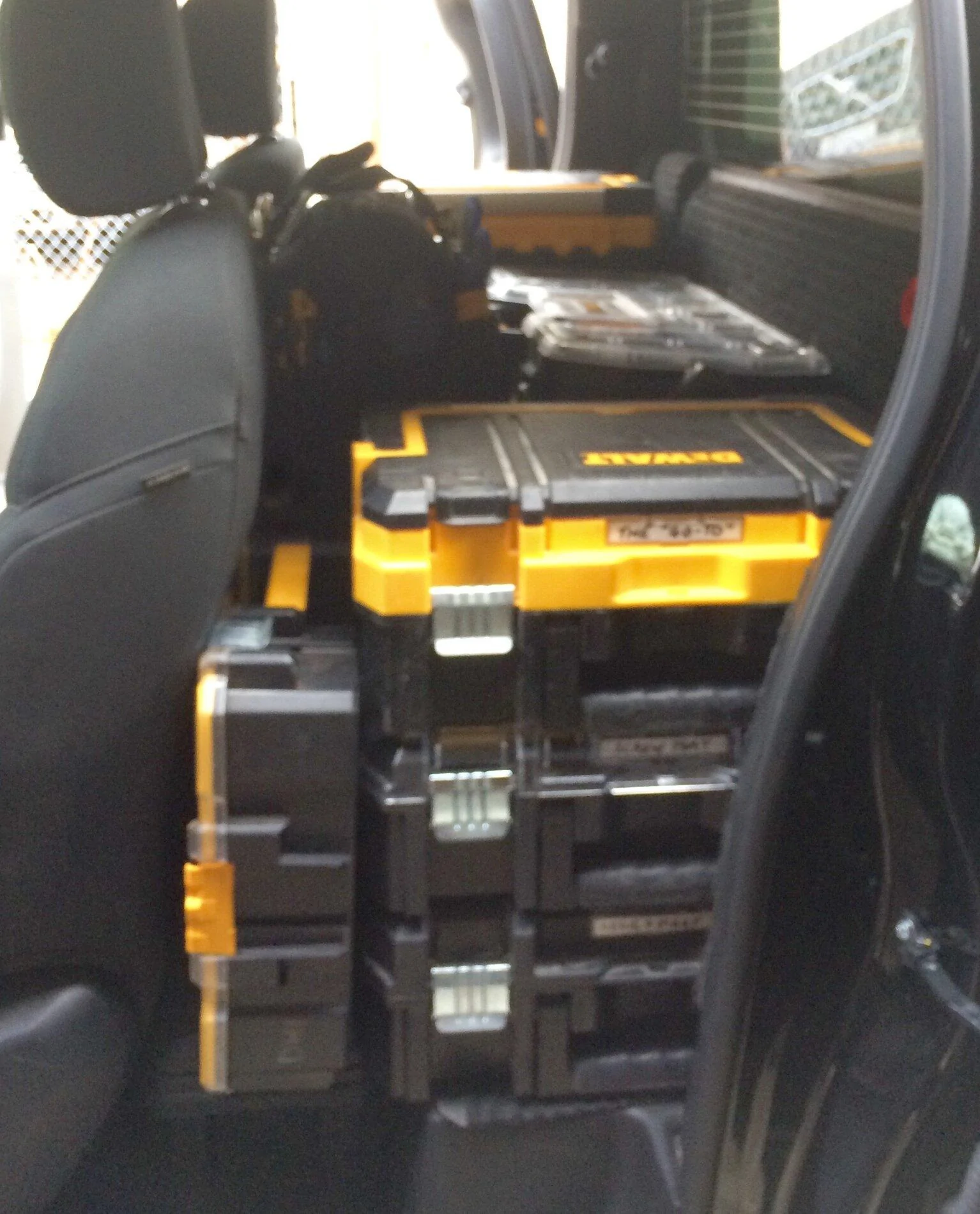

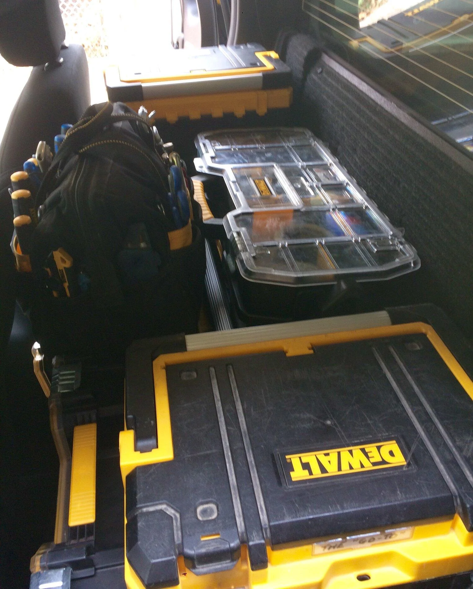

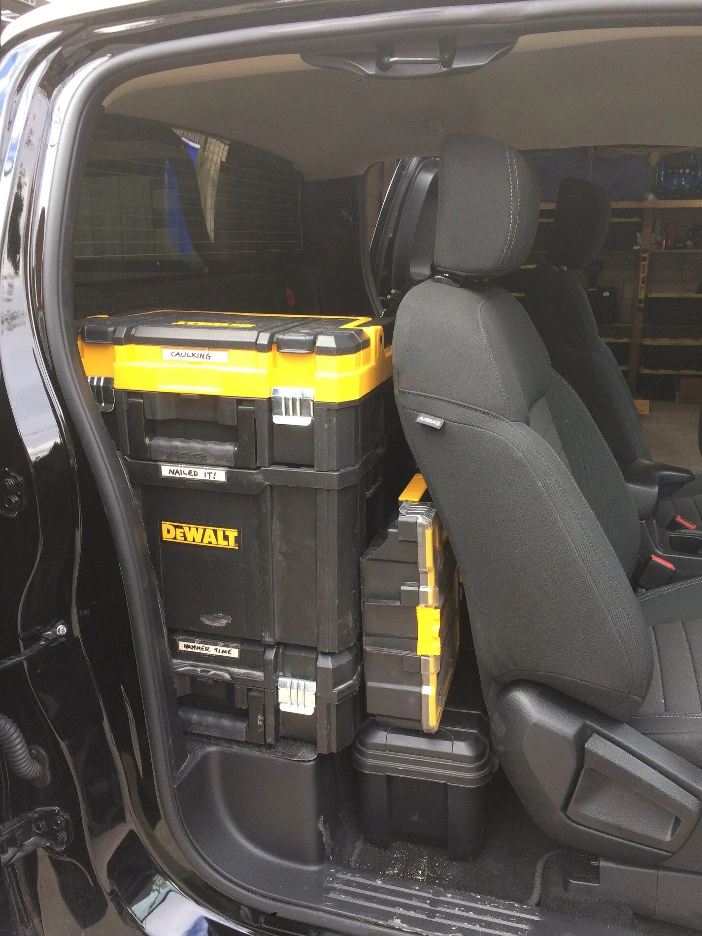

That’s a great mod - I love it - i did my own rear seat delete in my SuperCab with the same goal in mind; be able to easily return it to factory condition while only using existing mounting points. Full marks for pulling this off. Bonus points for doing an exceptional job and including molle panels.
Cheers to you!
But, I gotta know.....why? I’m a contractor and I needed room for tool cases. What‘s your motivation - what’s going back there?

Thanks! I am also a contractor, roofing to be specific. I use my back seat area like a small van. Plus, my trucks tend to be the family truckster, if you will, and the flat floor is awesome for the dogs.
