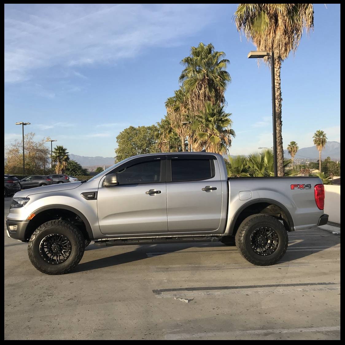

You’re right Rob, but that’s with stock wheels and their +55mm offset. Some have gotten away with slightly lower offset, but @the5Gmartian is running 0mm offset wheels.
ah, got it. I didn’t catch the offset spec. Thx

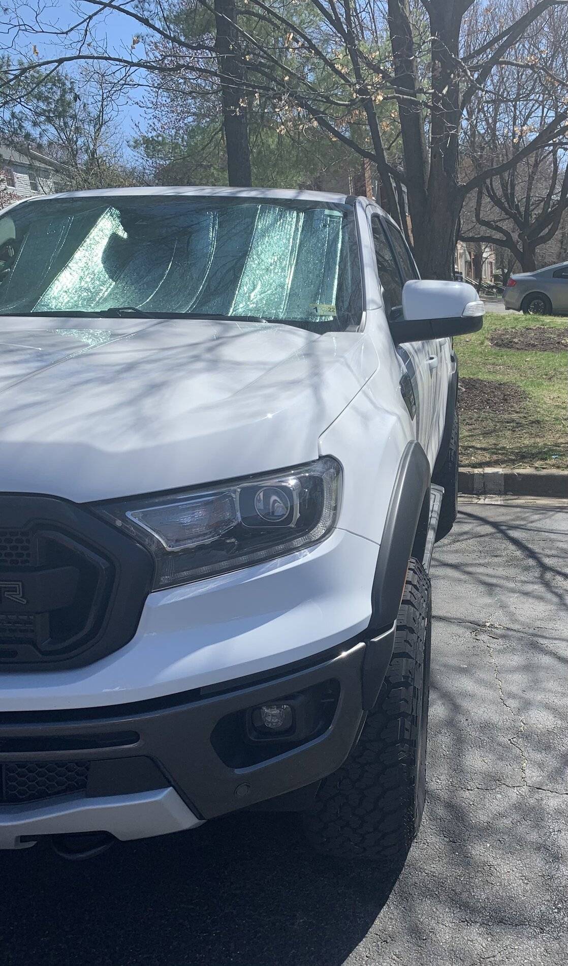

You need poke to match the flares though lol
I totally get it - if you don’t have sufficient poke, RTR is likely to come over and take back that wicked grille. ?

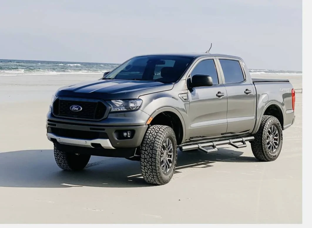

I have 265/70/17 Nitto Ridge Grapplers with the stock wheels and a 2.5" level. There's no rubbing issues and you don't have to modify the crash bars. The Nittos are much better than the stock tires and very aggressive but still very quiet on the road with zero road noise.
I appreciate the feedback man, after seeing your setup I think you’re right. I’m just going to hold off on the rims for another 30k miles when I’ll need new tires n just get some 265/70/17 KO2’s and maybe some fender flares in the meantime… & spacers if needed.
