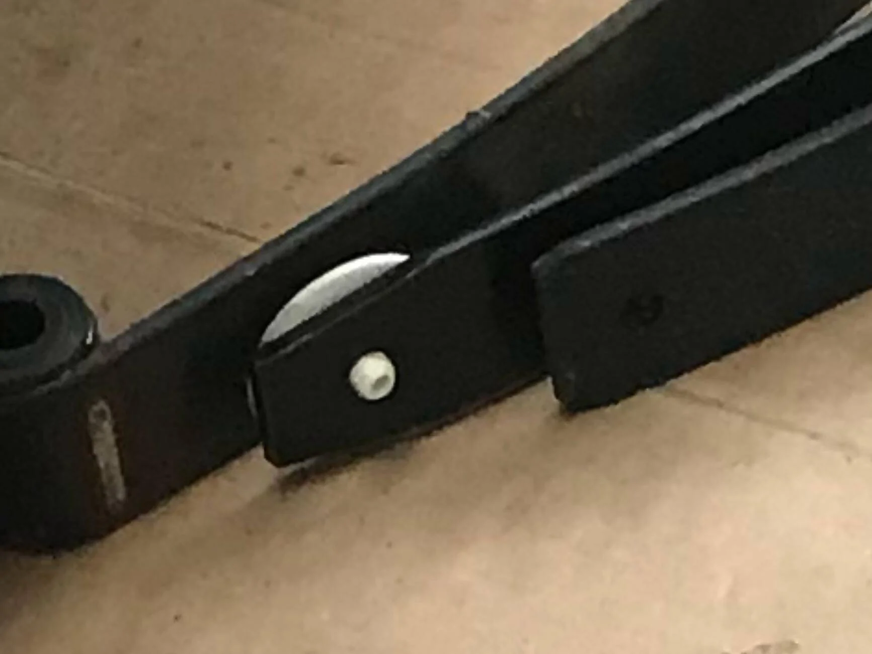

I pulled the springs back out and drilled a hole in the spring that did not come with a cushion. I used spring cushions for a F150..
worked out great and no more noise from them. I tried putting grease under the spring but only lasted a week..

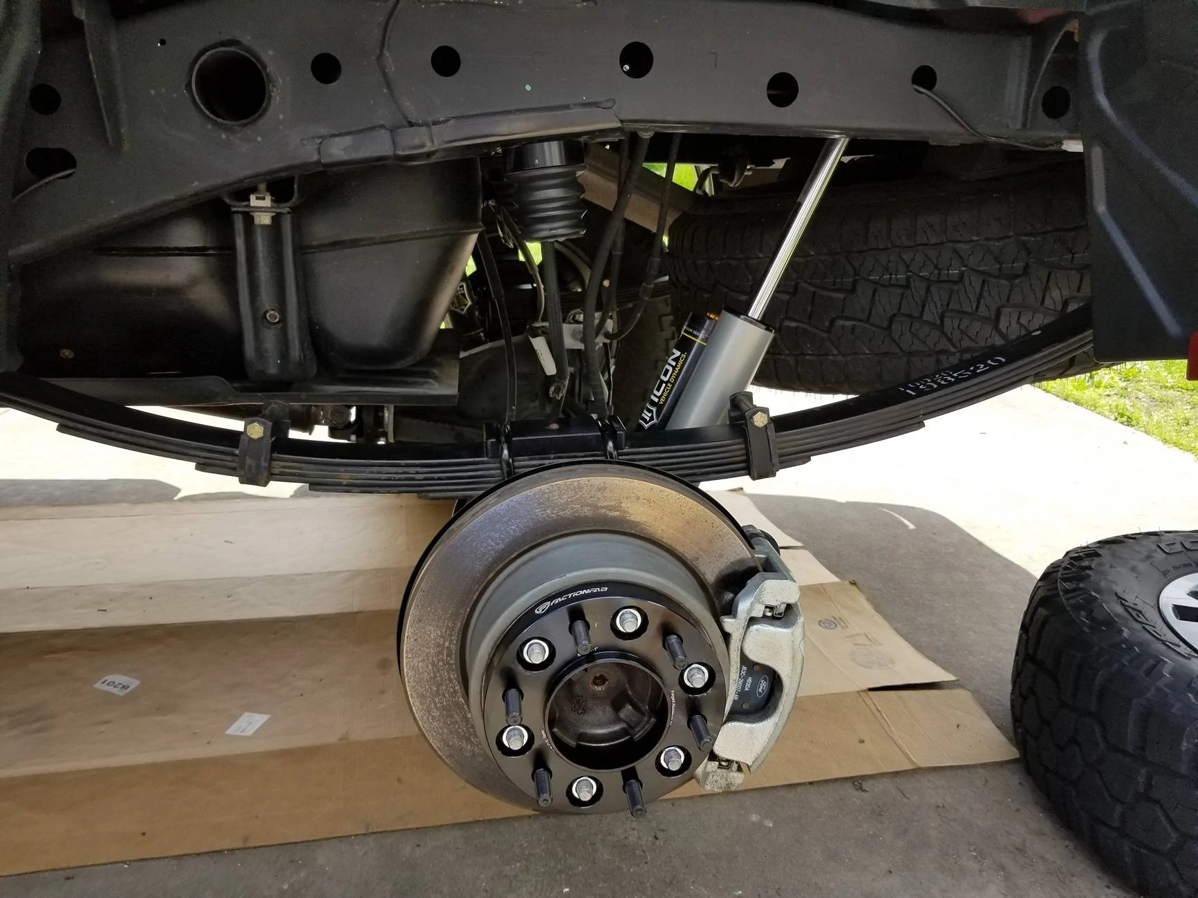

I have had mine on for almost 15k hard off road miles and there is no issue with squeaking. Fully loaded truck with a lot of weight on the back end. Also have the Fox 2.5 shocks maybe that helps? If I remember correctly there was cushions between all the leafs.

The spring just under the main leaf didn’t have any on mine. You must have gotten the only pair with the cushion as all complain about the noise.

No peeps no squeaks, no cushions between leaves....l gave the end bushings a shot of 3-n-1 Oil dry lube and torqued everything to spec.....3 years now ...1st batch Stage 3motorsports got from ICON.
Running them with the 2.5 ICON shocks...

Do not know what to tell you I am traveling and not with my truck right now so cannot double check. As I said I if I timber correctly they all had cushions. All I know is they are quiet. Only thought I have is to make sure final torque is done with full weight on suspension. I loaded bed with extra weight and had my overland rack and tent mounted. I know it was hard to get U Bolts torqued final was I think 180ft lbs. I think it was done in four steps slowly increasing each time and sequencing the order. Took me and my son both on torque wrench for final setting.
