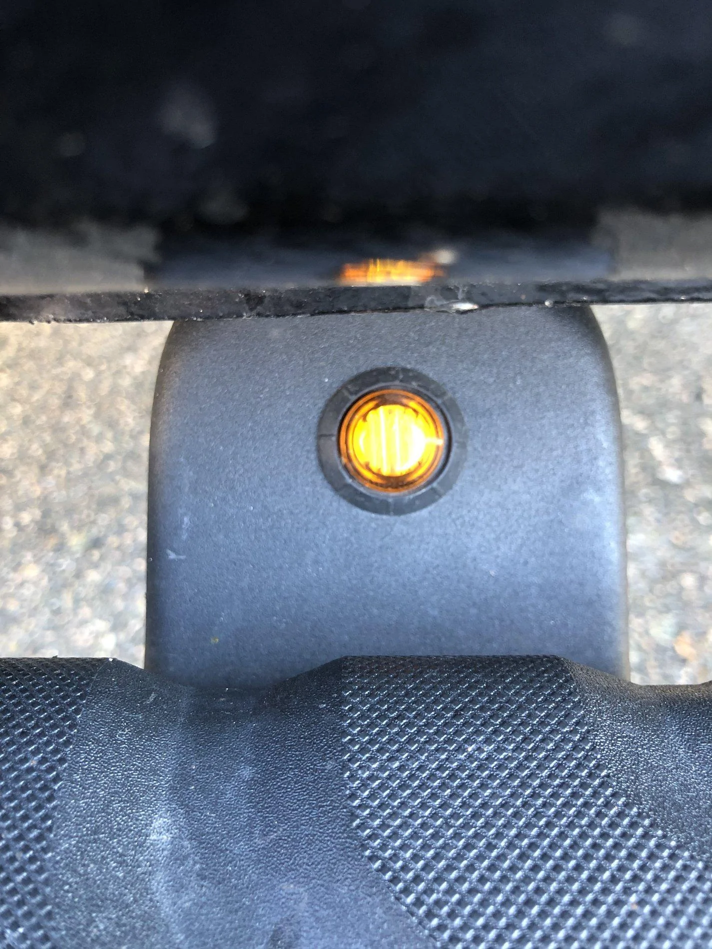

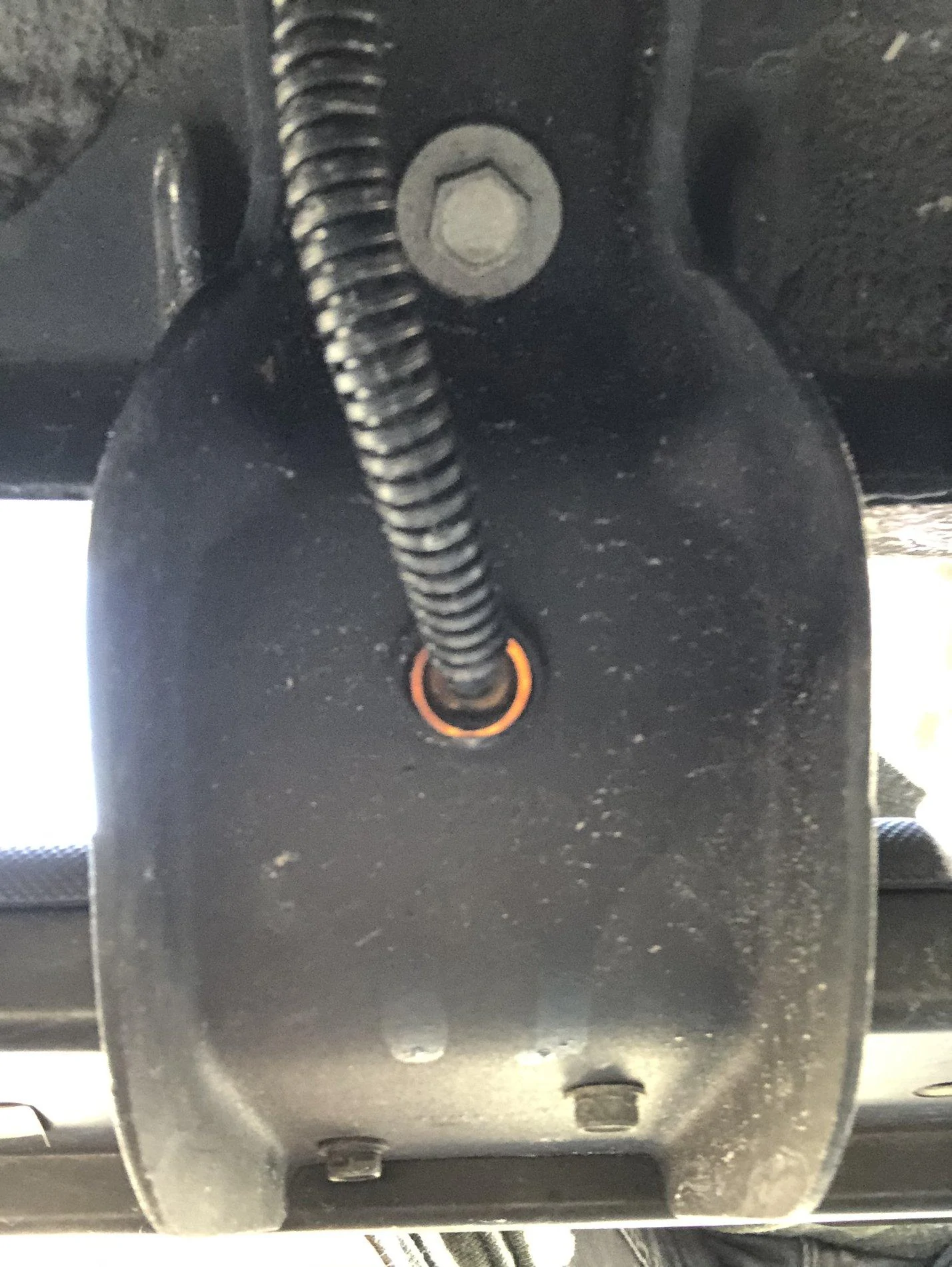

Yes, drilled holes in them. Then repainted so no future rusting.
Any time you drill holes into support structures or frames, you weaken its engineered integrity. Just keep an eye on it for rust and bending. It looks great though.

Yeah, I had the same concern. I'm not sure how wide those arms are, but once you drill a hole through them, especially one that large, you substantially reduce the strength and stiffness. I'm sure you won't have problems with regular stepping use. But the max load they can take has certainly been reduced. Just something to keep in mind.

I thought the same thing and do not plan to drill a large hole like that ¾" in the support brackets, so even though I have them ordered...until I figure out another way to mount the lights they will sit and collect dust in the shop.

Obviously it’s up to your discretion but I felt a hole that size, based on the width of each mount wouldn't make much of a difference. After all was said and done, I see no difference. I can stand on the rail and bounce up and down without any issues. At the end of the day, I see the step rails as cosmetic anyways, I'm 6 feet tall and don't ever need them to get in and out of the truck. Occasionally my wife and kids will step on them but their weight surely won't be a factor.

Not necessarily the initial weight you should be concerned about, but the eventual wear and tear, weathering and expansion vs contraction that occurs with metal in different temperatures. You may never see the hairline cracks but usually its sudden when it finally gives way.

I believe you are over thinking it a little. The "ribs" are taking the brunt of the applied weight as it is shaped like a C channel and even bent to add more rigidity. The bracket has not been weakened unless it was not corrosion protected. I am not an engineer, but I did sleep at a Holiday Inn one time! :giggle:

After looking at my brackets, I am in agreement that Jeff did not weaken the brackets at all..they are very robust and a ¾" hole will have minimal effect on the load carrying of these brackets. When I receive mine I will have no worry on drilling these holes in the brackets.

Well, as an engineer who basically does this kind of analysis for a living, I can tell you that there will definitely be a reduction in strength. But as @P. A. Schilke noted, the arm is much wider than I thought. So it will reduce the strength, just not be as much as I had originally thought. OP should be fine for normal and even slight abusive loads for the duration of the trucks life.

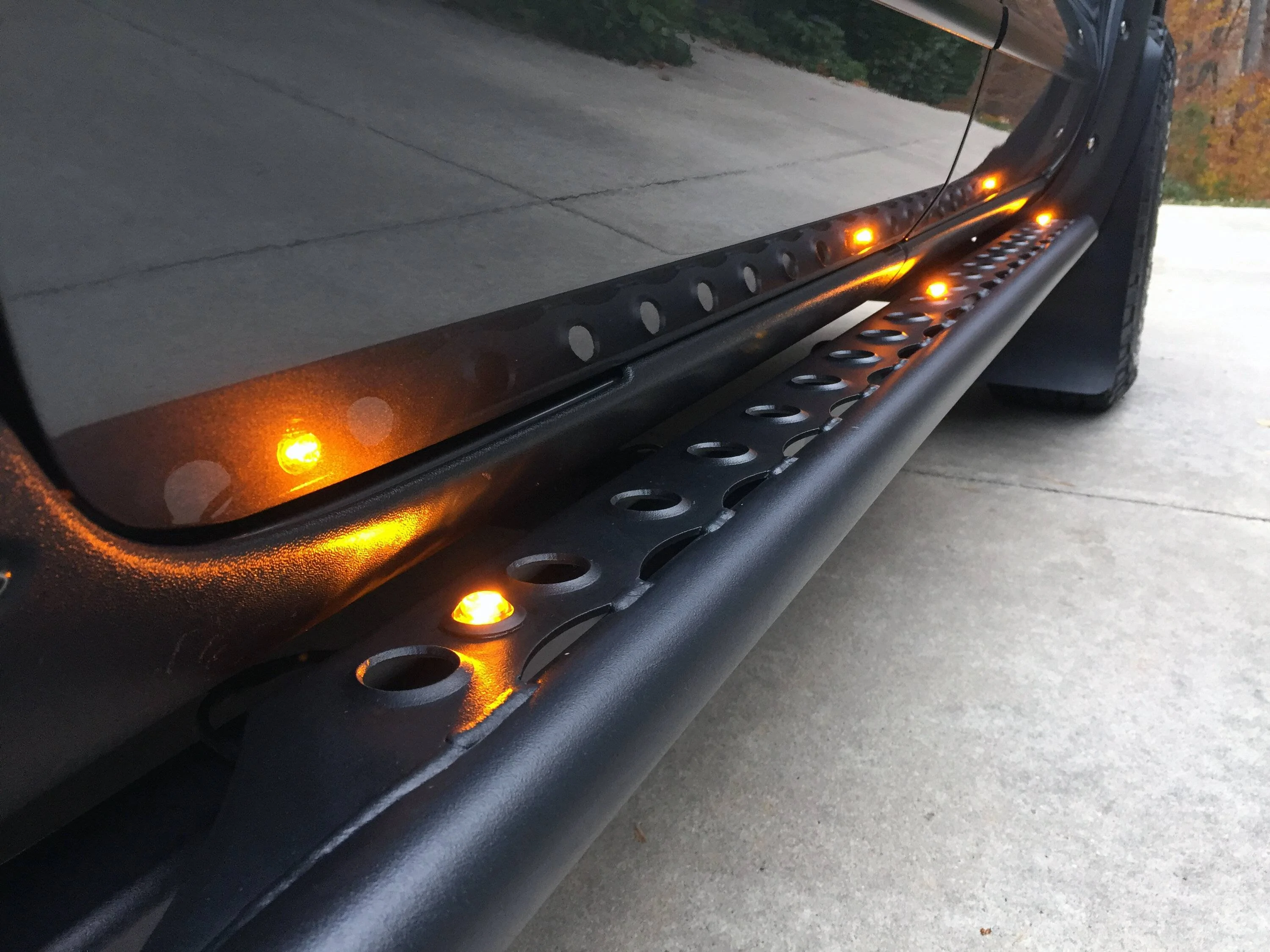

Nice job...here's mine on sliders...adds that extra margin of safety at intersections...
