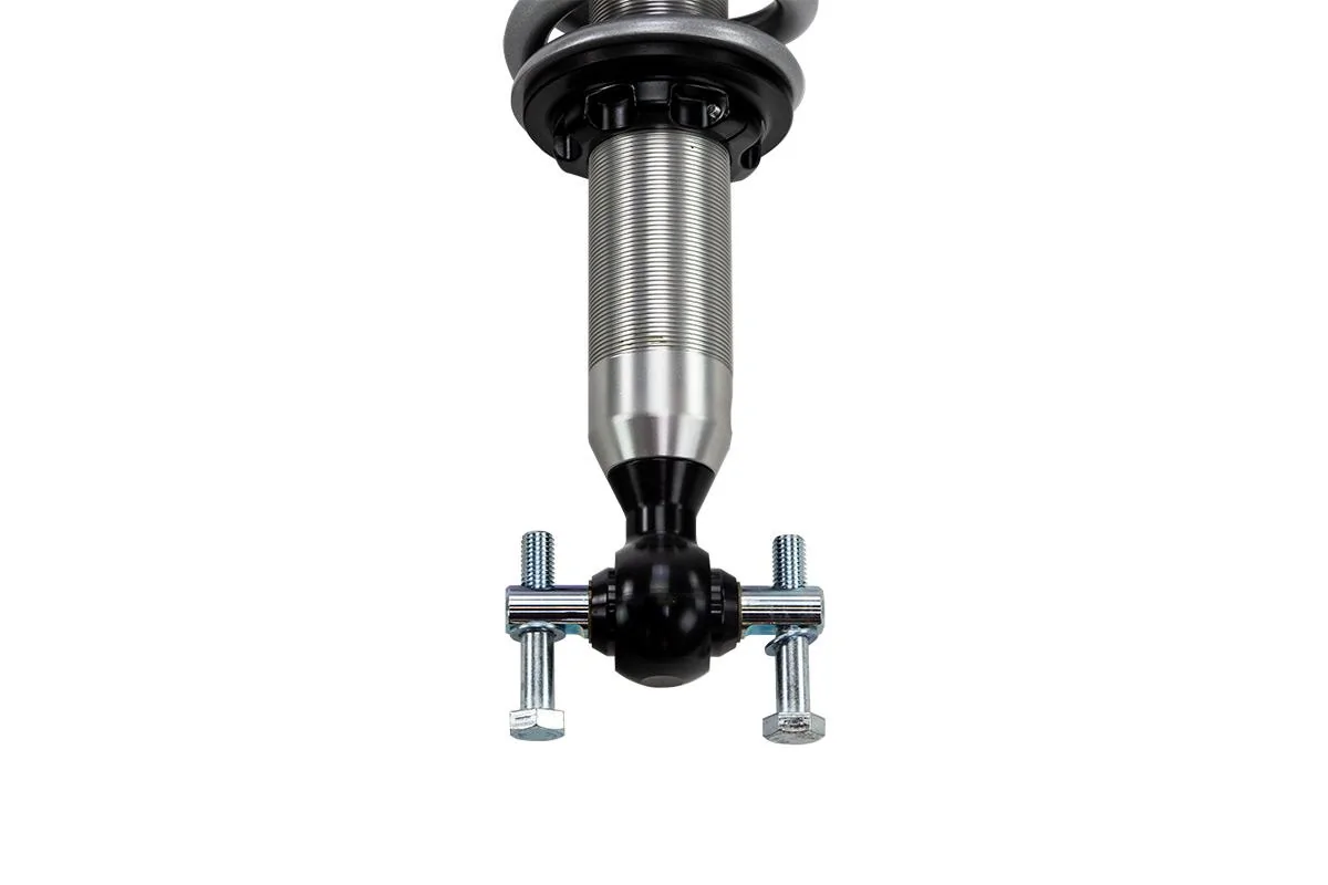

Looks like the ride height adjustment on the Fox 2.0 is via threaded collars, or am I missing something? That way you could raise and lower at will just have to make sure they are the same.

They do use an adjustment collar. However, that collar is at the bottom of the coilover and is under spring tension. To adjust the coilovers' ride height (either up or down), you need to compress the spring, loosen the collar's retaining screw, and then turn the collar accordingly by hand.
You can see it here at the op of this image:

Thanks. Looks just like my motorcycles albeit a larger spring. With them you just turn the collar, no need to relieve spring pressure. So do they provide guidance on how to set different ride heights? I know the ratio isn't 1:1 (1" longer/shorter = 1" lift/drop), does anyone know what it is?

Talked to Fox, and they said that it's roughly a 2:1 ratio between the coilover thread and the ride height of the truck. The coilovers usually come out of the box set at 2.5" of ride height, so to get down to about 1"-ish of height, you'd drop the bottom collar by 3/4" of an inch.
