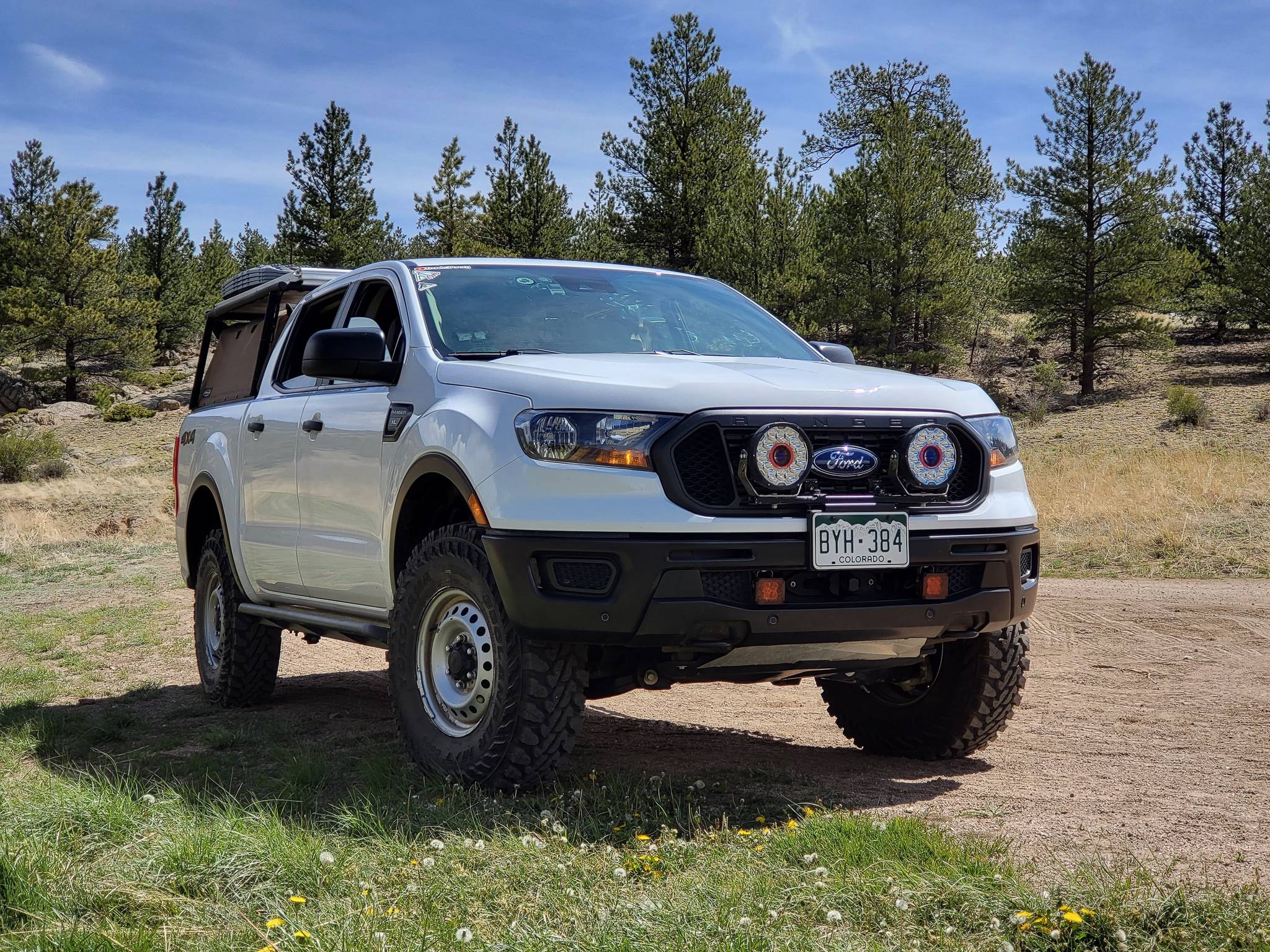

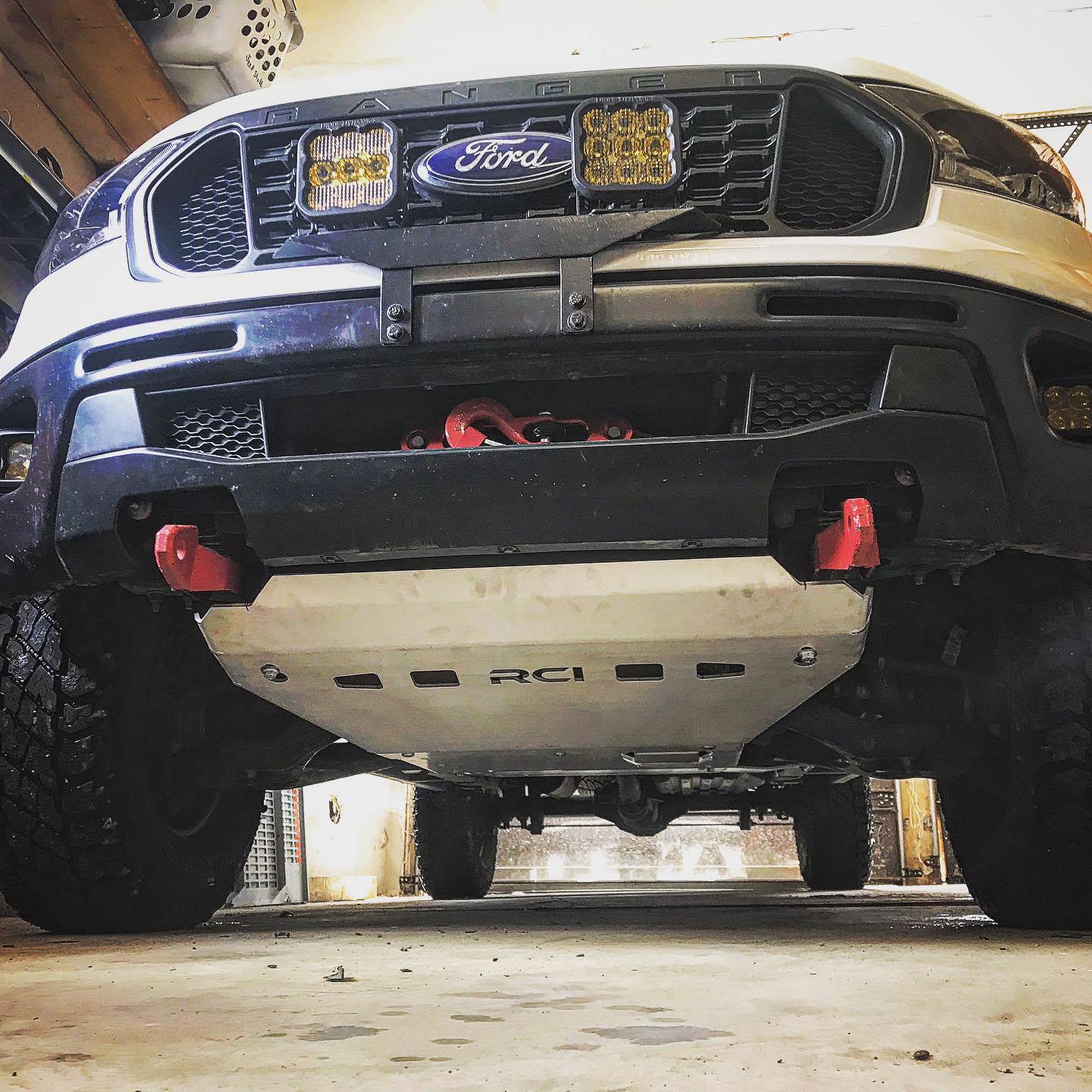

@RoadBoss fab'd spotlight mount
@Shane008 fab'd spotlight mount

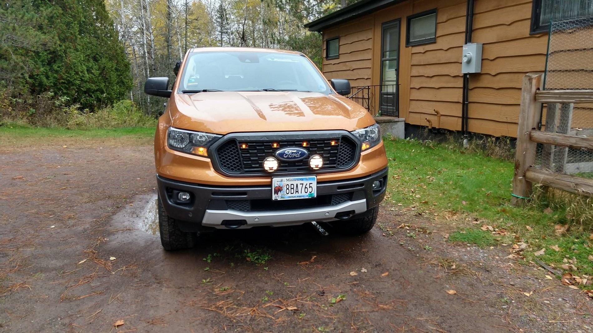

some place around here i have pictures with my older setup on the front bumper lights. no drill no damages. if i find it i will post one.

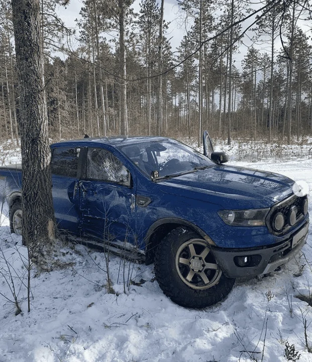

Found this one too! pretty intresting since i have 4 KC slimlights sitting in my garage :cool: any ideas how to achieve this mount?

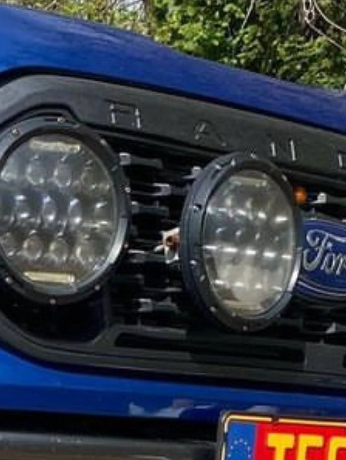

If you zoom in you can kinda see what they did with the xlt grill.

Looks kinda like they sandwiched the grill with a bracket? Seems like it was sturdy enough if the truck got crunched that bad and the lights didn’t break the plastic off the grill. Or maybe they made a bracket behind the grill that is more structural.

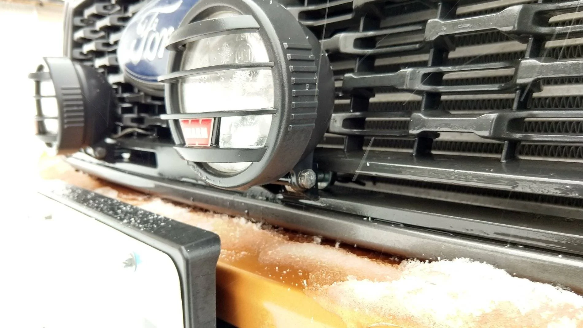

I found this on the forum from a deleted user. I gave it a shot with some hardware i had laying around on my bench but my inside washer is too small. However i dont think this is the right solution for my KC lights, they seem to be heavier than the Warn lights pictured and im not sure i have confidence the plastic grill will hold up to highspeed vibrations with the wight hanging off it.
