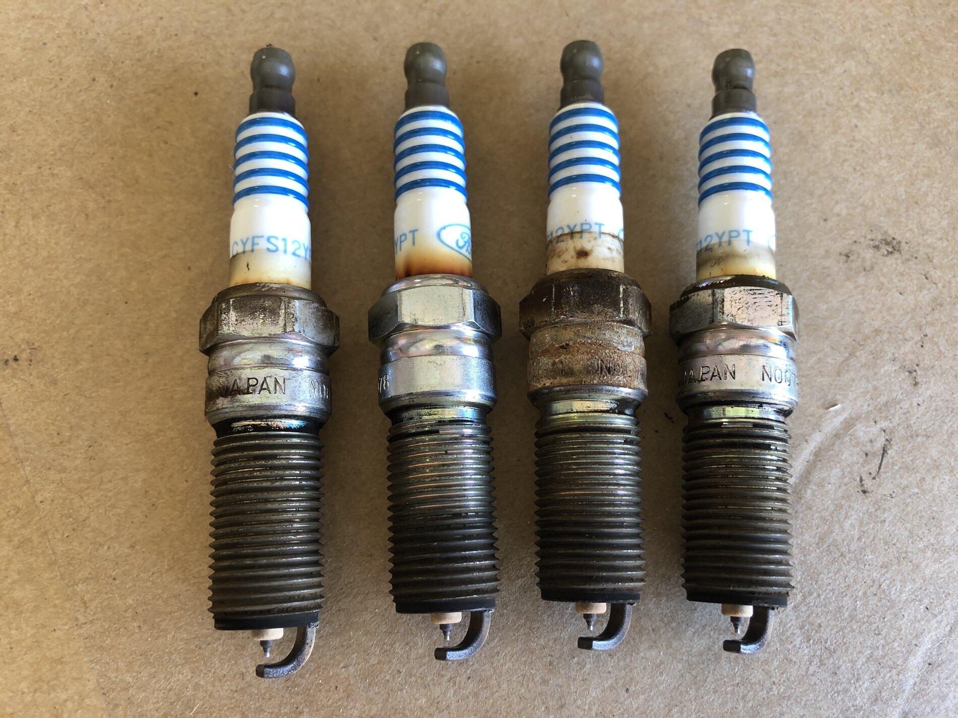

Okay, so I was assuming my truck had the sp542(one step colder plugs) based on other EB platforms and what @tjanok found above. However, my truck indeed had sp578 (CYFS12YPT) in it. Picture below, they donā€™t look great after 24.9k miles but 19k of those have been while running the 93 performance tune. I installed the sp542 one step colder plugs (ford performance part number above) and I can say with certainty that the truck runs and idles more smoothly. Iā€™m glad I changed them out for sure.
So the colder plugs are part # Ford Performance M-12405-35T? Itā€™s not me itā€™s the Jack Daniels.

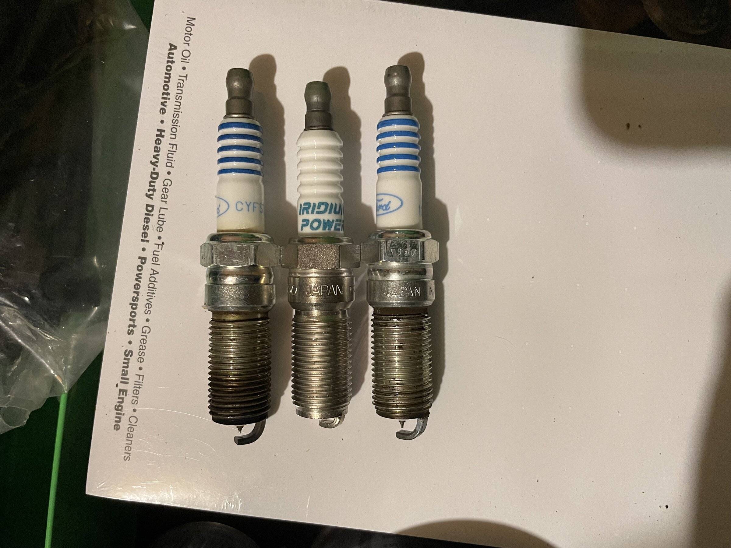

The M-12405-20T is a plug manufactured by Denso (P#ITV24) used by Ford Performance in some of their performance packages. (This was immediately obvious after opening the package).
There are some subtle differences in the sizing of the plug which you can see in the pic and they are pre-gapped to .028(confirmed); but the plug body (seat to tip) is the same so I decided to give it a try.

>>>>> Plug Pic Left to Right: (Stock) SP578, Denso ITV24{Ford M-12405-20T}, OEM Rplmnt SP594
