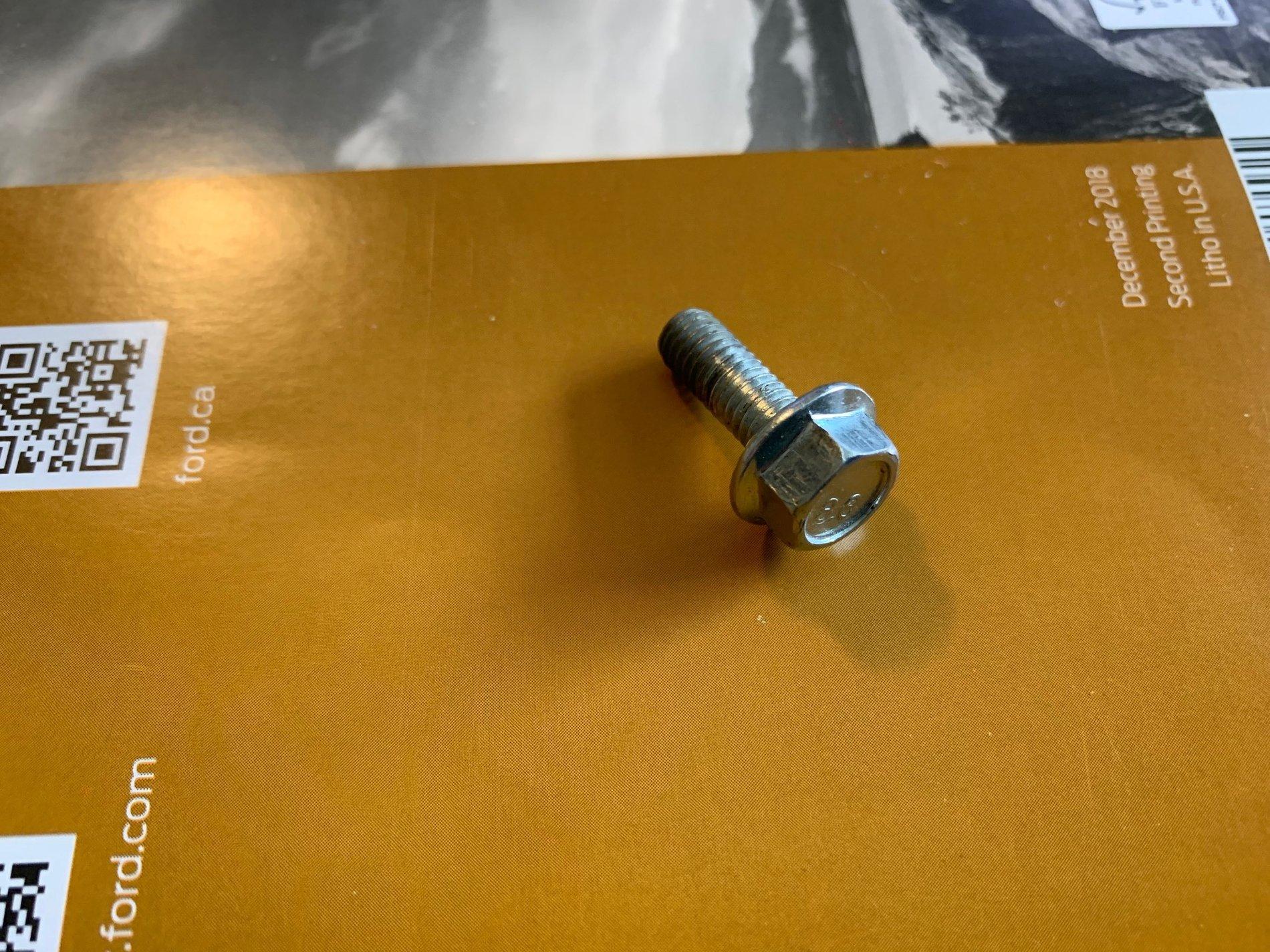

I used 2, 6x16 mm stainless washer head bolts. Worked fine and Dealer charged me 33.00 for the cover.

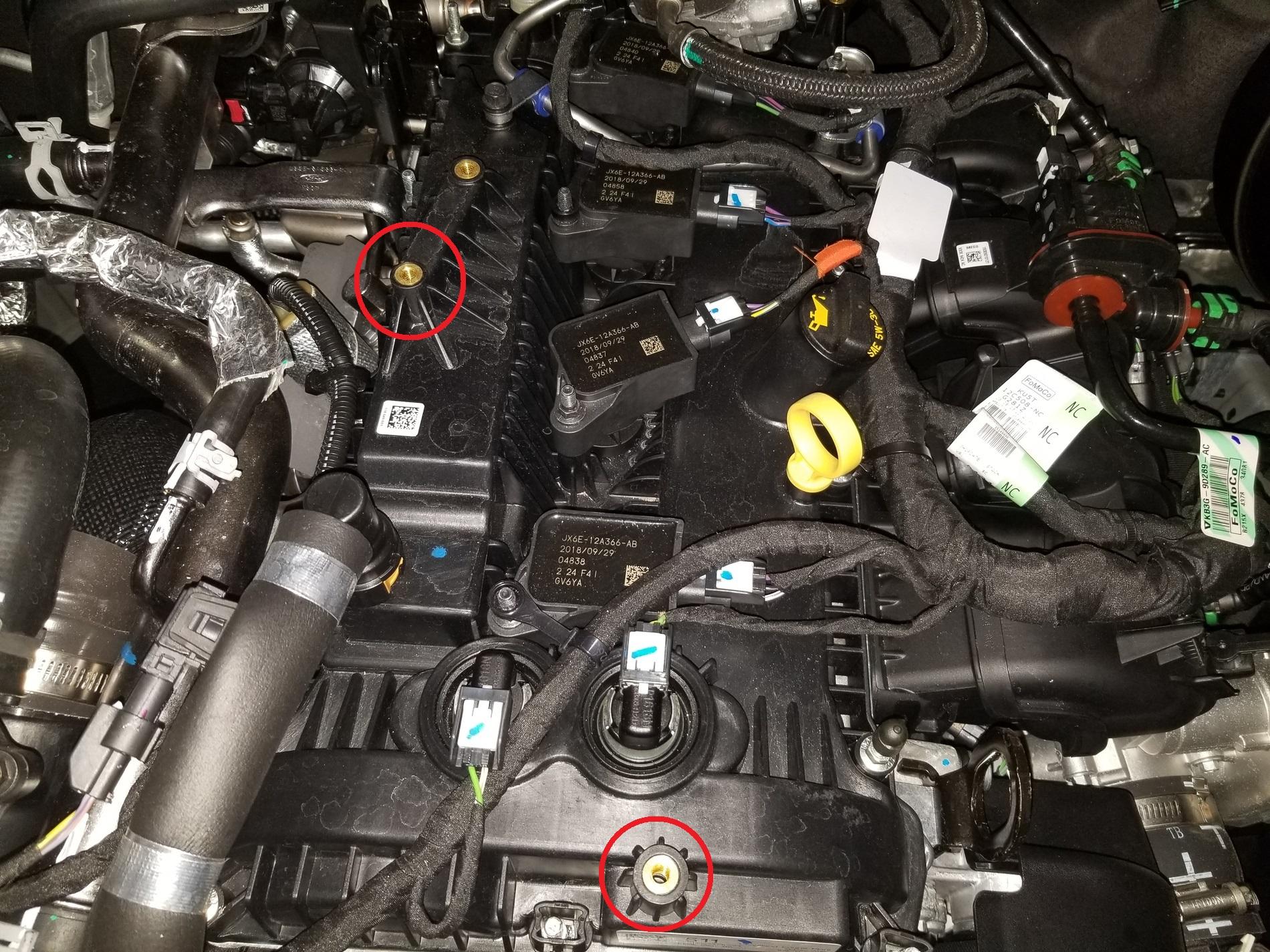

Did you install with 2 bolts? I see 3 areas with threaded attachments.

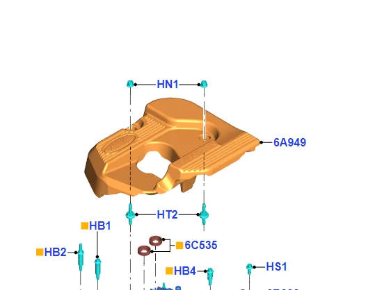

Check out the parts diagram I posted:
Looks like the diagram got upgraded:

Also, I thought 3 bolts were needed because in the pic, there are 3 threaded areas where I thought the cover attaches. One in front and two on the left. Only one on the left is used.
I called to only order two bolts and was told the bolts only come in 4 packs. I canceled the bolt part of the order and will buy bolts at Lowes or HD.

I believe it's these two:

Having not seen the cover close up, it does look like 2 bolts are needed. I wonder what the 3rd threaded area is for.

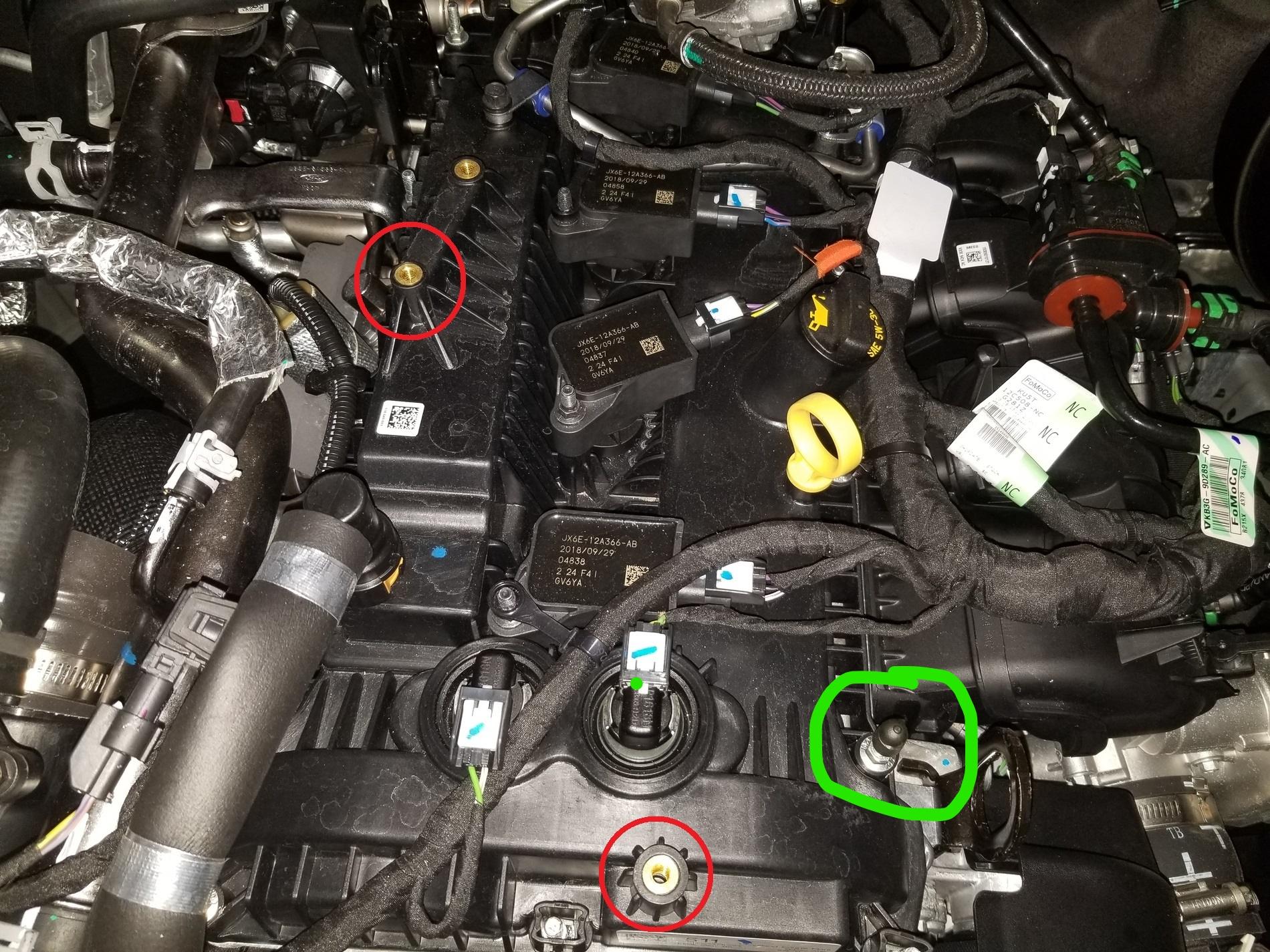

Uses the 2 you highlighted and snaps on this stud.

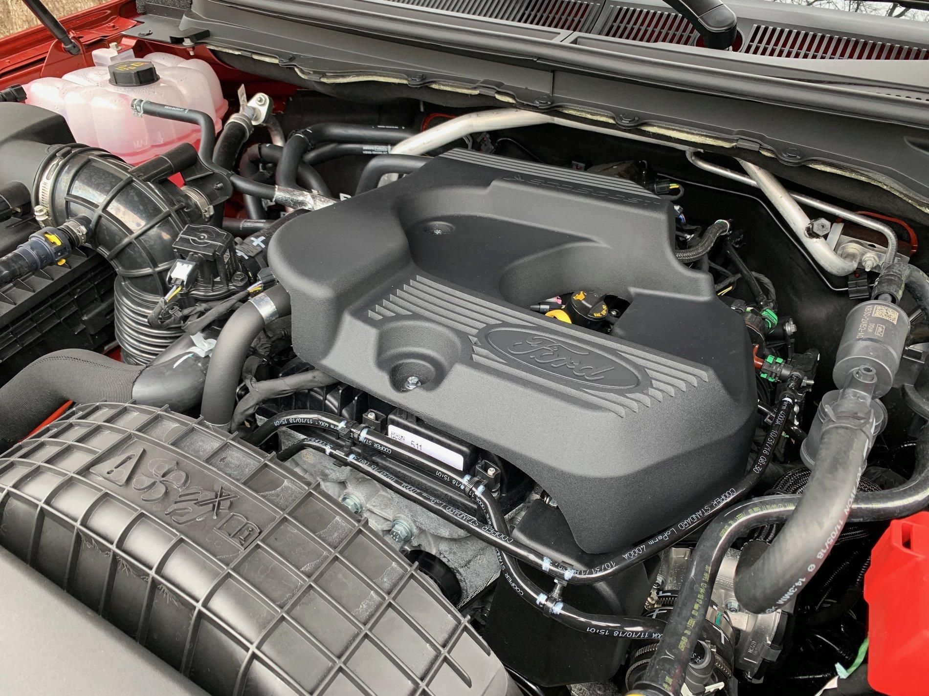

Installed the cover. Looks great and I believe engine sound drops a bit.

I forgot to order the bolts and the part came in today. I am going to try to look for the bolts Strokerduster posted here. Where did you buy yours Strokerduster?
