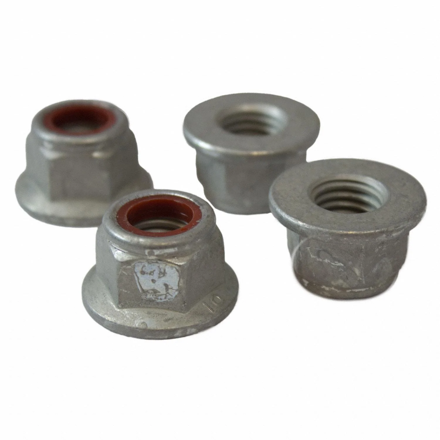

There are a few threads on here that talk about the nuts on our front suspension components and the “need” to replace, rather than reuse them. Of course, some of the comments are from well-known members who typically provide good insights and advice and it all comes from a good place - safety.
There are a lot of “Ford recommends...”, “you should always replace...”, any good shop knows not to reuse...”, “level kit makers are now including new nuts...” type of comments. The 35mm axle nut replacement certainly isn’t Nyloc but folks have mentioned that Ford says to discard them.
I mean, - what’s a guy to think, right?
Anyway, I remember there being reddish rings on the top portions of the nuts I replaced. I’ve included a picture from the Ford parts site below for your thoughts on these. Maybe they’re not Nylocs and some of the members, especially me, are making incorrect assumptions. These types of nuts are used on the tie-rod end, upper pall joint, strut top mount studs, and bottom strut studs.
Have a look - to the untrained eye, they look like Nylocs but are they?

I’ve seen these more recently. It’s not a nylon insert. Looks to be UHMW material and if it is would be 10X stronger than nylon and won’t deteriorate the same way or become brittle with age. Also has the benefit of acting like a seal as a moisture barrier. They will cost more too!
Hi Duke,
There appears to be a seal more than a locking feature to me. I was looking for some local deformation in the threaded area that locally deforms the thread inside and is the locking mechanism. These are called UBS Flange nuts...UBS is Uniform Bearing Surface....
Is there an adhesive patch on the stud? If not I think loc tite would work well to reuse.
I can see where the axle nuts are torque to yeild and thus best to use new in that application. World of fasteners is changing from my 18 years away from Ford... Steve M is still there, but he must be close to retirement age now....wish I could get a hold of him....
Thanks Rick - great feedback.
UHMW (Ultra High Molecular Weight) Polyethylene
UBS (Uniform Bearing Surface)
It’s hard to keep up with you Engineers.

Thanks so much Phil - I can see how a layperson would make the Nyloc assumption and I’m glad you saw my reply to the OP’s (@Hardy12000) thread.
After seeing replies from you and @Trigganometry as well as doing a little reading, I’ve learned something new.
I stand corrected, but more importantly, informed.
