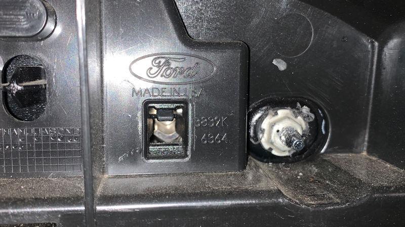

2 screws. Whole rear should take no more than 10-15 mins imho.
Front, some say you have to remove grill. Not really. Depends how big your arm is and flexible. You have to take top shrouds off and worse case, take top 2 grill bolts out to give you a little more wiggle room. Forget the nut sizes but a small deep socket should get you in. Cheap nuts on plastic posts. Don't strip them. Thought I had a better shot but thats one of them.

Yes and no. Yes you have to remove most of the front grill to get at the two bolts in behind. But no you do not go through the access panel on the back of the tailgate. For the tailgate nameplate just use two plastic prybar tools and slowly work in between and it fairly easily pops off.
There's actually a notch on the underside that will accept a small flat blade screwdriver. I saw it AFTER I removed the badge my way :)

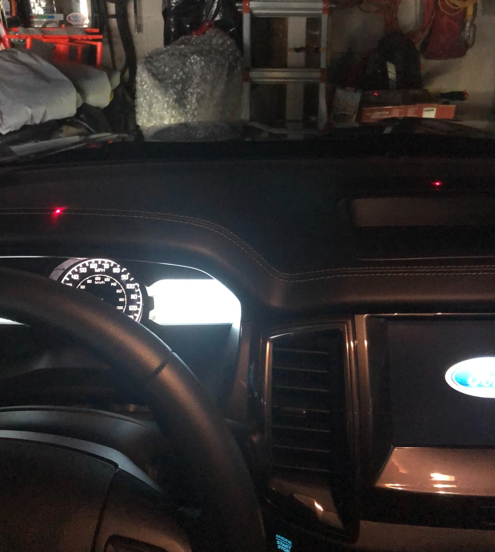

Thanks for posting this, I picked one up for myself and so far I love it. I pointed both lasers at my truck and was thinking about picking another one up for my Mustang or maybe ill share a laser with it down the road :).
I think the 2nd one should aim at the center of the front passenger seat, just don't share that info with the passenger until you pull in and the laser becomes a designator ??
