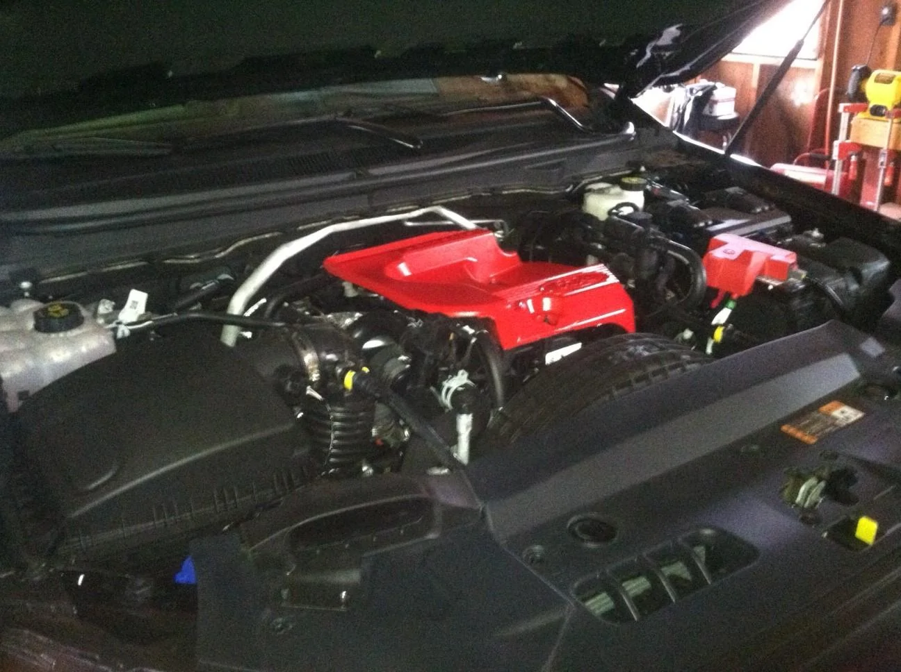

DIY Fix for missing XL and XLT Engine Shroud Cover.
Known issue - Engine Shroud Cover Is Not Available on XL and XLT Trims, Only Lariats.:angry:
This cover was not put on the Ford Ranger only for aesthetics but to also muffle the injector/solenoid noise only on the Lariats engine. I just ordered all the parts and had it put it back on the engine and the engine noise was greatly reduced on my XL trim model. The parts cost was ~ $73 (cover and included nuts, washers and studs) - This cost is ridiculous but since it was taken off the lower trim models, probably to save $$$, it's well worth it to put the cover back on the Ranger by the dealer or yourself. IMHO ;)

Is this easy to put on?
The cover has only two nuts and two washers with the threaded studs mounted in two of the engine threaded holes - yes it's easy. See other parts of this topic - section 1.;)

Rustoleum Acrylic enamel, several very light coats with lots of dry time in between. 3 weeks later it is holding up perfectly. Did not paint the underside. Probably not enough heat up that high to affect it.

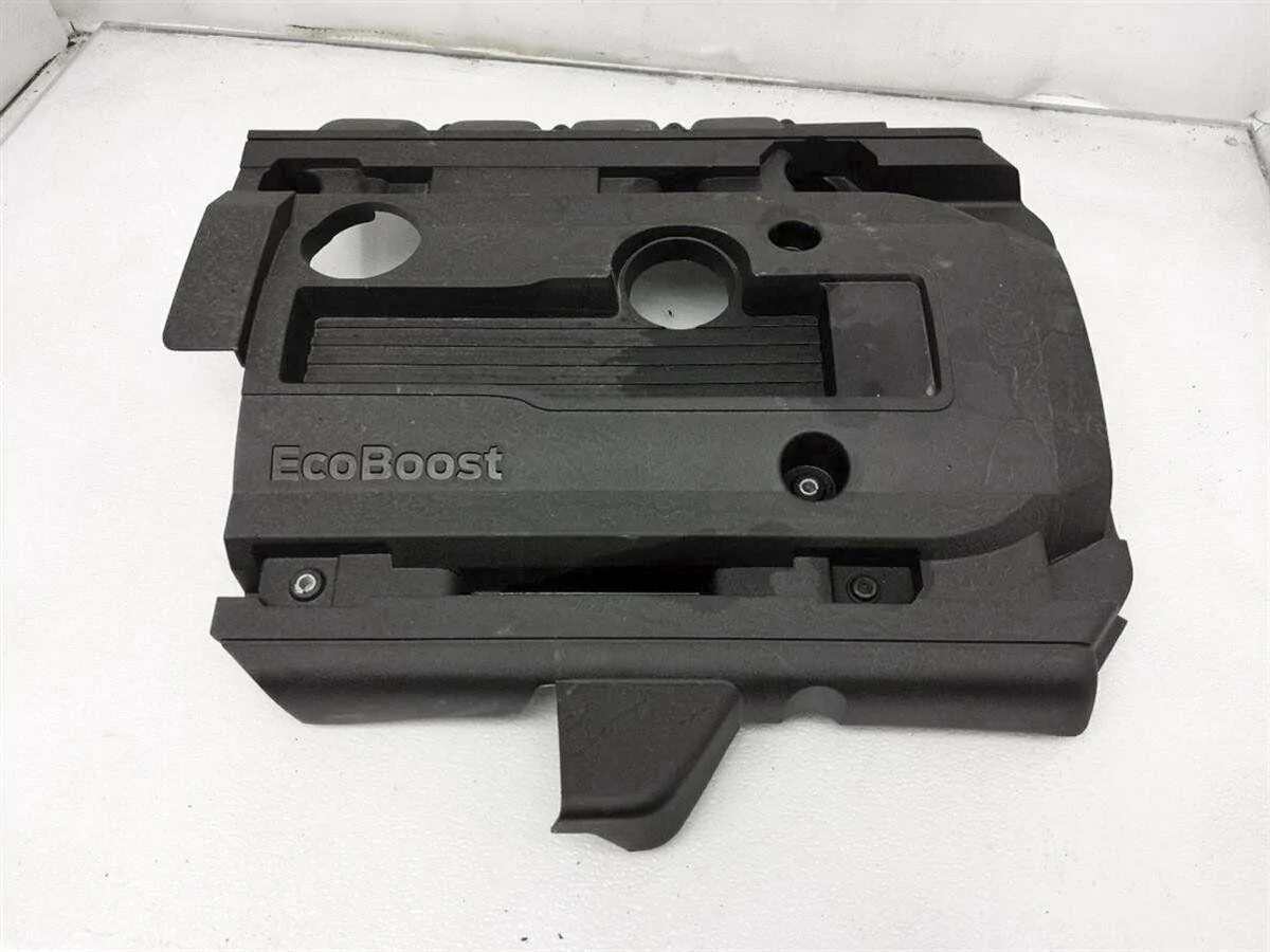

This Mustang cover on eBay from a 2018 looks different. Has anyone installed one on their Ranger? G.B.
