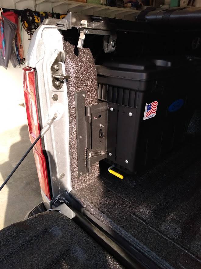

How do you like the swing case? Thinking about getting one with my ford pass points
I like the case. Can't keep real heavy stuff in it, but it's good for stuff like jumper cables, tie-downs, cleaning stuff, some quick to get too tools.
It's made by another company for Ford, and they sell on Amazon for under 200 bucks, while the Ford branded sells for more. I used my Ford points to get it, but I asked the dealer if he would match the lowest on line price from other dealers, $199.00 and he did....so ask your dealer to match.
The company that makes them is called Undercover Swing Case, and are exactly the same as the Ford unit, without the Ford logo. There on Amazon for $199.00, free shipping with Prime.

Same here. Used my points and they didn't exactly match on-line price, but they came down to like $210 so it was fine, so I paid 10 bucks out of pocket. I have my drop hitch in it, a regular hitch, some ratchet straps (rat shit straps) jumper cables and some tools, so it will handle a bit of weight, but I'm probably at the limit.

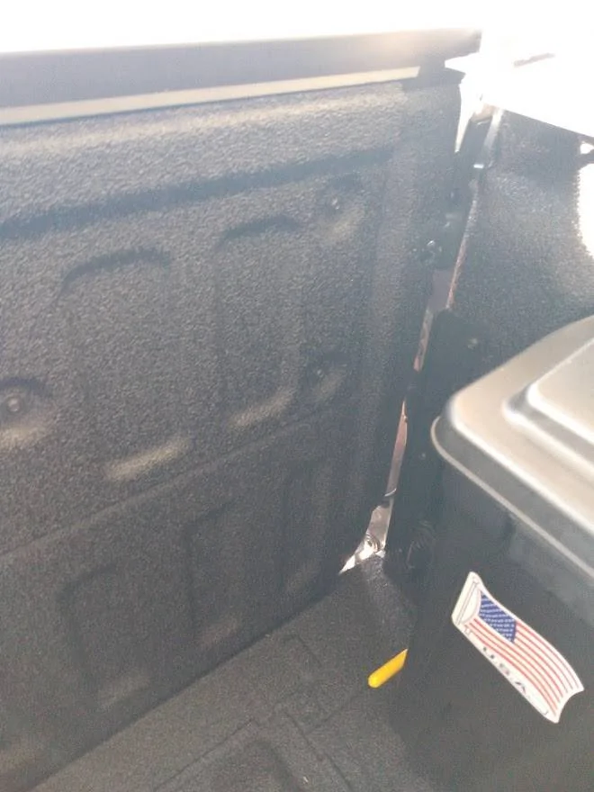

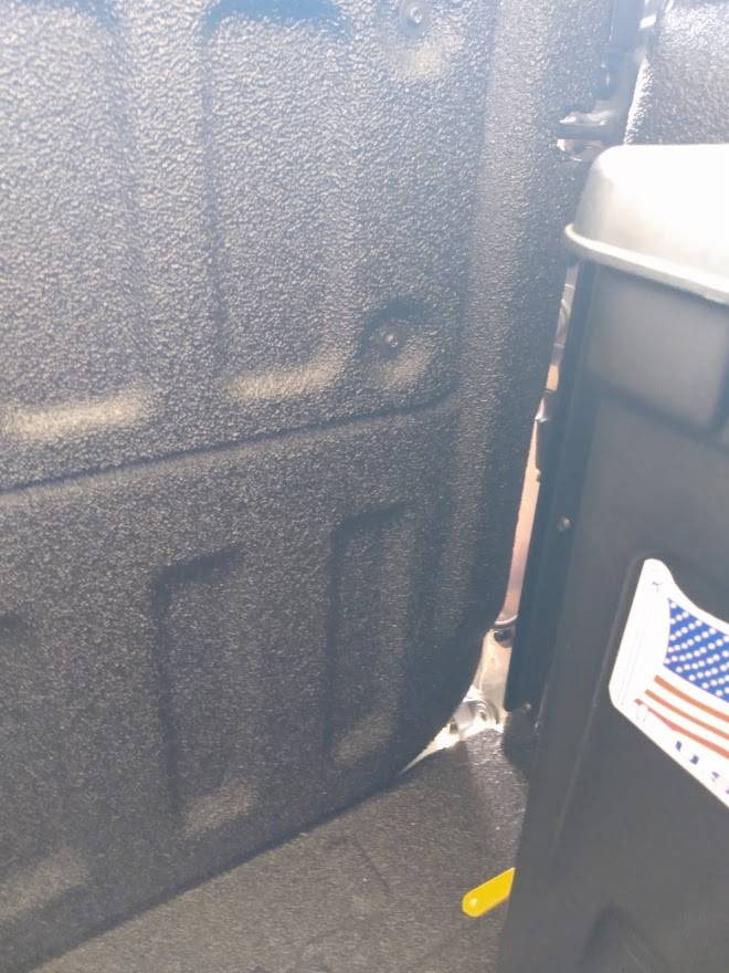

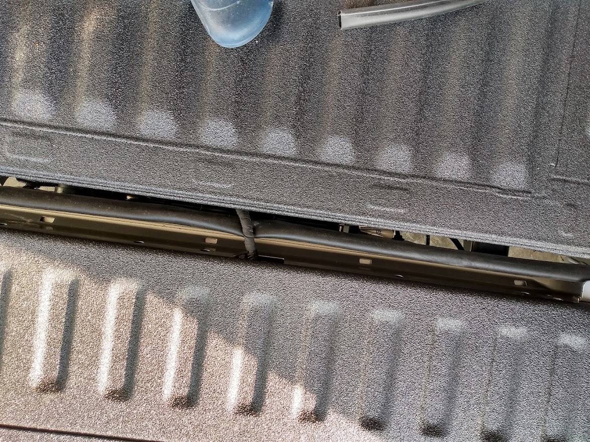

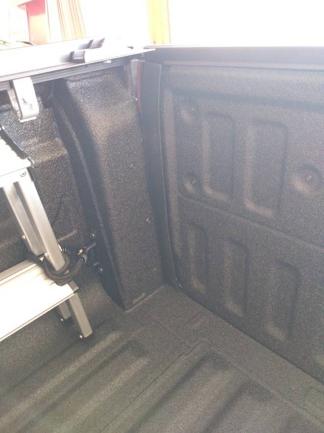

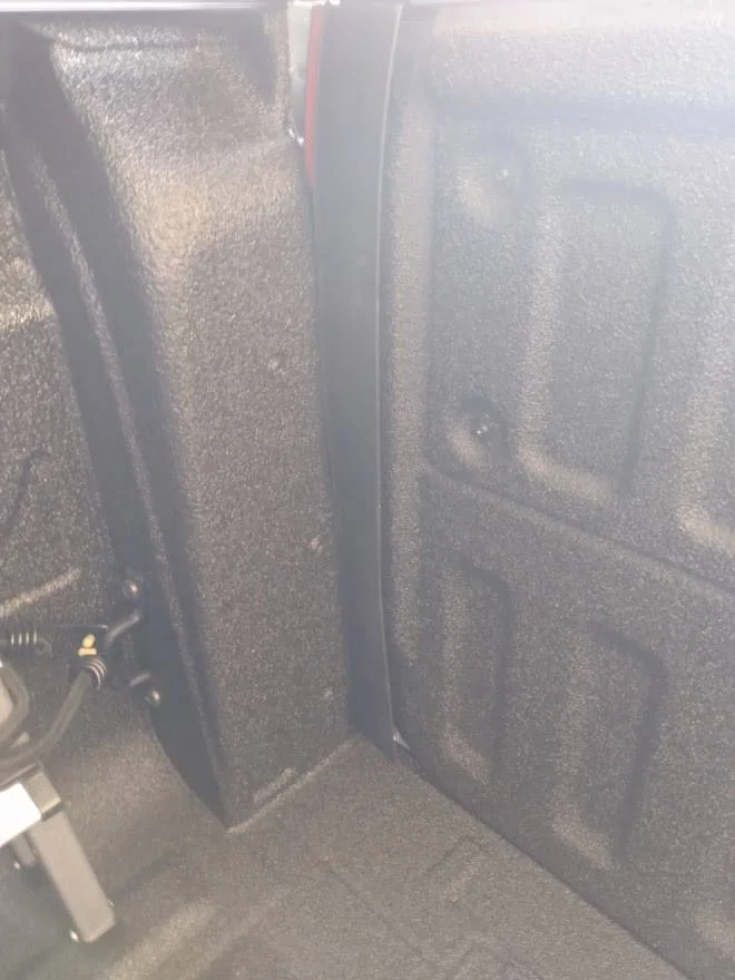

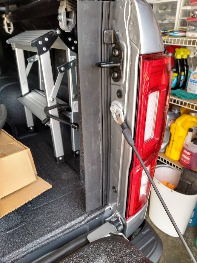

I may have found a way to seal the tailgate openings against dust/water....long but follow ....
Those of you fimilar with RV's with slideouts know the openings have bulb seals and wipers made from rubber, and usually have a very strong double sided adhesive tape.
I had some of both on hand from doing repairs to my RV over the years.
The photos show the wiper seals on the passenger side, while I left the drivers side stock so you could see the difference.
Also had a length of bulb type gasket that just happened to snap over the "T" on the top of the bumper plastic.
I don't know how well this will work as my Ranger hasen't really seen any dust and its kept garaged.
I'll get the ### of the seals/wipers tomorrow if anyone is interested, BUT, be aware that this stuff ain't cheap.
