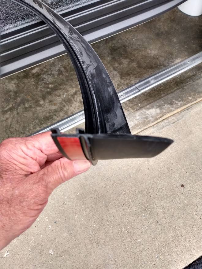

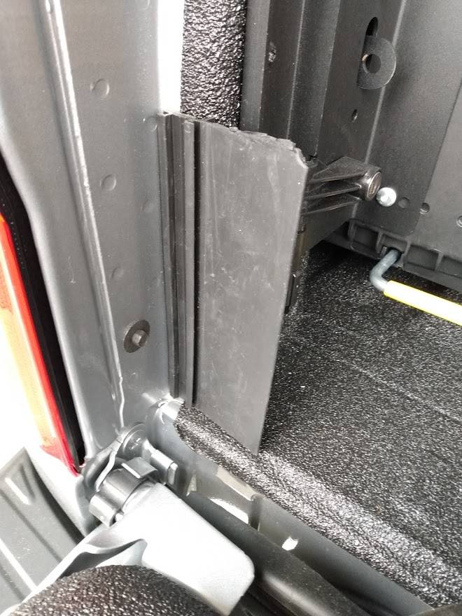

I may have found a way to seal the tailgate openings against dust/water....long but follow ....
Those of you fimilar with RV's with slideouts know the openings have bulb seals and wipers made from rubber, and usually have a very strong double sided adhesive tape.
I had some of both on hand from doing repairs to my RV over the years.
The photos show the wiper seals on the passenger side, while I left the drivers side stock so you could see the difference.
Also had a length of bulb type gasket that just happened to snap over the "T" on the top of the bumper plastic.
I don't know how well this will work as my Ranger hasen't really seen any dust and its kept garaged.
I'll get the ### of the seals/wipers tomorrow if anyone is interested, BUT, be aware that this stuff ain't cheap.

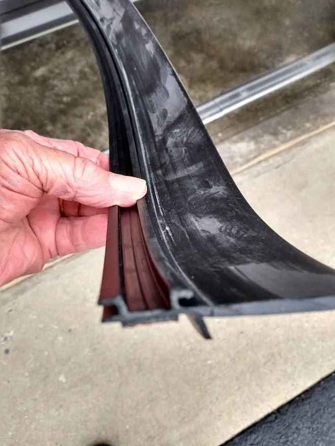

I had some of the bulb type seal that goes with the wiper seal. There is an "H" groove in the seal that just happens to snap over the top edge of the plastic bumper that sticks up between the bed and bumper. It has a "T" edge to it, and the bulb seal just snapped over it...just lucky. The bulb seal and wiper seal work together on the rv slide out to keep water out. One pic shows the bulb seal on the plastic edge, and when I close the tailgate, the bottom of the tailgate does compress the seal.
My spray in liner is still clean, but I wiped down the area with some alcohol. Double sided tape on the rubber wiper is very strong....some of it has been on my RV for 7-8 years and is still holding tight.
Seems to adhere to the liner spray just fine, but again I just put it on and only time will tell.
I will post some photos of the bulb and wiper seal tomorrow so you can see how they correspond to each other, and how I applied them.

I bought this stuff on Amazon back in 2014...still there. but only sold in large rolls, no short lengths.
The wiper is AP Products 018-341, the bulb seal is AP Products 018-312.
If there is an RV Parts dealer in your area they might carry similar by the foot.
Pic's of it tomorrow.

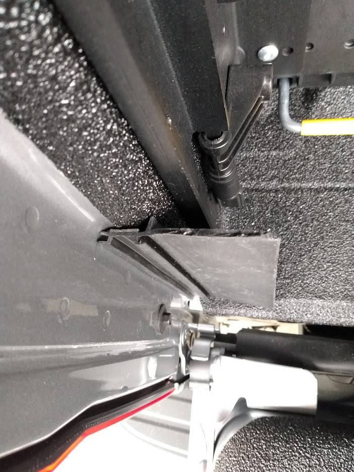

Few more photo's to show how it orients to the side of the bed.
Just throwing out some ideas of what's out there as far as weather striping and seals. This is stuff I had on hand and it seems to work, but only time will tell.
