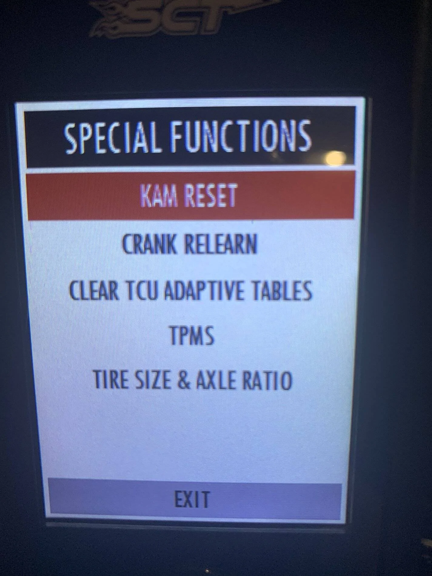

I have the SCT BDX but it doesn’t let me change the tire and speedometer

From what I understand that’s correct. It’s not a current feature. This is all new to me and I just got my SCT tuner in the mail yesterday, ForScan will allow you to adjust it. 50$ cable off Amazon and an hour or so on your computer and you adjust it along with other things too. That’s what I’m planning on. Search Forscan in the forums for lots of info

Go to Vehicle Functions then Special Functions

Yes.
