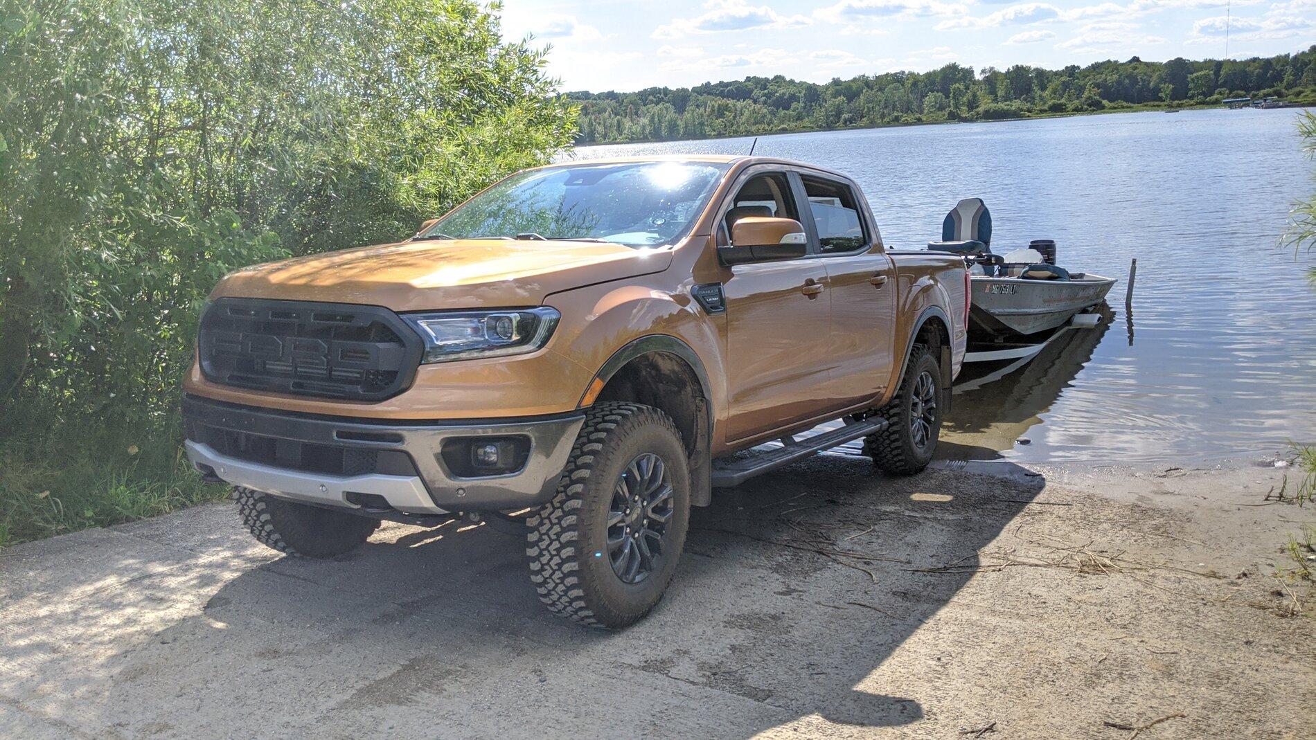

So the math says these tires are 31.6" tall, but my tape measure says they're over 32". At that height, 9th gear is as tall as 10th is, on stock rubber. These tires are 50 pounds each, so I'm sure that's most of my problem, but they robbed a LOT of power. I lock the truck out of 10th EVERY TIME. I literally haven't used 10th since I put the tires on. It can't handle it.

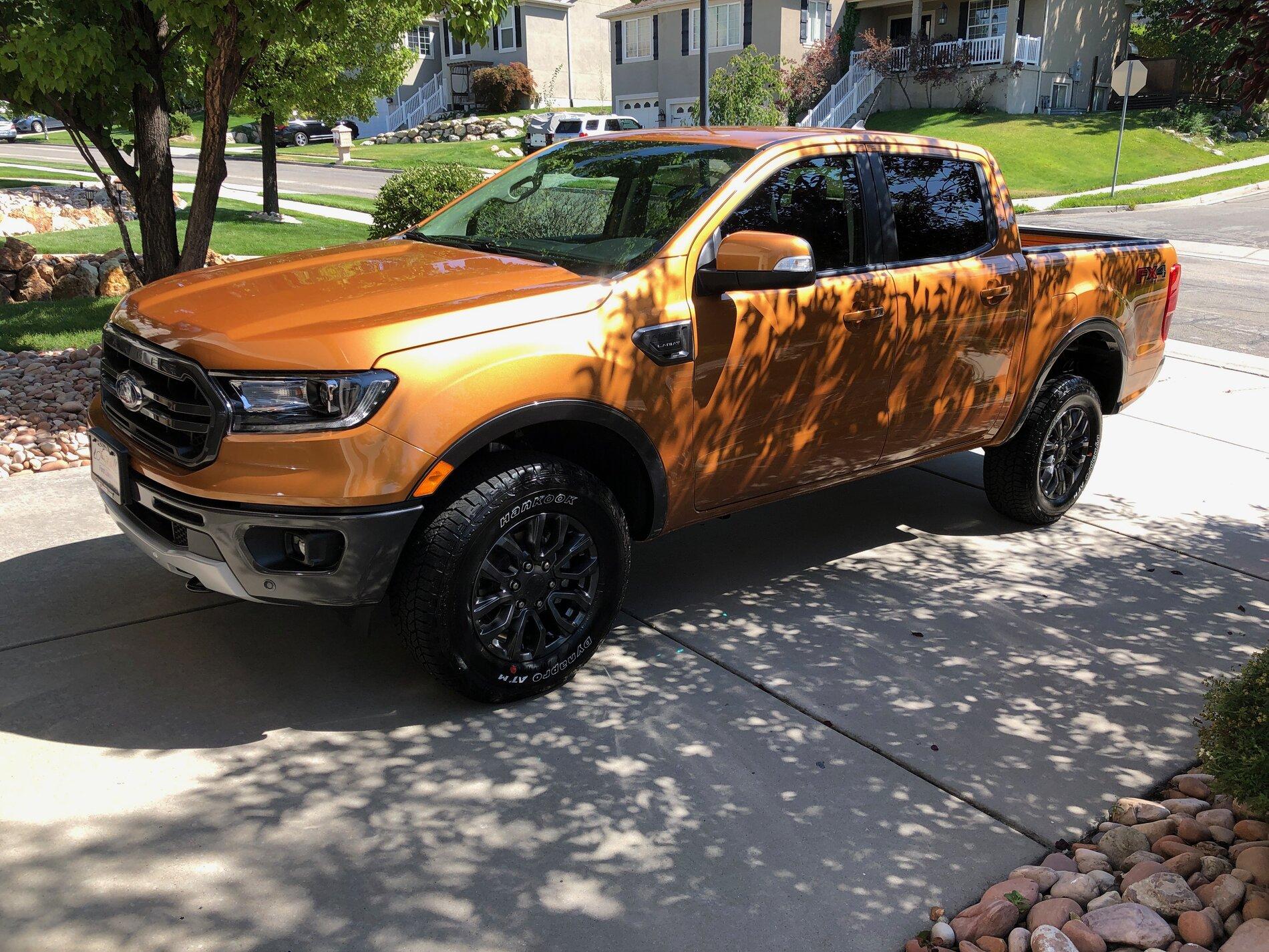

Hey David.... not sure if this will help or confuse?
I have the FX4 & Sport Appearance Package w/17" Magnetic wheels. Stock tires were the Hankook Dyna-Pro LT265/65R17.
Here is my truck the day I brought it home:

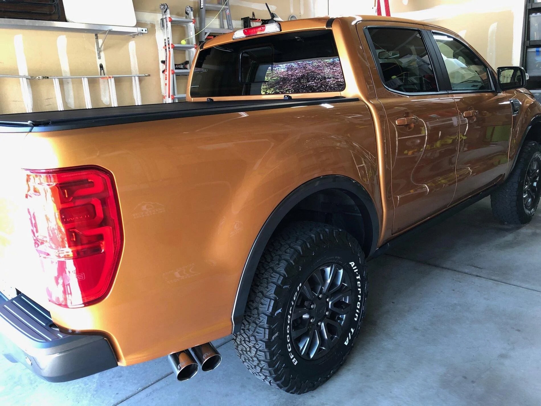

I went with the BFG K02 LT275/70R17 along with the Ready Lift 3" Level kit & 1" BORA spacers (also removed the FX4 decals):
Hope this helps!

It looks pretty nice. I think you're right, the slightly bigger tire must be part of the FX4 package. Your diameter change going from 265/65/17 to 275/70/17 is similar to Jake's in terms of percentage. I'm also planning to switch to KO2s before winter hits, but was thinking of 265/70/17.

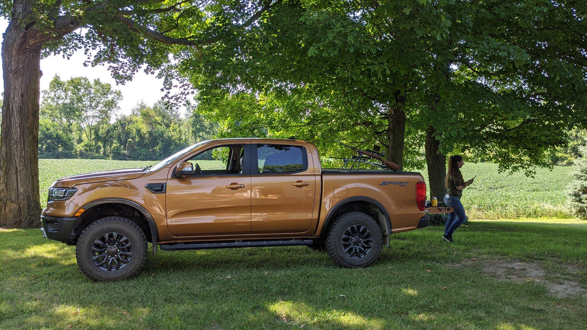

Still haven’t seen very many Saber Rangers out in the wild. Only one I spotted on our last road trip over 2200 miles was this one!
