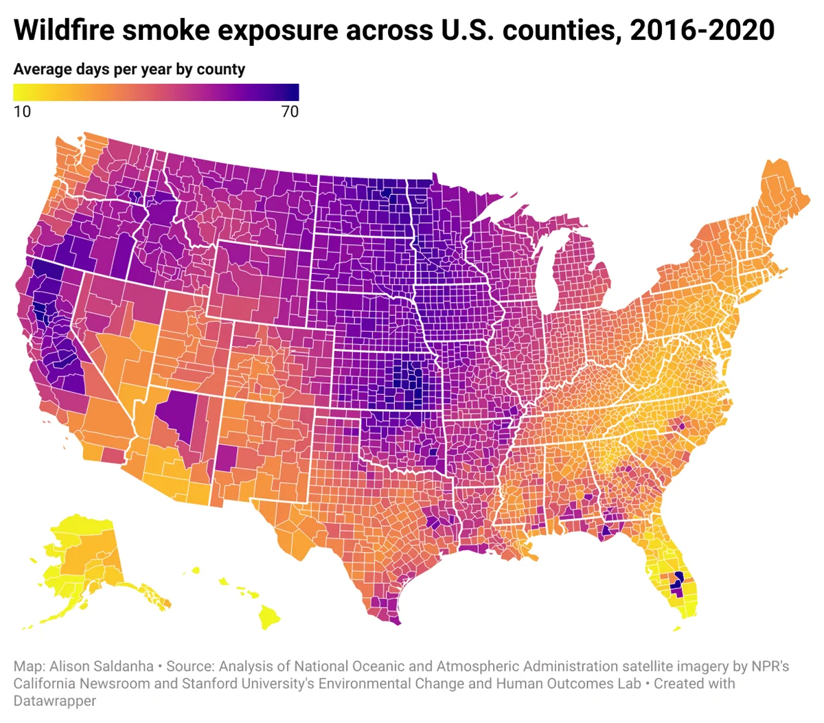

Some areas of the country (like where I am) have dangerous levels of smoke for months on end. This is not an exaggeration; such toxins in the air are known to cause cancer etc.
I think it's totally warranted to want to breath clean air when driving; being exposed to smoke during that time is (obviously) undesirable.
See the earlier parts of the thread, which talks more about this.
:LOL: :LOL: :LOL: :LOL: :LOL: :LOL: :LOL:
There is literally nowhere in the US where the climate is so smoky for months on end, every year, to warrant your concern.
I'd break down the numbers for you but for some reason you want to be very vague about where you're from.
Suffice it to say that even if in the worst area of the US west, even Kansans have it as rough as you.
It's a total exaggeration.
If it were as bad as you say driving should be the least of your concerns. You should be more worried about the other 20-22 hours of the day.

Before answering, I don't appreciate being made fun of.
I'm not sure why hate replies exists... Why would someone take issue with someone else trying to minimize their own exposure?
It's confusing to read posts like yours: it seems you're saying that since 100% of toxins can't be eliminated, it's not worth trying to reduce at all.
I don't understand that perspective, but I respect others' perspectives, so I'm not going to make fun of yours...:)
"There is literally nowhere in the US where the climate is so smoky for months on end, every year, to warrant your concern."
Yes, there are locations like that. I will withhold my information on a public forum. However, there are MANY places where there is smoke for 6 months of the year, at 150+ AQI for much of it.
This is first, due to wildfires in late summer and fall, then, throughout the winter due to wood burning.
In these cases, for prolonged exposure outside, many people do wear a mask since it's unhealthy. It's a personal choice to do so or not, even though many people are okay with breathing unclean air :)
