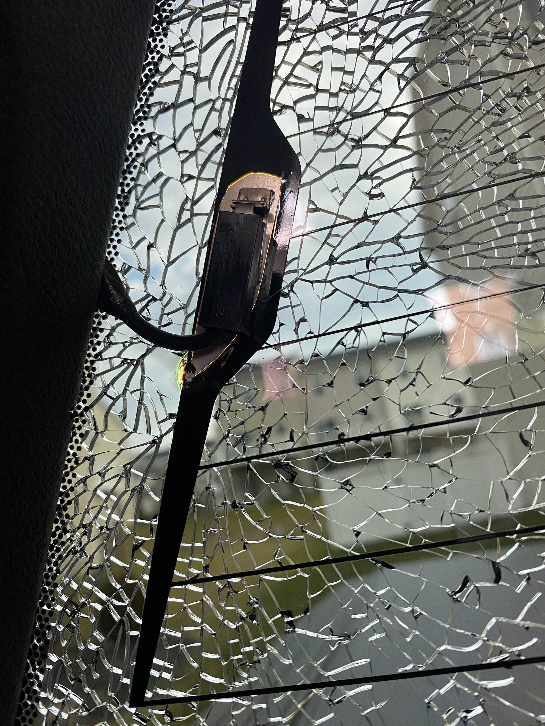

It was not. But looking closer it appears to be blown Around that area. FORD Denied the claim. Knew it would happen, but was worth a shot. Filing through insurance and soonest they can do it is Friday ?.

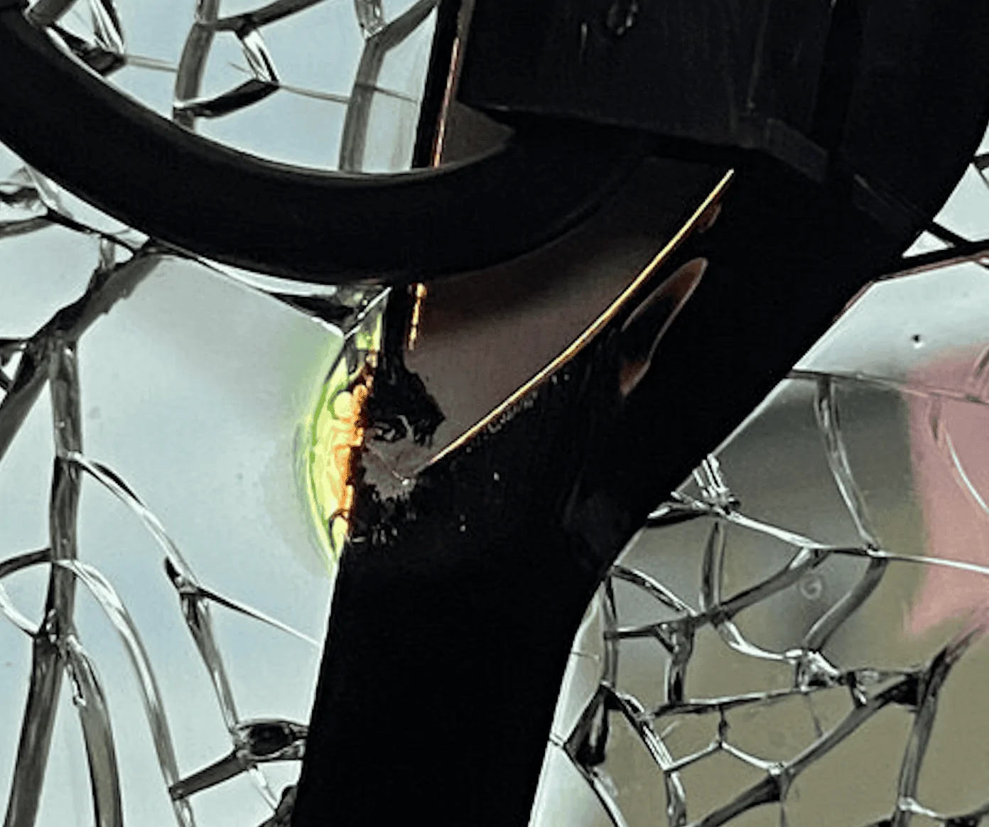

Looks like a chip next to the plug where there is a quarter moon burn mark tint may have cut the element creating a short.

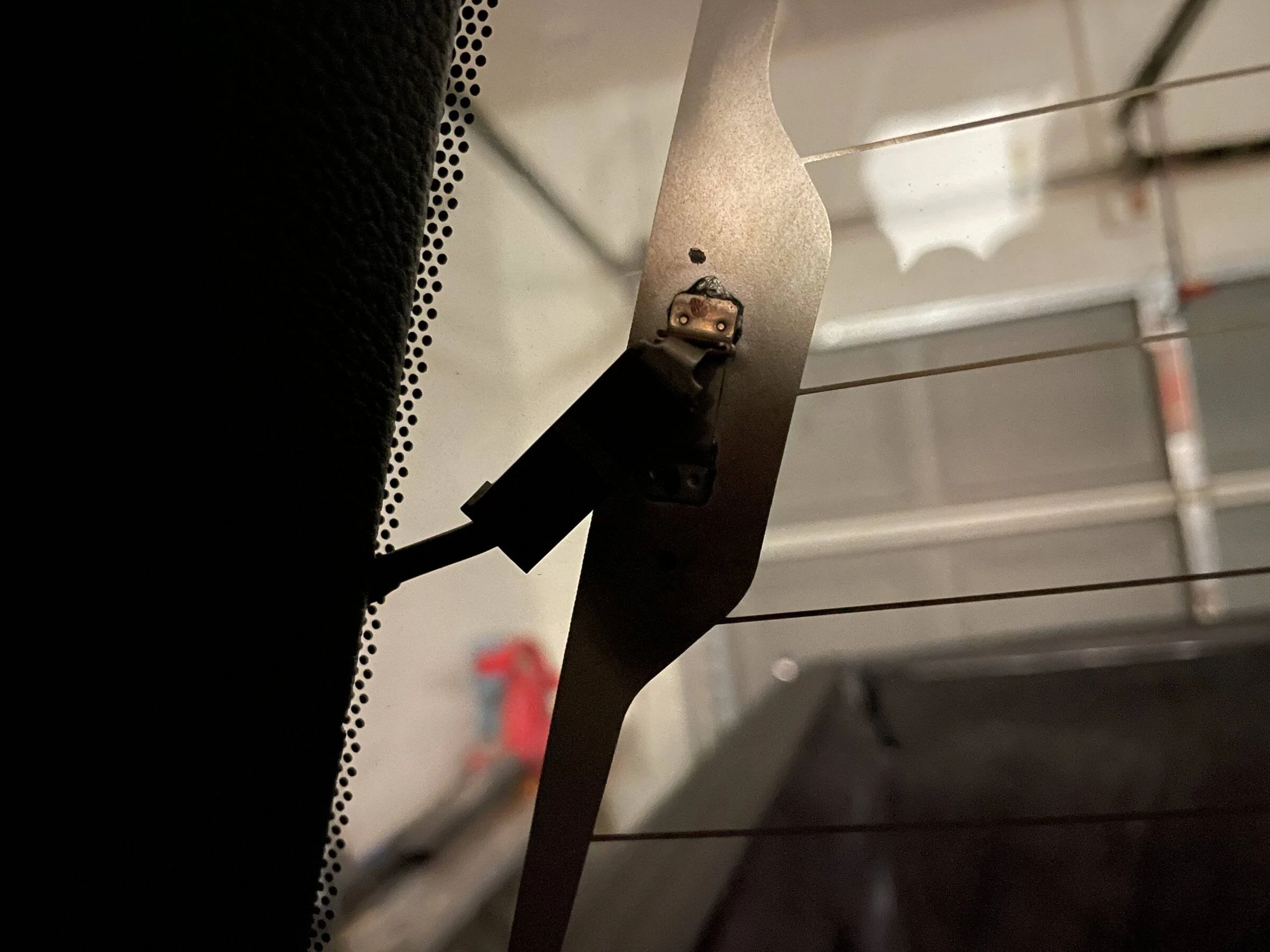

My plug on the passenger side was installed bent with no play in the cabling. I caught that at purchase and the dealer added to my warranty 96 months 80,000 miles on the rear glass rather than replace.

Is this a chip?
The rear defroster is essential just a large resistor. My guess the window tint installer cut the heating element during install creating a short. That short may not have manifested until the time it cracked, or took a bit of time to create the failure. The heating elements are very thin and easy to damage.
Either the defroster only has current when "ON" with a switch or there is always some amount of nominal current. There could also be a sequence at startup to ensure the defroster is plugged in and working, sending a brief current to check the resistance. Not sure, but that looks like a chip in the picture with a burn mark to me.

It kind of does look like a short and melting around the defroster connection
