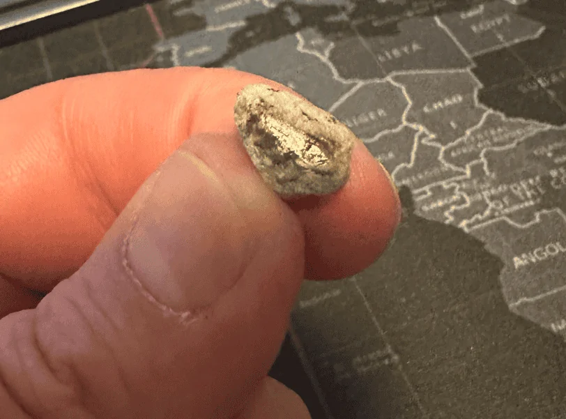

Found the lil bast'rd. It was right by the debris exit on the bottom of the brake shield but just wouldn't fall out on its own. Cut a nice groove into the back of the disk that I could feel with my gloves.
Wow, I'm relieved you found it - I figured it would be one of those ghost noises that you live with or ... with heavy dread, go to the dealer.
Glad you found it! Phew! =)
