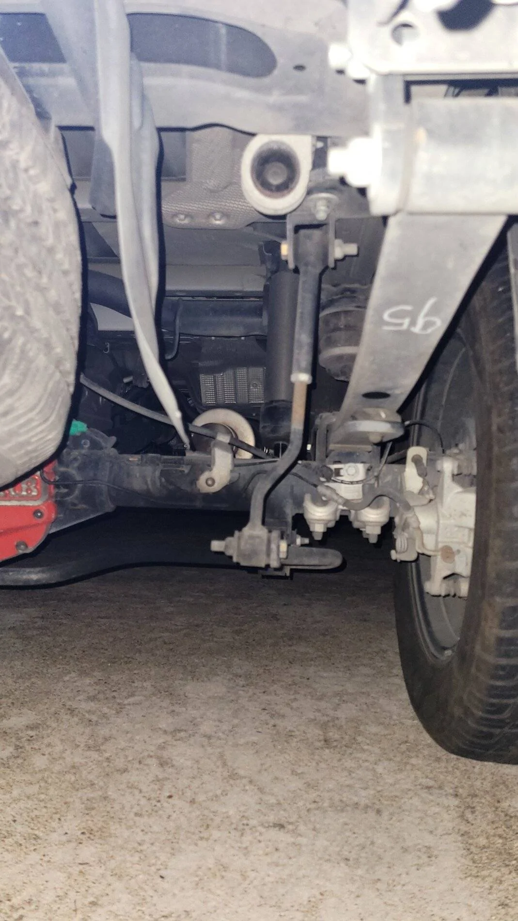

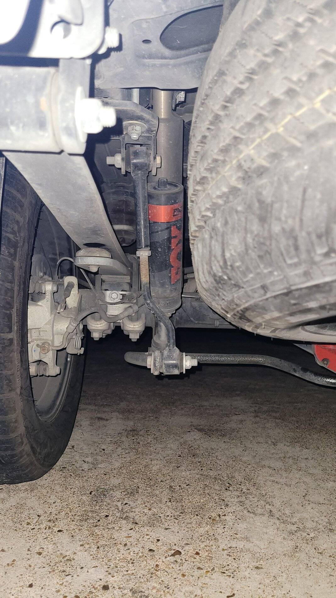

Wonder if straight end links would work, looks like they might.

Mine has a 4-2 drop on it and I was wondering if that would work on mine also.
