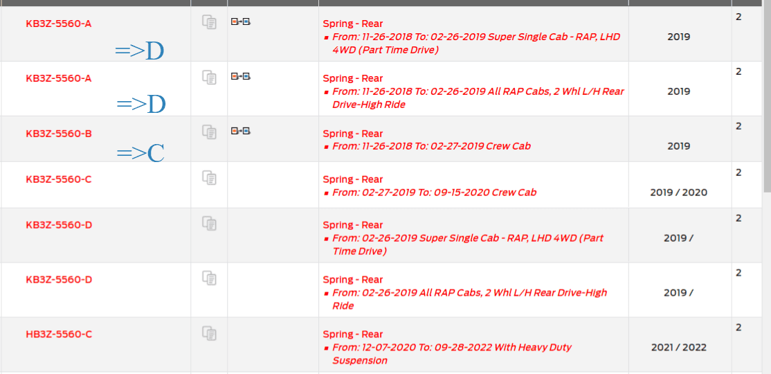

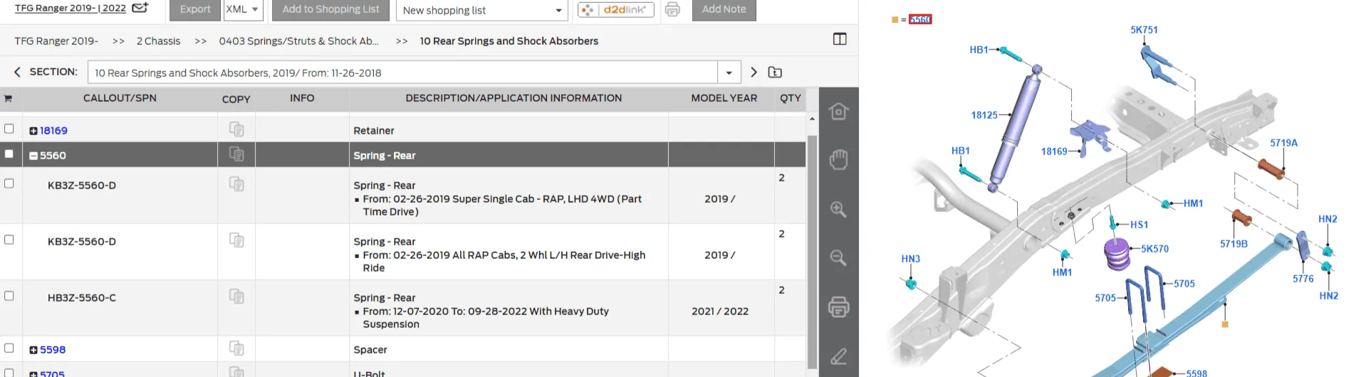

Benny, I will take your word for it. I looked closer at the inserted image and was not sure what I was reading. I take it the RAP is the Crew CAB? It confirmed the change in letter at the end is related to spring rate because the C is stated as heavy duty. Thanks for the help.

Sorry Gary I stand corrected here. Damn Ford catalog threw me for a loop again. After entering a VIN and then turning off all filters I can now see more options rather than simply going in by year make and model which makes no sense. Here is what I show now including the superseded part numbers
So this Indicates they are different and that Crew Cabs use a "C" suffix.
Hope this makes sense.

Benny, I am still not sure about what I am seeing. I don't know what the =>D and =>C mean, but they are different than the last letter in the part number. Is that the superseded letter? Of all the part numbers shown, the only difference is the last letter. I am guessing the Tremor rear spring has its own part number and is not listed.
So, if the => indicates superseded, then only the C and D suspensions can be ordered now. One thing I can decipher is all the Crew Cabs have heavy duty rear suspension if a RAP cab is a Super Cab.
I am still thinking the last letter is a designation for spring rate since C is called Heavy Duty in the last line. That last line does not call out which type of Cab it is for. It just states for model years 2021/2022. That may indicate there are some Rangers models other than Crew Cabs that have the Heavy Duty Suspension. That could be a hint that the only difference in the rear spring is the spring rate and they could be mechanically interchangeable between the Super Cab and Crew Cab.
It is possible the mounting hardware could different between the C and D rear springs.
So, I don't have a definitive "yes, they are interchangeable", but I am a little closer to feeling positive about being able to use Tremor rear springs on a Super Cab.

Hi Gary,
Yes those indicate a superseded # , For example KB3Z-5560-A has been superseded by KB3Z-5560-D
No, not all Crew cabs are HD. The HD is the Tremor spring. Take note of the "H" first letter in the part # as opposed to the "K"
Correct we do not have a definitive answer on any possible dimensional differences at this time.
