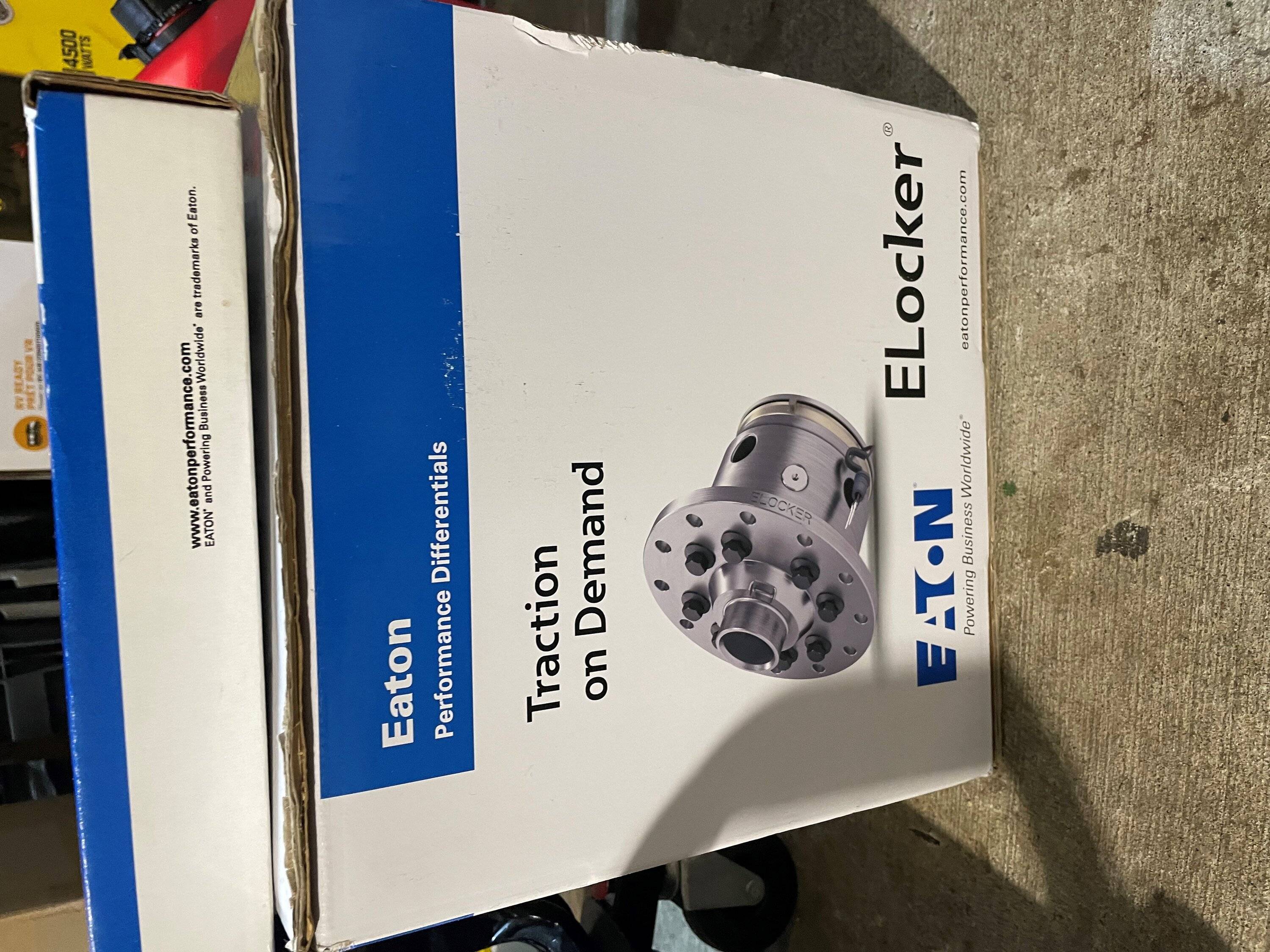

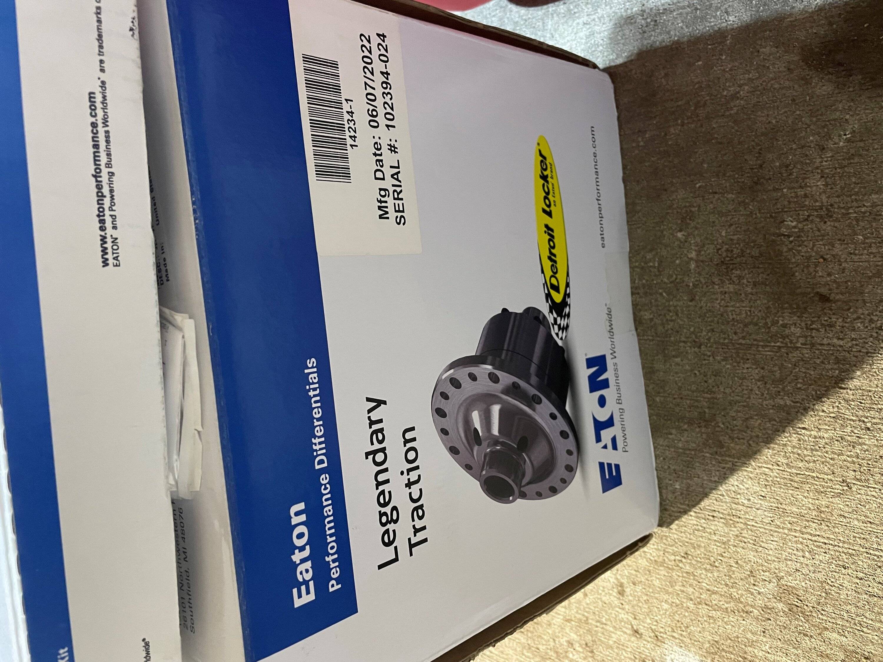

I just pulled the trigger on a Eaton Elocker for my rear. A few of us are heading to Moab this so I figured it would be an asset. I was not a fan of the ARB due to the extreme cold we can get up here (-45C). Took some doing but i not have it in my garage and will have it installed come Tuesday. I will give an update once it is installed.

Here is to hoping it works. The locker diff and non locking diffs are different splines

this is made for the open diff fits with the....m200...m220....not made for the locking diff.

So I saw the post about the ring gear being welded on AFTER my diff was opened. So now I need to try and order one. Dealerships say the are back ordered. Now its trying to find one........
Stage 3 Motorsports.

Getting it installed next Thursday. Updates after that.

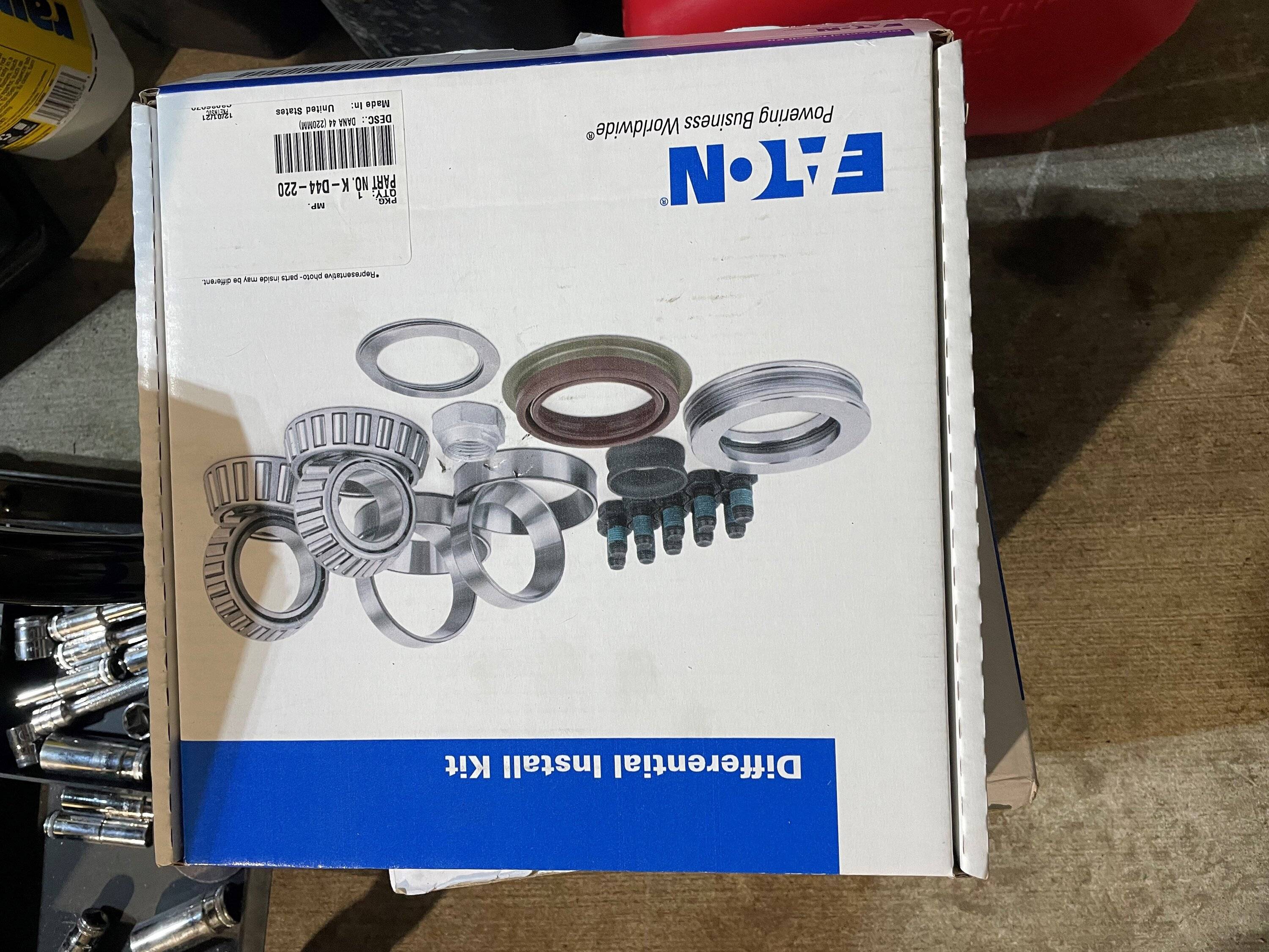

ITS IN!!! . I’ll post pics but you need two bearings that have the wrong numbers on the Stage3 website the pinion bearings. Now the break in period.
