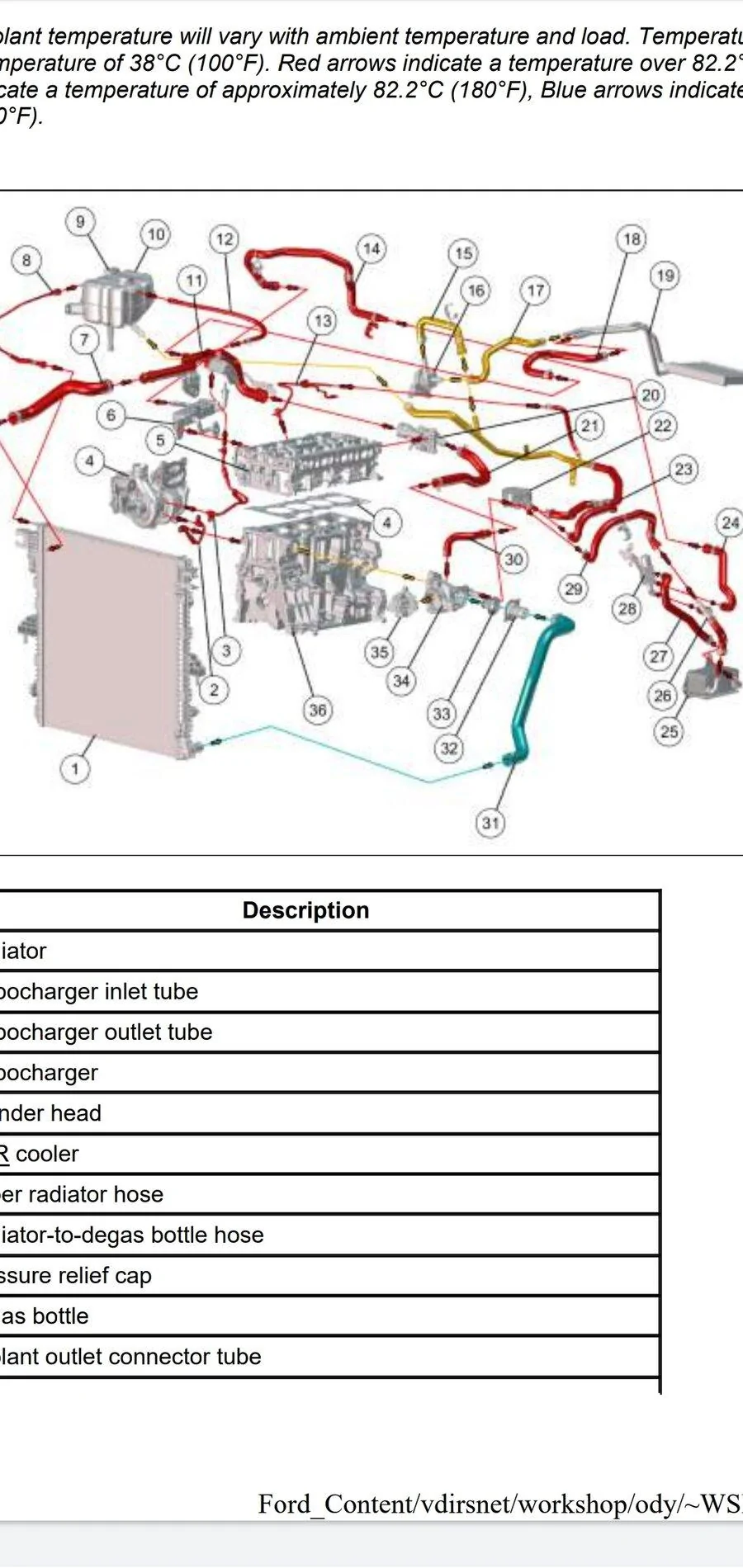

Thermostat has worked well. I qualify that statement before everyone decides to come here saying that I’m endorsing it incorrectly and how OEM temp is perfect, etc to clarify that the part itself it functioning as intended. Here is the data I’ve observed scanning with the Ford Performance tune display. Please note for trans temps that the trans cooler thermostat is bypassed (it normally will not flow coolant to the trans cooler until trans fluid temp is 195 deg) and has the aluminum PPE deep transmission pan.
Avg coolant temp - 177 f
Avg cylinder head temp - 178 f
Avg Transmission fluid temp - 176 f
One day I decided to get into the gnarliest stop and go traffic I could for 30 min on a warm day here in GA to see what the temps would be with an extended heat soak.
Highest coolant temp - 185 f
Highest cylinder head temp - 185 f
Highest transmission temp - 188f
I am very pleased to say that without modifying the factory fan to kick on sooner (can’t be done from research I could find from Ford F-250’s that have similar electric fan clutch as us), the factory radiator does a nice job of dissipating the heat from the coolant and as soon as airflow comes into play when the truck starts to move again temps drop very quickly as well. The truck does reach closed loop with this cooler thermostat, and while I’m confident if I had the all aluminum radiator from Mishimoto I could get right down to 170 consistently, the research I could find on modern Fords said that some emission readiness monitors won’t set until an operating temp of 170 is reached. Thus to not have that struggle I’m happy with the results of the stock radiator and 170 deg t-stat (esp considering that this radiator cools the engine, engine oil, EGR exhaust gases, and transmission).

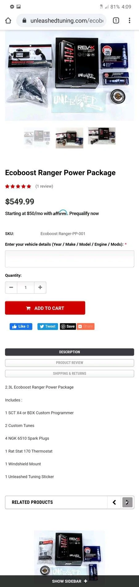

Do you have the actual part number off the box?
I wanted to order this thermostat or thermostat assembly along with one-step colder plugs for me Ranger.
I tried holding out for Livernois Performance to sell one and since yours works perfect... give in and order one like yours instead.
