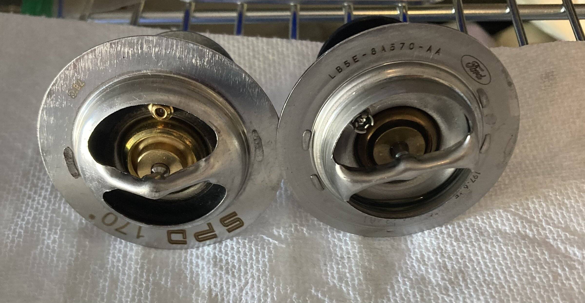

The 170F rating simply means that the thermostat opens once the coolant hits 170F. Engines do not like to be too cold. Ford has obviously decided that the OEM temperature is optimum for the engines operating temperature. So the designed that thermostat to ensure it gets up to temperature as fast as it can and then doesn't drop below it.
So as Phil said, say you are starting your Ranger up on a cold winter day and idling in traffic, it might never get above 170F, since coolant will start flowing into the engine at 170F. Well clearly the engineers want a higher operating temperature than that.

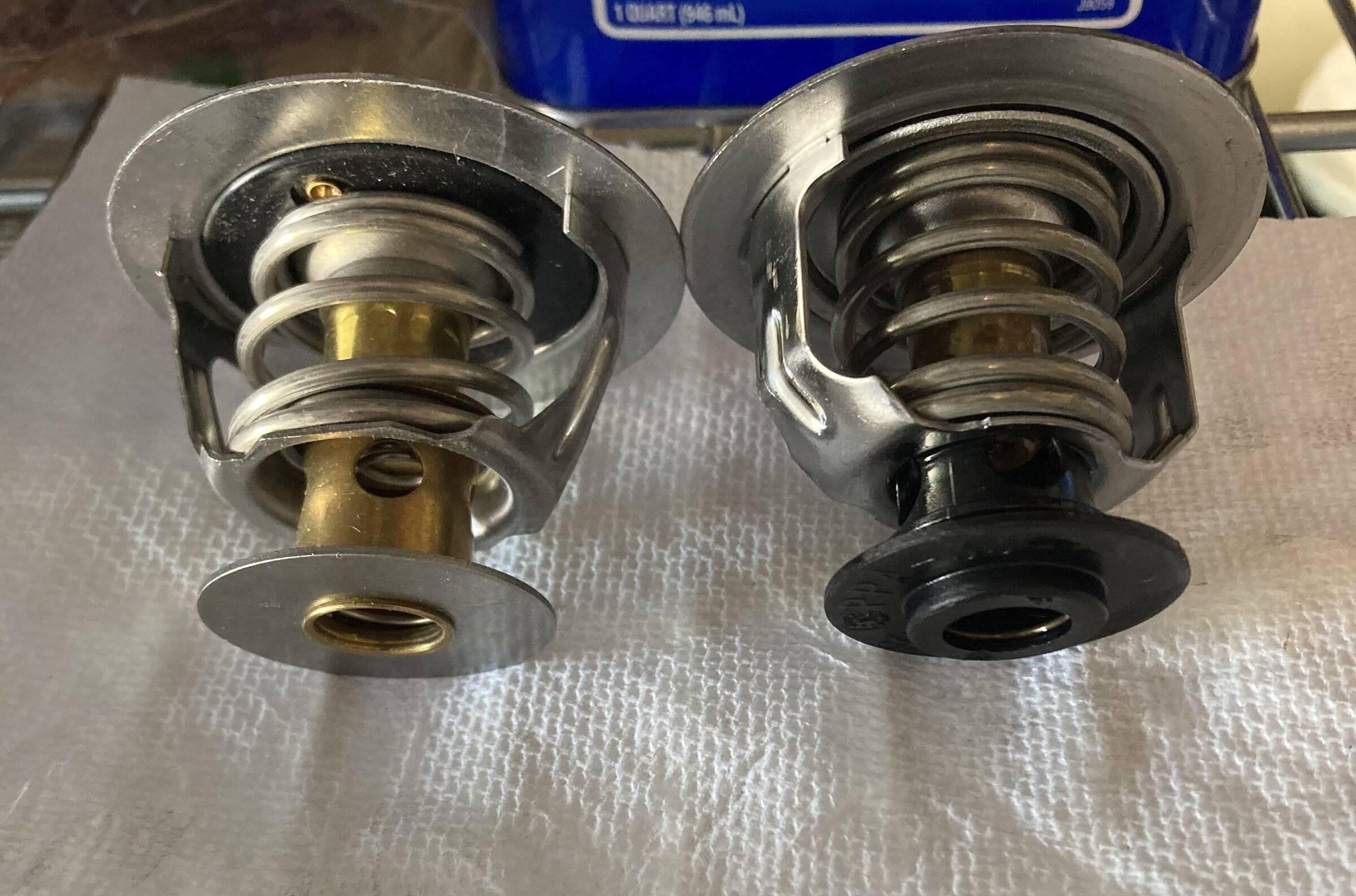

I'd want to know why specifically you switched to a lower temp thermostat. What problem are you trying to solve?
Then lastly, what effect does this have on the other cooling system components? The radiator, the fans, the water pump, etc.
Can they handle a 170F Tstat?
Simply put, a thermostats job is to keep the engine warm, not cold.
