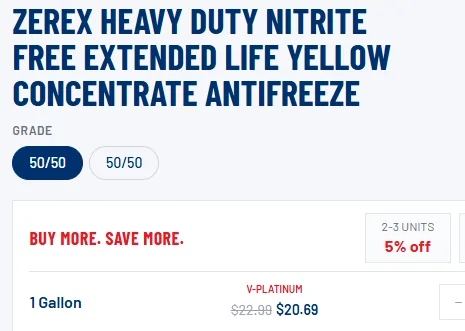

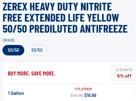

You can buy the undiluted stuff straight from Valvoline/Zerex. I buy the concentrate because it is about half the cost of the pre-mix.
Ok, so not exactly half by the time you buy a gallon of distilled water, but still....
