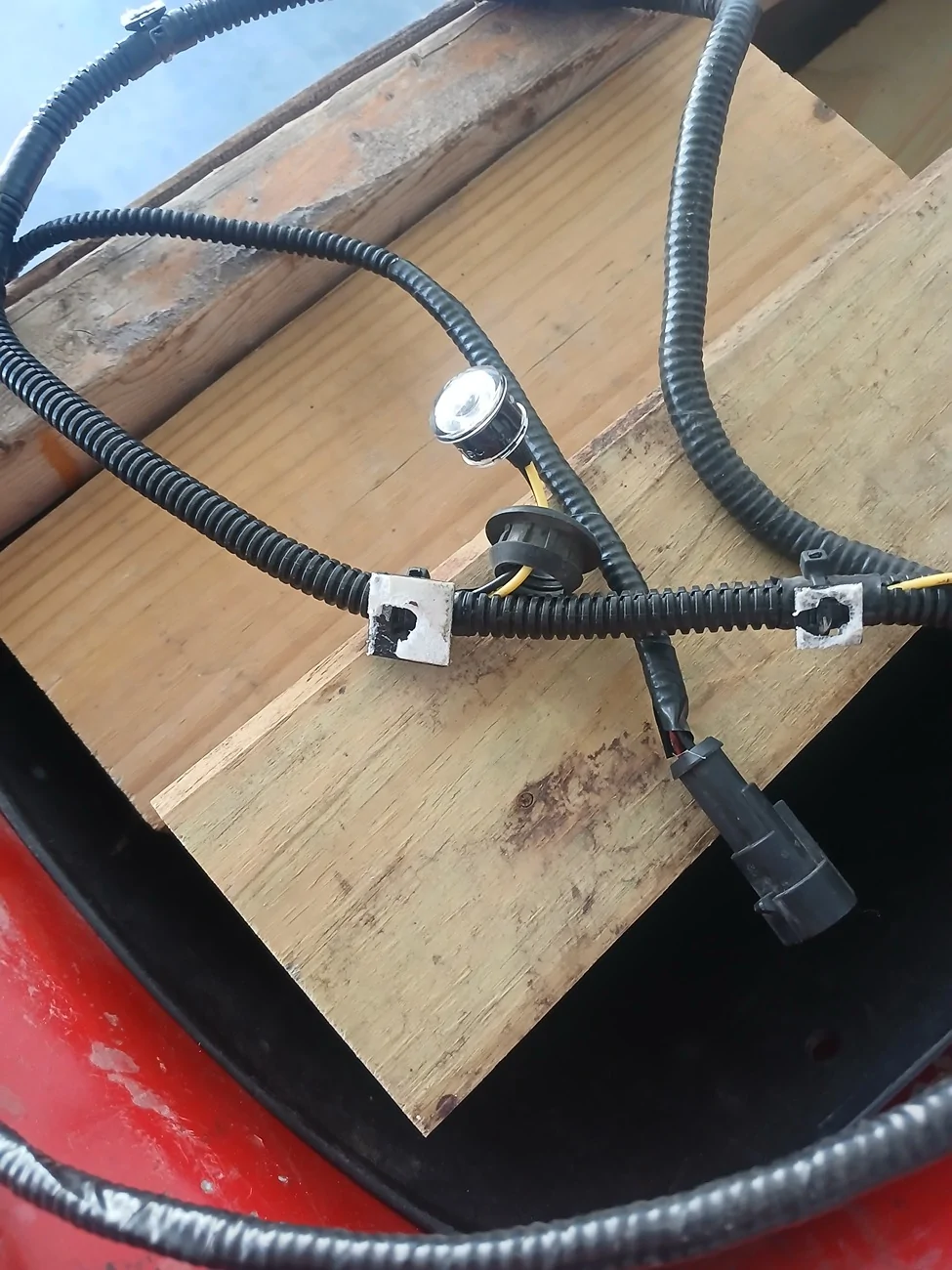

I went to look for my old one but must have tossed it , if I remember correctly, the lights were part of the harness and didn't unplug and that's why I didn't think they were actually in that Pic 🤔 ... ima smoke on the matter though...
After more smoking on the matter (which is most likely what's the matter) i did find the old one ...
