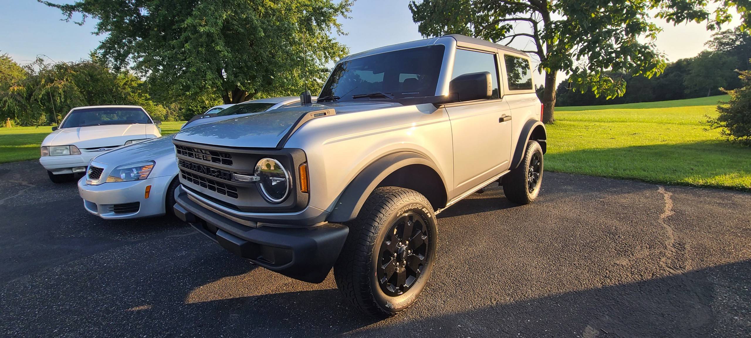

Yes they are the same bolt pattern. I've seen Rangers with Bronco wheels quite a bit.... but I haven't seen any Bronco's with Ranger wheels ?
Thanks, these are just black steelies. Just wanted to widen the potential pool of local buyers. ?
