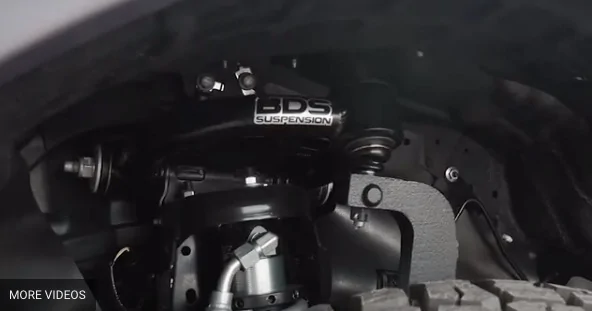

The BDS kits I saw were obviously not production ready. Looked like they put the upper control arm joint in a horrible bind. Didn’t get a good look at the Icon setup but I would expect the same. I hope to know much more on this in the next few months.

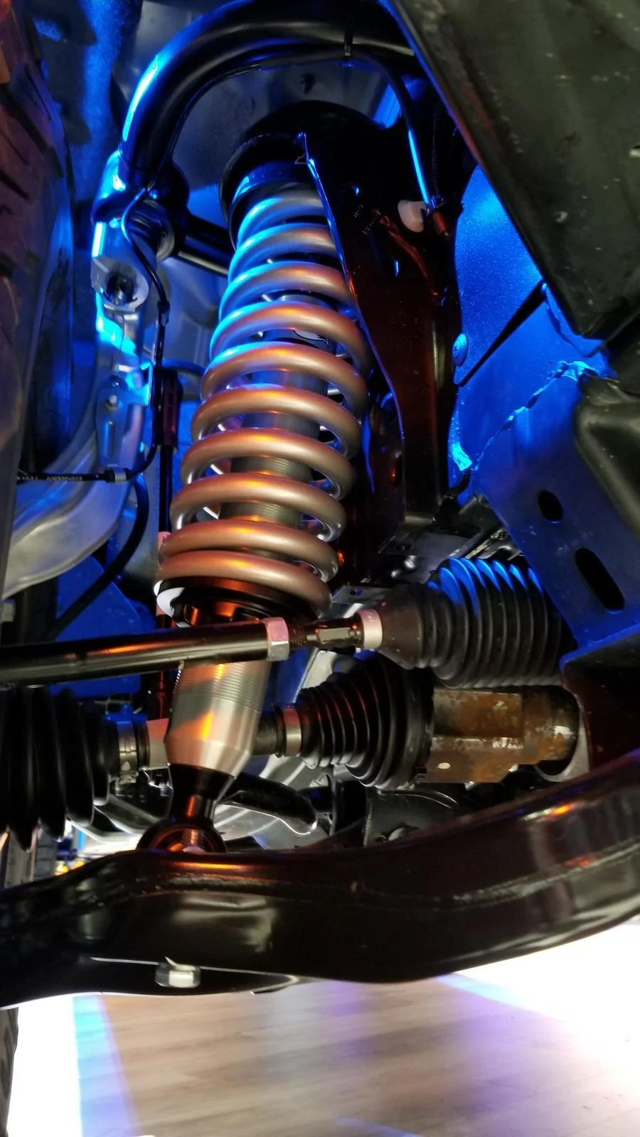

This depends more on the knuckle/UCA alignment after the lift. The BDS kits can't be production ready even with the UCAs. The joints look to be strained from the start. One thing I do question is if that is the stock knuckle.

That’s not the stock knuckle. You can see them making a new one in their videos.
The UCAs are the same aftermarket ones made for the T6 Ranger.

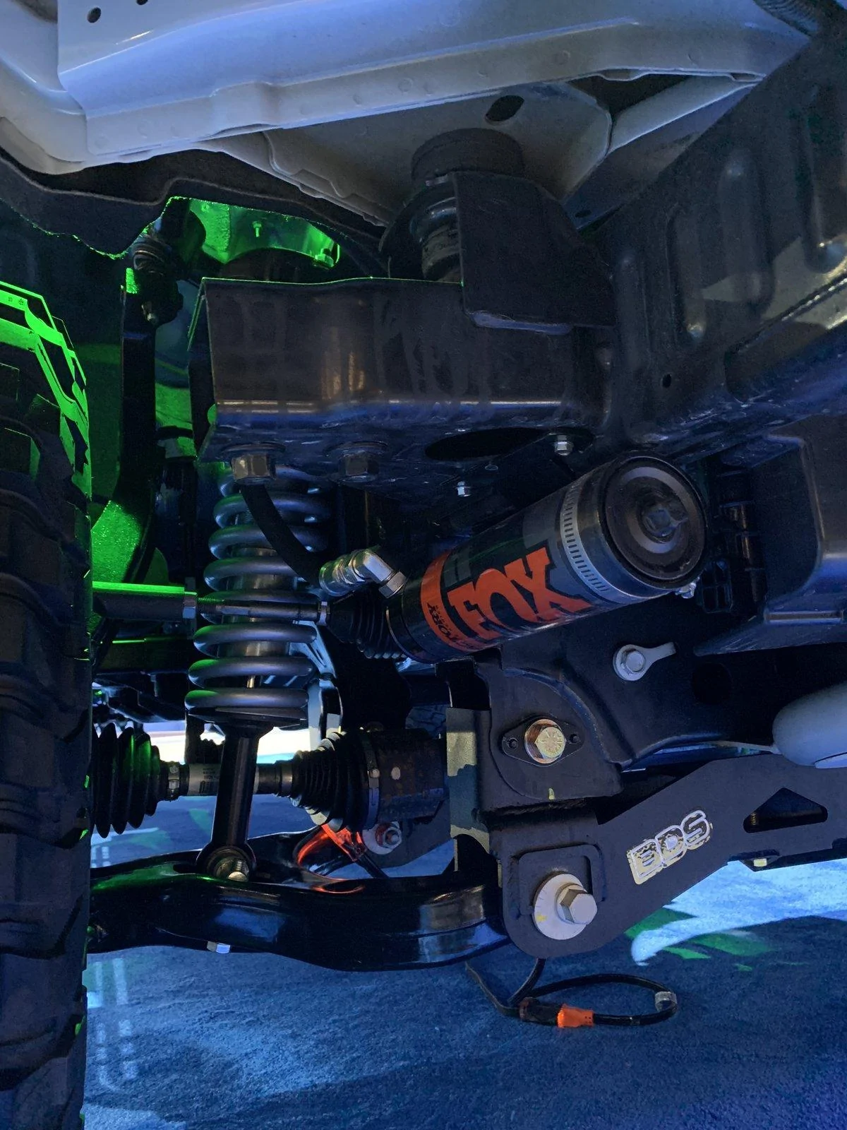

So this is an image I captured at this past SEMA, Fox reserve shock, with the BDS setup per your response.

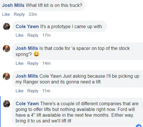

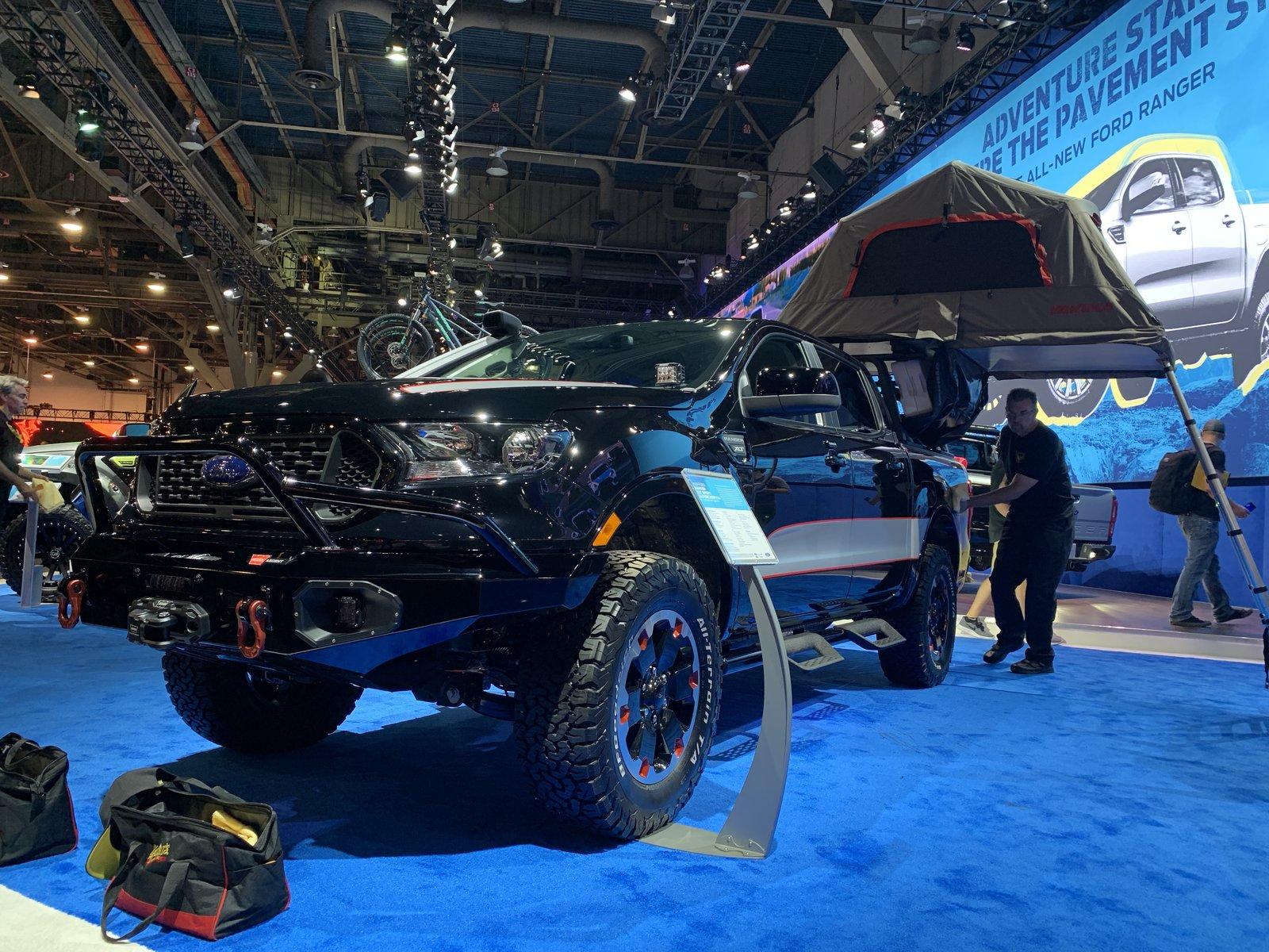

It looks like they removed the front crash bar and the air dam to make the wheels fit. I REALLY want to know what lift kit is on this truck.

Well... I tried.
