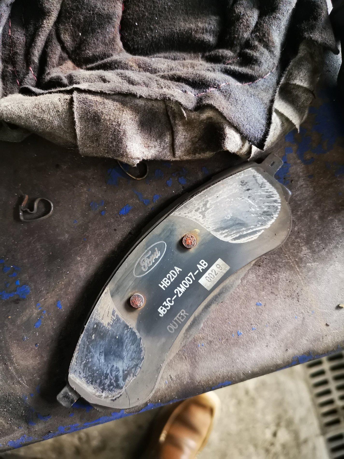

My ranger raptor at 12,000km needs rear brake pads replacement, ford here in Philippines is asking me for 400usd for the rear and 500usd for front, can someone please help me where to buy these online even internationally, or maybe brembo srt if you know what specs i should be looking

Is this the picture they showed you saying that you needed brakes? Because if so, this pictures shows you 0 indication of wear and is totally useless for knowing what your pad level is at. I agree with Phil, take it to another shop. Possibly another dealer if you have one close by.

I don't rest my foot on the brakes, i don't know maybe ford's brake pads easily wears off, im looking for a brake pads with longer life, with same specs as this one because auto parts here in Philippines province can't find pads same as this
I took this picture to show the parts number i saw the wear and it's almost less than 2mm thick left
