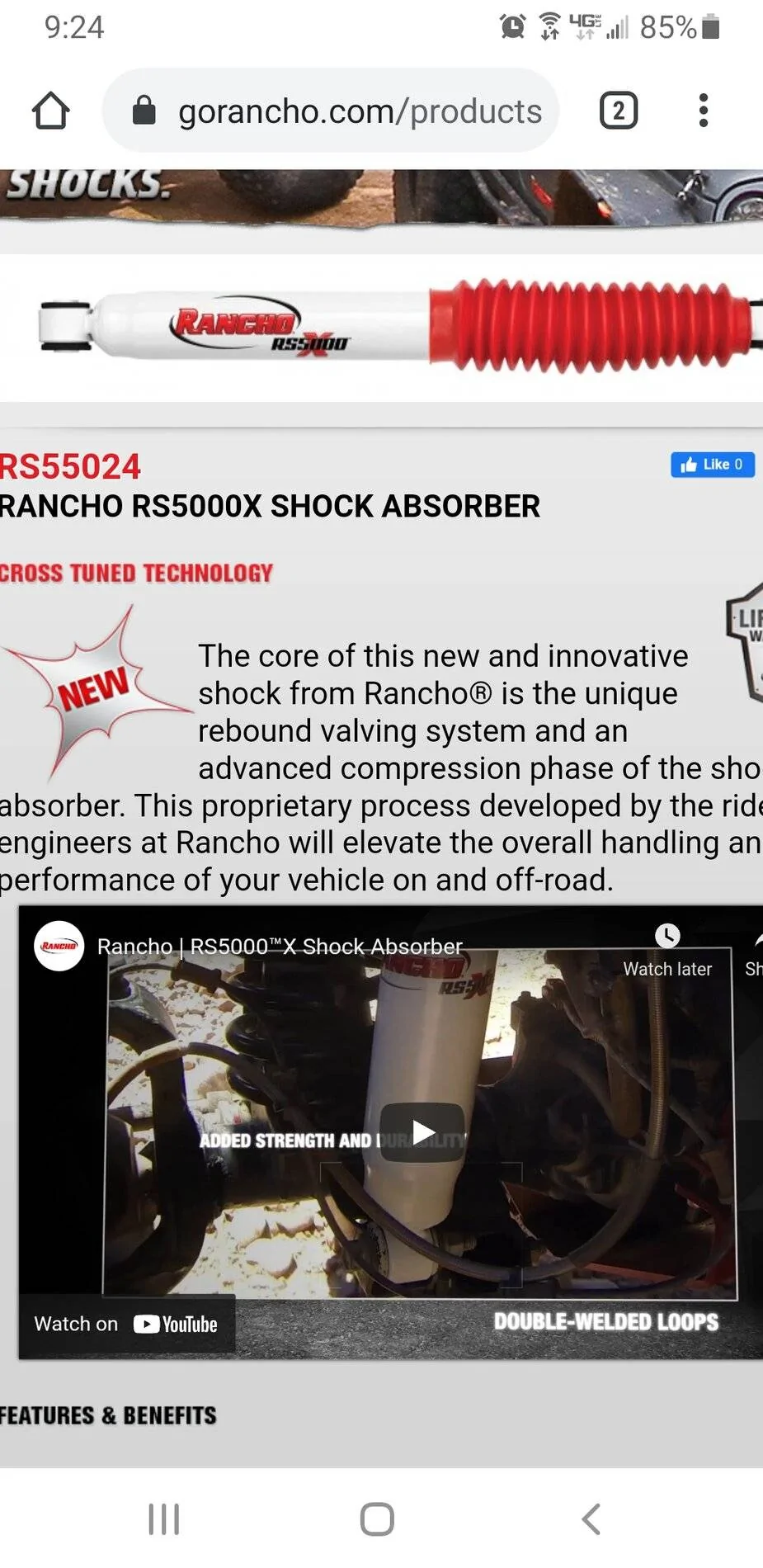

Well, since the prevailing thought is that any shock is better than stock, I ordered these. RS5000X. Just about $150 for both with shipping.
2019 STX stock height. No plans to lift, so these should be good to go.

added the pic if anyone needed the model number.

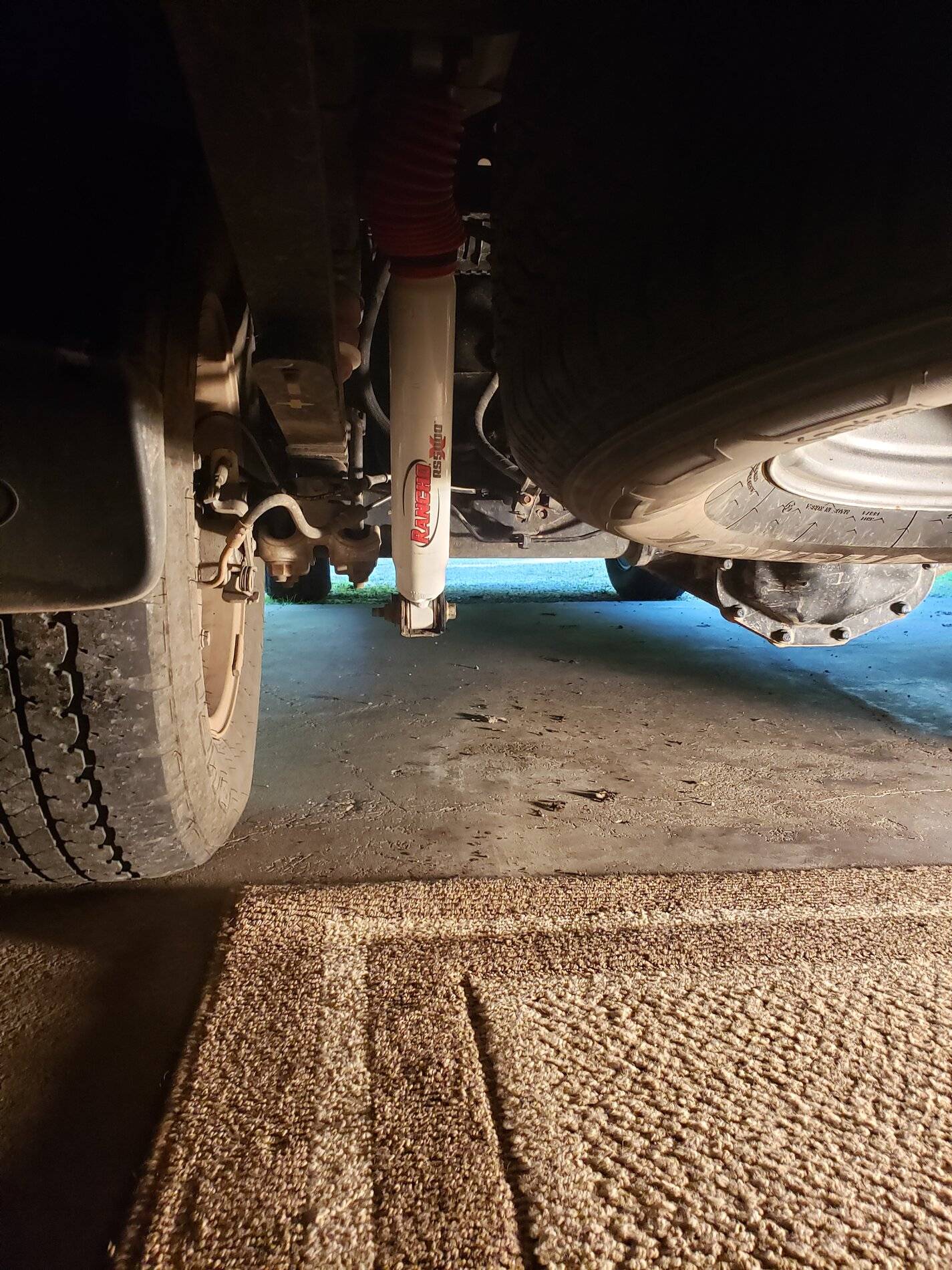

Ranchos installed.
Easy install. The only issue was the top nut dropped off the passenger side shock when removing OEM.
That was 30 min of looking and fishing out of the nook it fell in....
I was shocked how easy the OEM shocks are to compress. Thought the non FX4 would be stiffer.
I did measure ground to bottom of hitch receiver. Rear is now 1/4" higher.
I just muscled the new shock in. Took a bit, but was able to set on bottom bracket and used a screwdriver to align bolt.
Did not jack or remove tires or spare.
Took it for a short drive on these country gravel/dirt roads. The difference is apparent. The side to side wallow when hitting a pump/hole is pretty much gone. Firmer, more controlled feel overall.
I did find a bit of paved road. Turning the wheel back and forth at 60mph.....definitely feels firmer. Less body roll.
Will be heading to the mountains soon. Should be much better than stock
Overall happy with the Rancho 5000X. No clue if they will last.
For $147 delivered for both.......not goin to complain.
