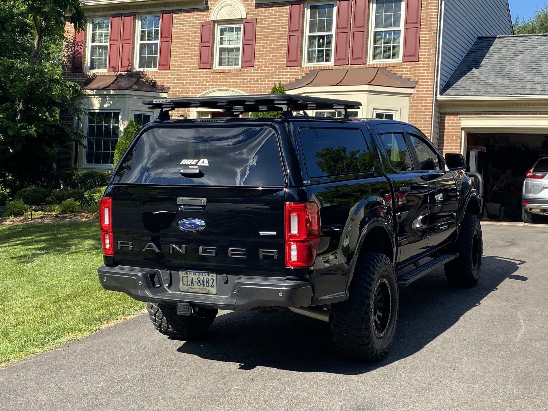

My ARE topper is on the way and just ordered a leaving kit. I'm new to the game here. Your tire set up is money. What size tires are those? I'm wandering if I can jump up to BF Goodrich 275/70r17?
Congrats on the topper! I’m running 295/70R17. I have a 3.5” lift though.

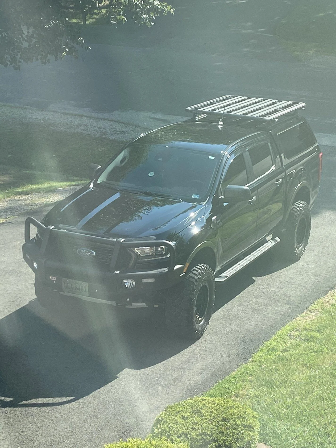

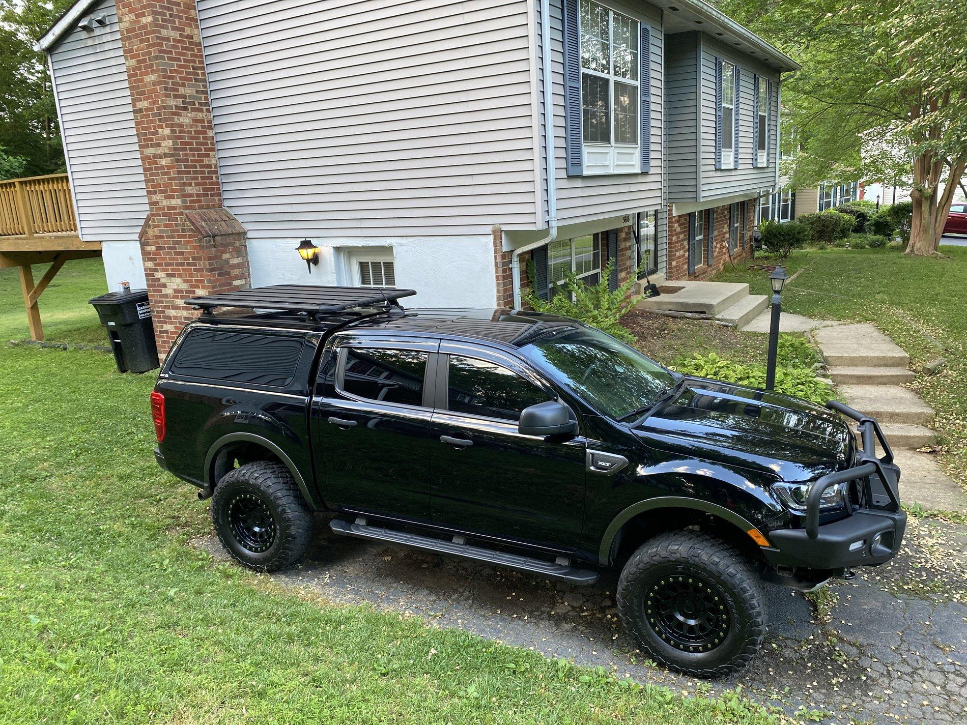

Finally got the Rhino Rack Pioneer Platform installed. I’m happy with the rack itself, I was just hoping the rails would sit a little lower.
I plan to carry the Darche Dirty Dee 1100 Swag with a complete set of Maxtrax for beach camping on the rack. Occasionally I’ll throw an SUP up there but I’ll need some front rails to tie it down more securely.
I also plan to install the Rhino Rack 270 awning, which the added height of the rails might end up becoming a benefit to me down the road.
Maybe it’ll look better once everything is all loaded up.
Love your setup and the way you've built up your truck! Looks great.

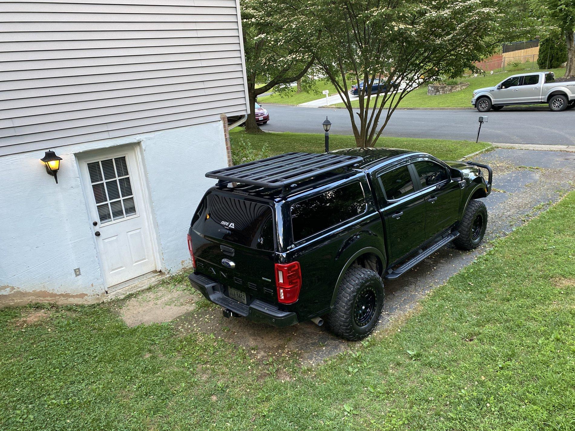

I just installed my Pioneer Platform yesterday and I'm really happy with the look. I bought the legs that mount directly to the fibreglass cap and to the cross bars that are built into the platform. The legs tuck up nicely into the underside of the platform.
This saved about 1-1/4" taken up by the Vortex Aero Bar or the HD crossbars and likely another 3/4" that the track mounts add. It was a very narrow squeeze tightening the legs to the cap mount but it all worked out.

Thanks man! Your truck looks awesome! Your rack sits at just the right height. Nicely done!
Thanks! I thought I was seeing double when I first saw your pictures - then I saw your rear doors and that wicked moose killer up front.
Hahahaha can’t go wrong with all black. Always looks good coming down the road.

do you mind sharing which legs you used?
9,603
45,988
Happy to share...
Legs: RFMPC2 Fixed Mount Cap/Topper Leg - 2 Legs/pkg
Platform: 42100B Pioneer Platform (60" x 49") - Assembled
The legs even have backing plates with covers for the inside of the cap. The finish is very clean - no exposed bolts.
The built-in crossbars of the 42100B are the same profile as the Rhino Rack HD crossbars shown above. This allows the legs to mount directly to the platform. Instead of having crossbars on top of legs and then a platform on top of the crossbars, you have the framework of the platform attached directly to the legs. The platform mounting instructions show how this works.
Different RL Series legs that mount to tracks, bars, rain gutters, etc. can also be mounted this way.
The 42100B has been replaced with the 52100F (unassembled) and the built-in crossbars have the Vortex Aero Bar profile, which require a spacer kit so the legs fit the profile of the crossbar properly - I think it's a VA-FK1.
Tucked up tight!
Roof inside the cap...

I've been looking at your photos more closely and it looks like you have your platform on top of Vortex Aero Bar crossbars. If you want to lower the profile of your platform, you should be able to lose the crossbars and mount the legs to the built-in crossbars in your Pioneer Platform.
If you have the 42100B platform, you don't need the spacer/adaptor currently on the legs.
If you have the newer 52100F platform, the built-in crossbars have the same profile as the Vortex Aero Bar crossbars and should fit perfectly with the spacer/adaptor that's on your legs now.
Because you have a track mount system, you can position your legs to line up with the platform's crossbars. Although it looks like they are directly below them now.
Check out the mounting instructions here.

Thanks for this! The extra height actually works out for me. The 270 awning barely clears with the rear window open on the truck cap.
9,603
45,988
I'm glad it's working out as you originally thought it might.
I was feeling your pain when you said you had hoped it sat a bit lower. Between the antenna and the window, it's a tight setup for the 5' screw cap - yep, I heard that as soon as I said it.
