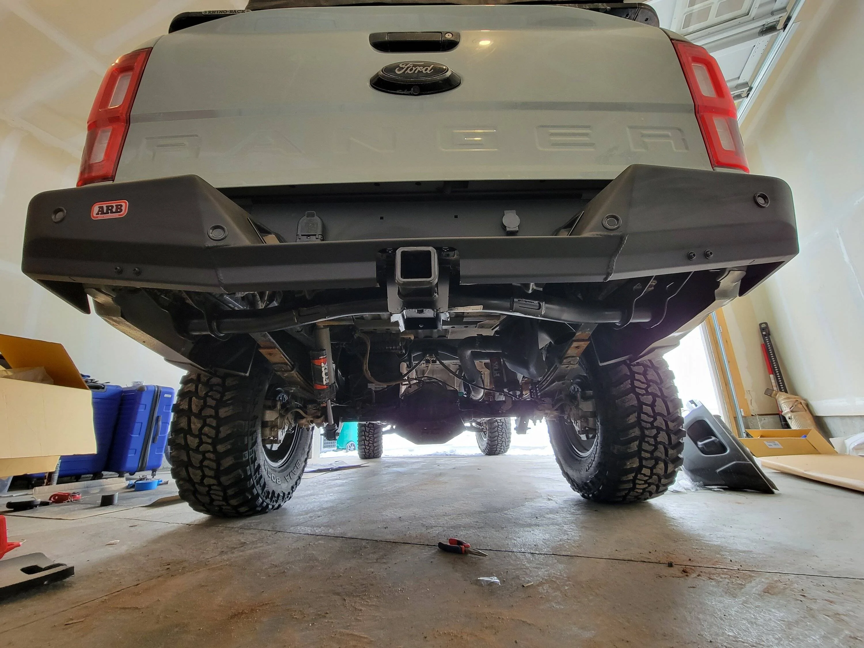

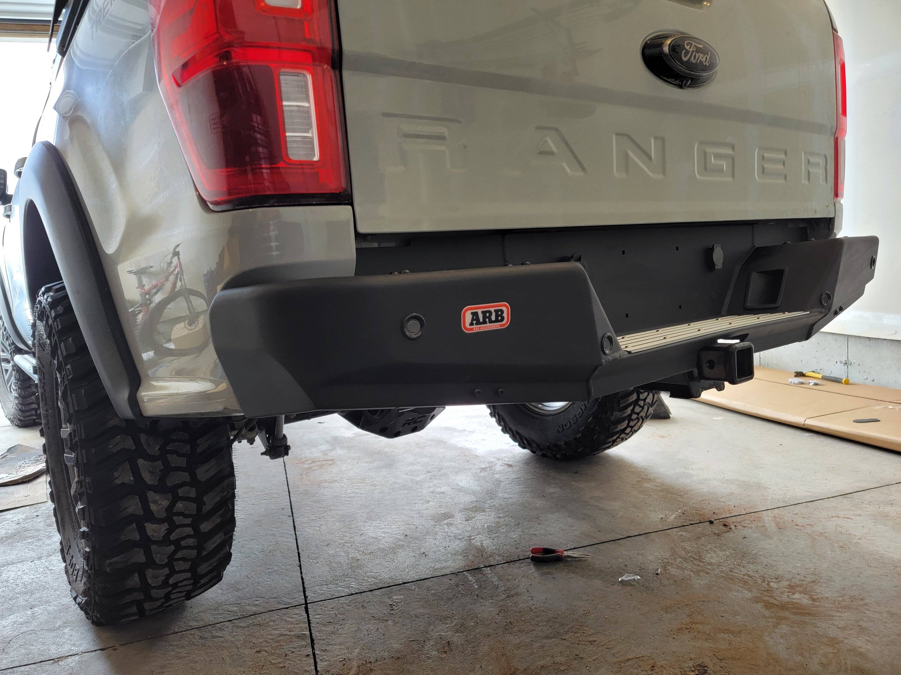

Added the rear this last weekend. Unfortunately the lower tubes are out of stock until May but, the bumper looks good anyway lol.

Definitely a preference on the optional bars. For me I'm not too sure since the Ranger had plenty of clearance with the Old Man EMU lift.

Yeah I ordered the tubed because even with the add a leaf and fox shocks I smack my bumper and panels every trail I run. I was going to get a bed cut rear bumper like the coastal, but that was too involved. I think the ARB tubes will provide the protection I need just fine.
Do you have the old man emu leaf pack? I'm thinking about swapping to a full leaf replacement instead of the add a leaf. I just have limited info on the 3.1 inch lift kit

When I had my Ranger yes I had the leaf packs. I can easily tell you more with the 3 different ones.
As you know there are 3 different leaf packs. The standard, medium and heavy load. All are designed to have a lift of 1.6 inches with a predetermined load. That load will depend on what you normally carry.
The standard leaf is meant for no load at lift height. When paired with the Old Man EMU front suspension (2.4 inches of lift) I found that roughly 780 LBS would level the truck out.
The medium leaf is meant to have a constant load of 660 LBS at lift height(1.6 still). It's possible an additional 780 LBS on top of the 660 LBS would level it out.
The heavy leaf is designed for a constant load of 1320 LBS at lift height(full on tourer that is heavily loaded).
For me I had the standard leafs. I had a plan to go bigger, but never got to do so.
Hope that helps out

I've got the medium duty pack, with Decked, GFC, and a rear bumper with swingout. Perfect combo. Ride quality is astoundingly good (BP-51 too), plenty of clearance below the rear bumper, and the truck retains the appropriate rake, even when fully loaded.

Awesome! Thanks guys for the info. It looks like I'll need the medium pack.
