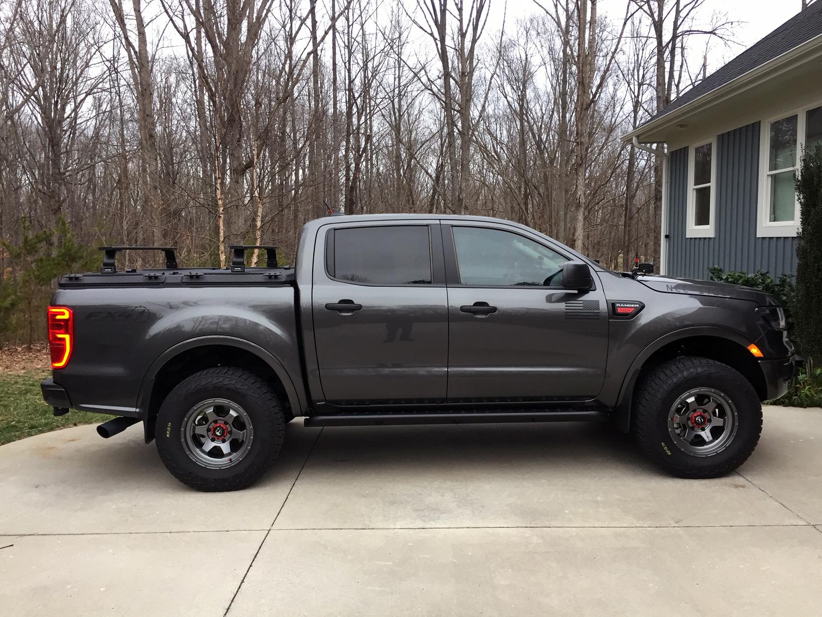

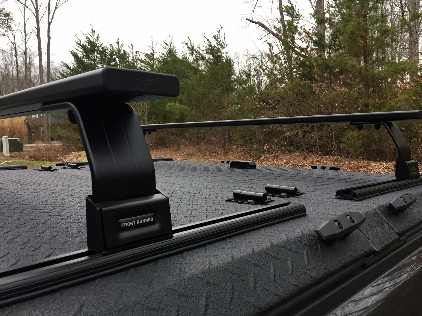

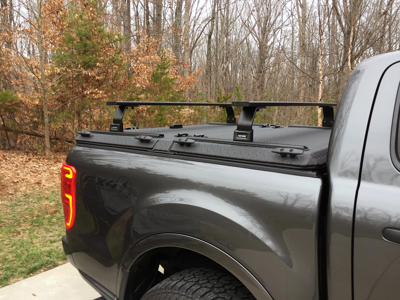

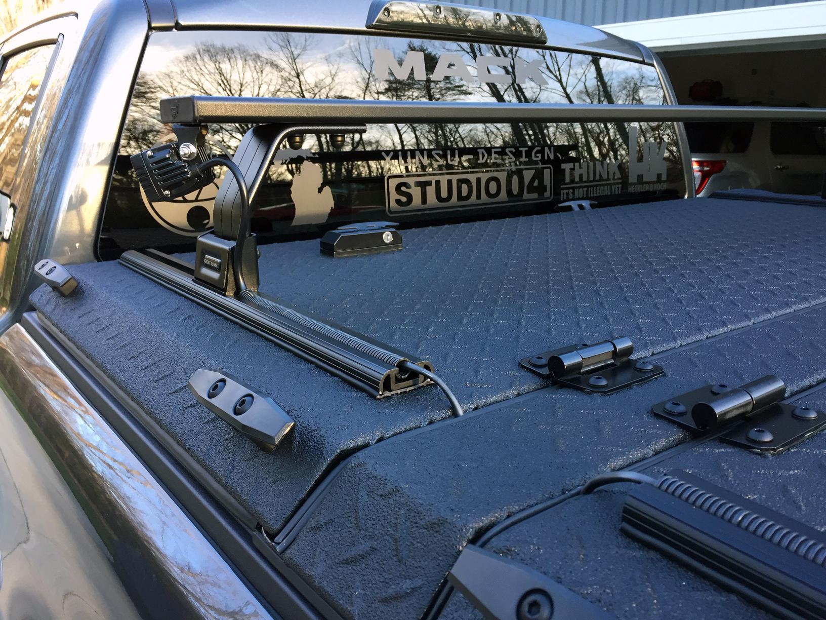

Another step closer...got my "Last Line of Defense" style Front Runner racks mounted to the Diamondback...without the RTT loaded, both hatch open normally:)

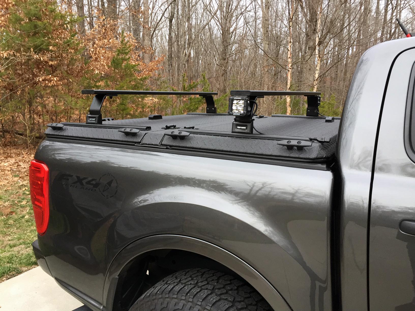

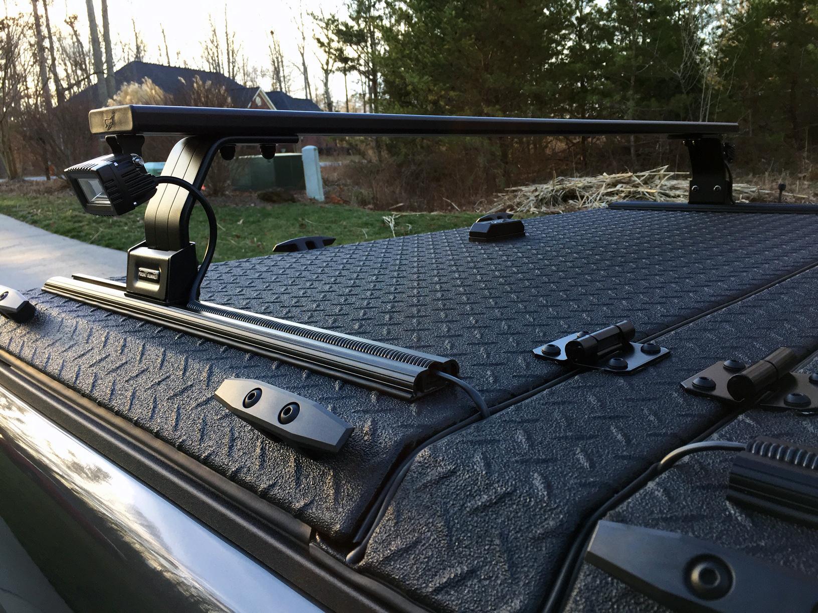

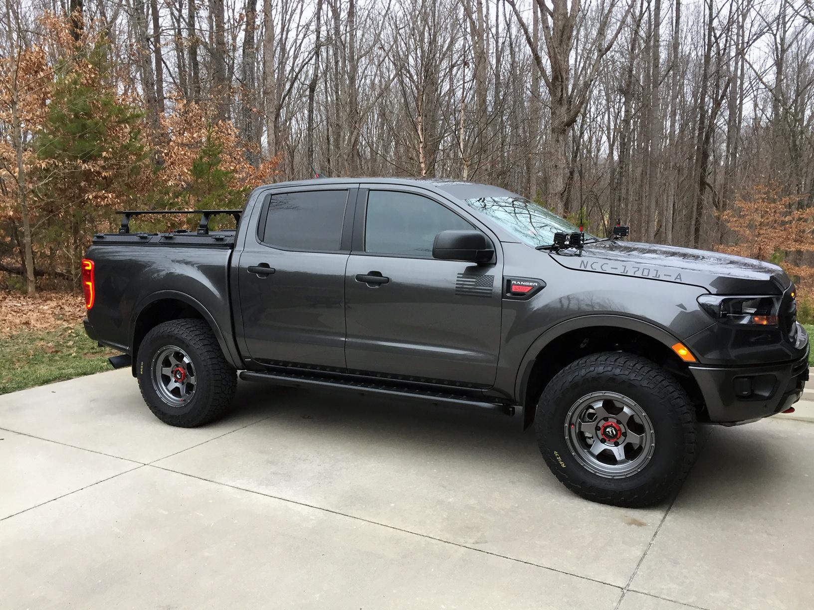

Mocked up the side floods...will need to make a bracket to extend them out a bit further so I can aim them down...

With your Last Line of Defense Racks on there do you think you could haul some eight-foot lumber with the rear hatch open and the wood sticking over closed the tailgate? Hopefully, I am explaining right. How hard is the Diamond to remove if you wanted to carry something bigger/taller?
9,229
28,565
NWO Robot Polisher
I'm guessing you could but would have to try it out and see how much clearance there is...sorry but I don't have any 8' lumber though. The hatches themselves are advertised as being very easy to take on/off in under 30 minutes. Having installed it myself, I believe that. If you're just taking the hatch off, that's like a 2 minute job to slide them off. To remove the center support bar which is secured by 4 C-clamps, would take a few more. Getting them back on should be just as quick as long as you've marked where they go so you don't need to spend time re-aligning the assembly. Hope that makes sense. If not, there's tons of Youtuber showing what I'm talking about:)

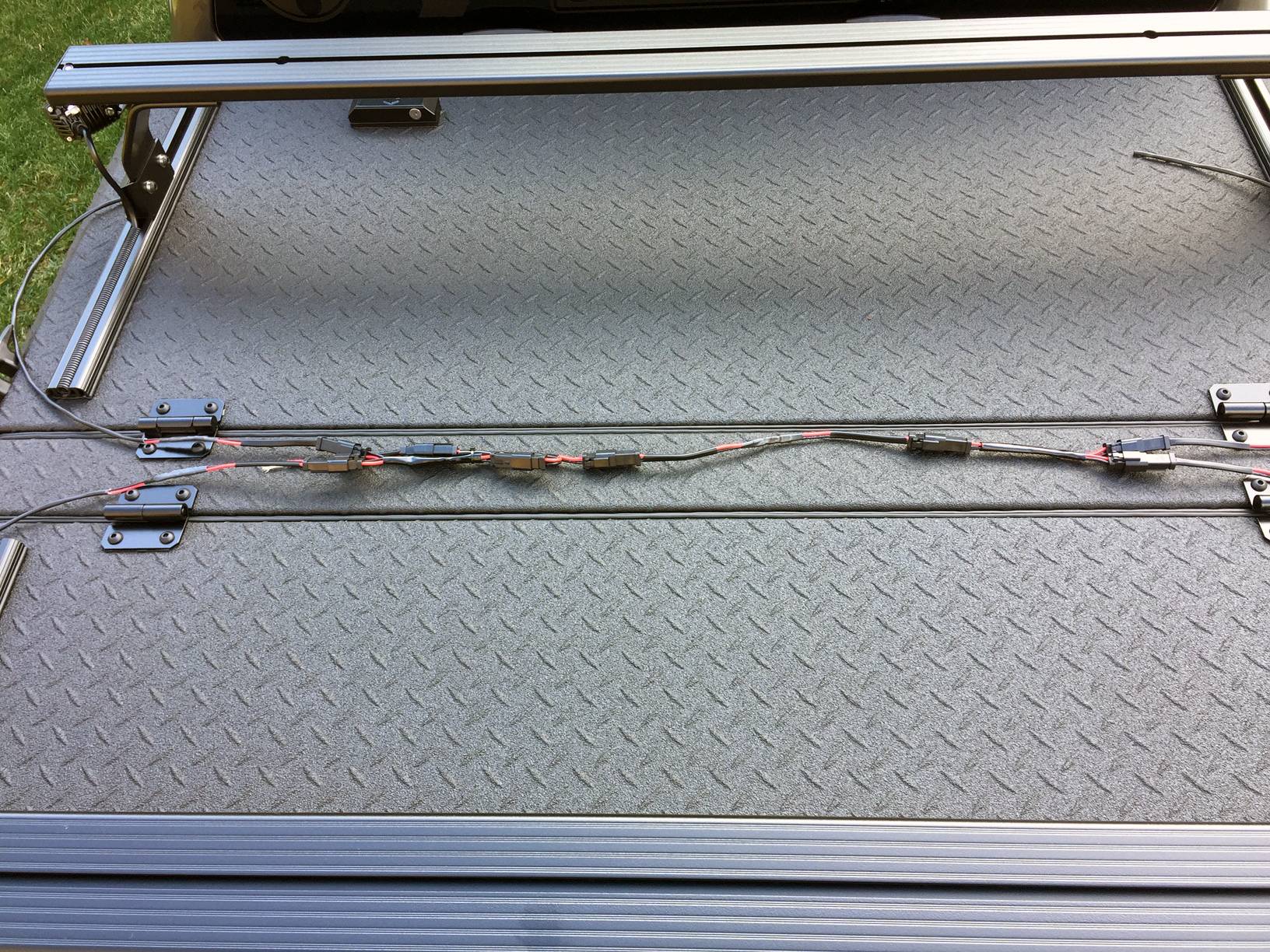

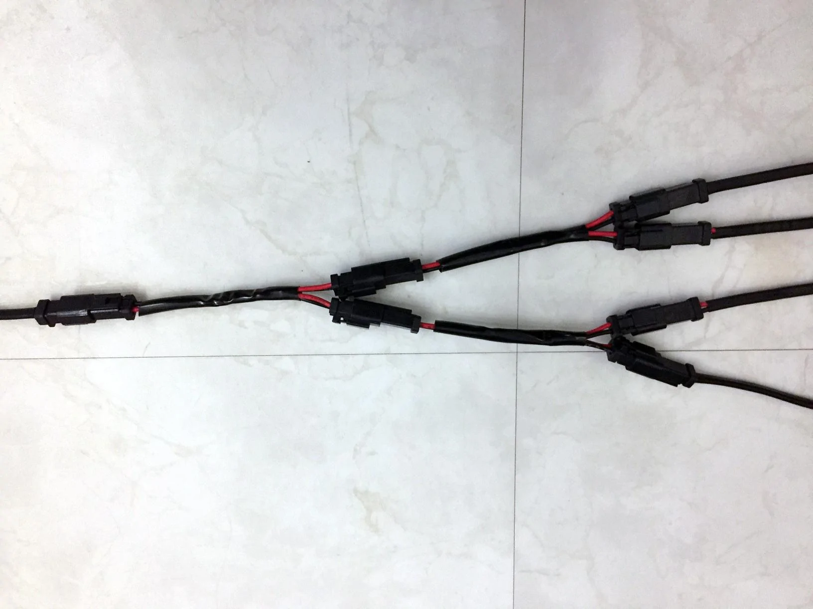

Custom harness set up...they'll be attached underneath in the position shown then a bit of final soldering, wait for darkness and then aiming...:)
9,229
28,565
NWO Robot Polisher
Power connected...cables run under the seals allows the hatch to open normally...I can still remove the entire hatch by quick disconnect Deutsch connectors... still too light out for aiming...

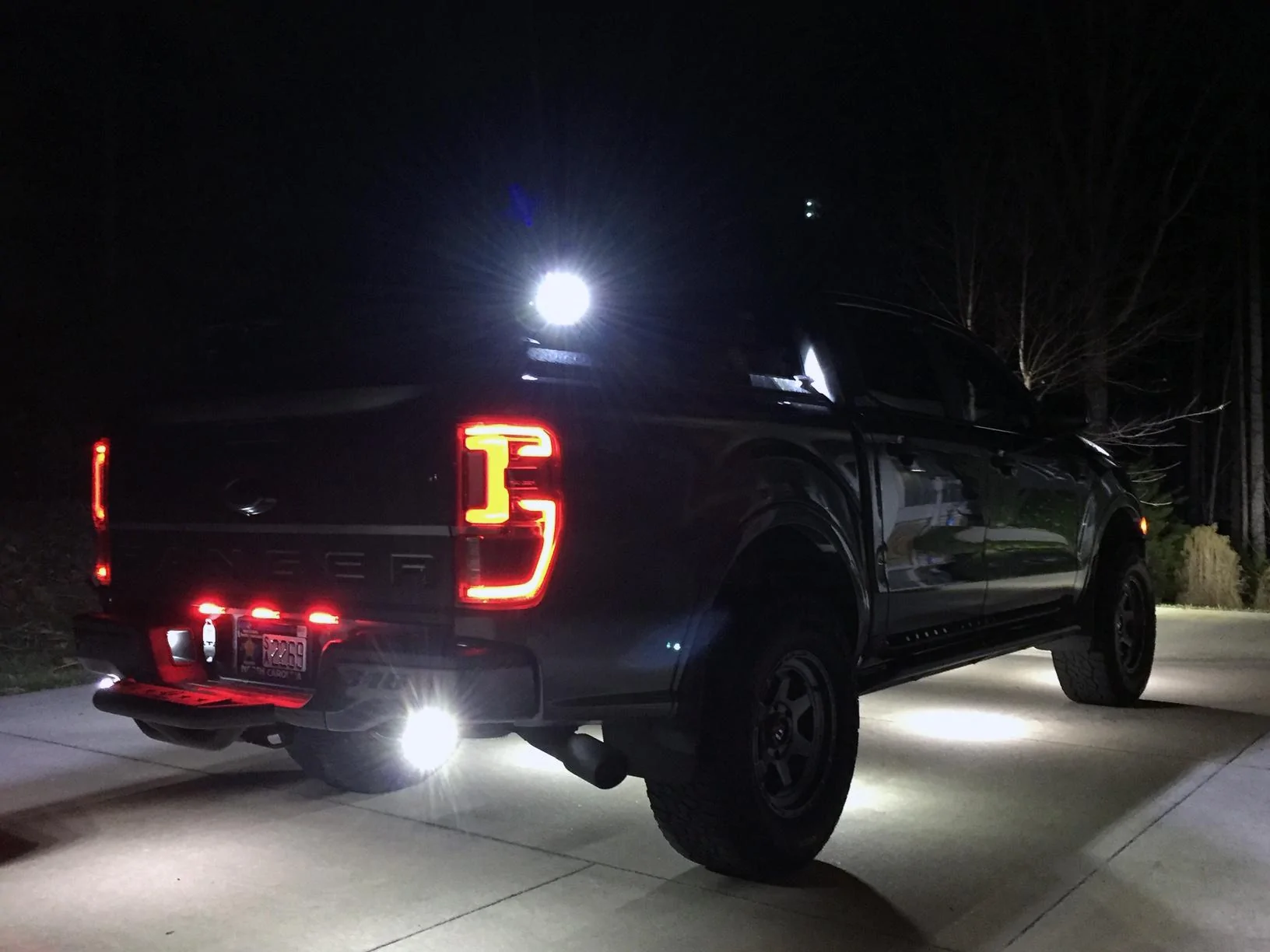

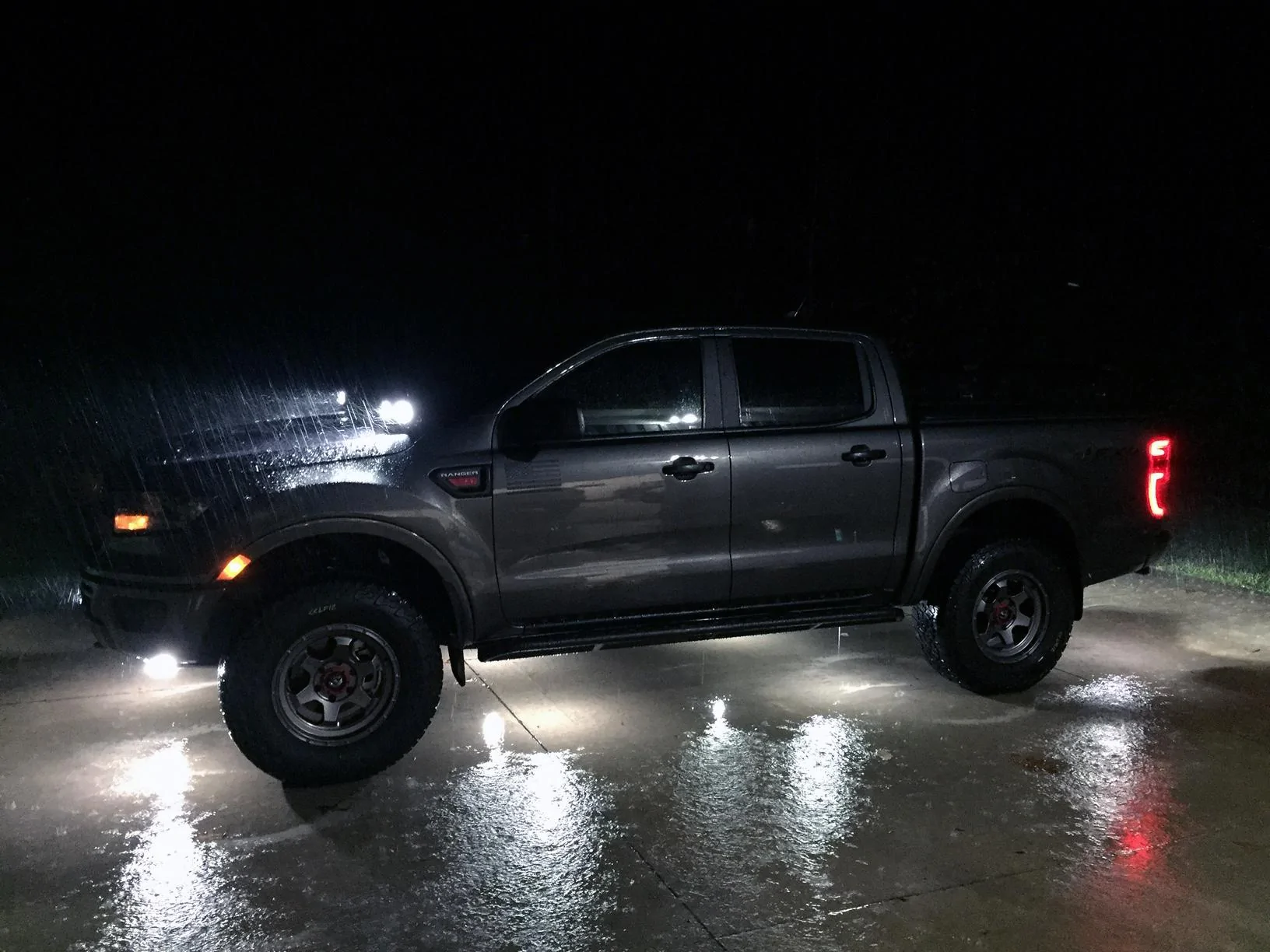

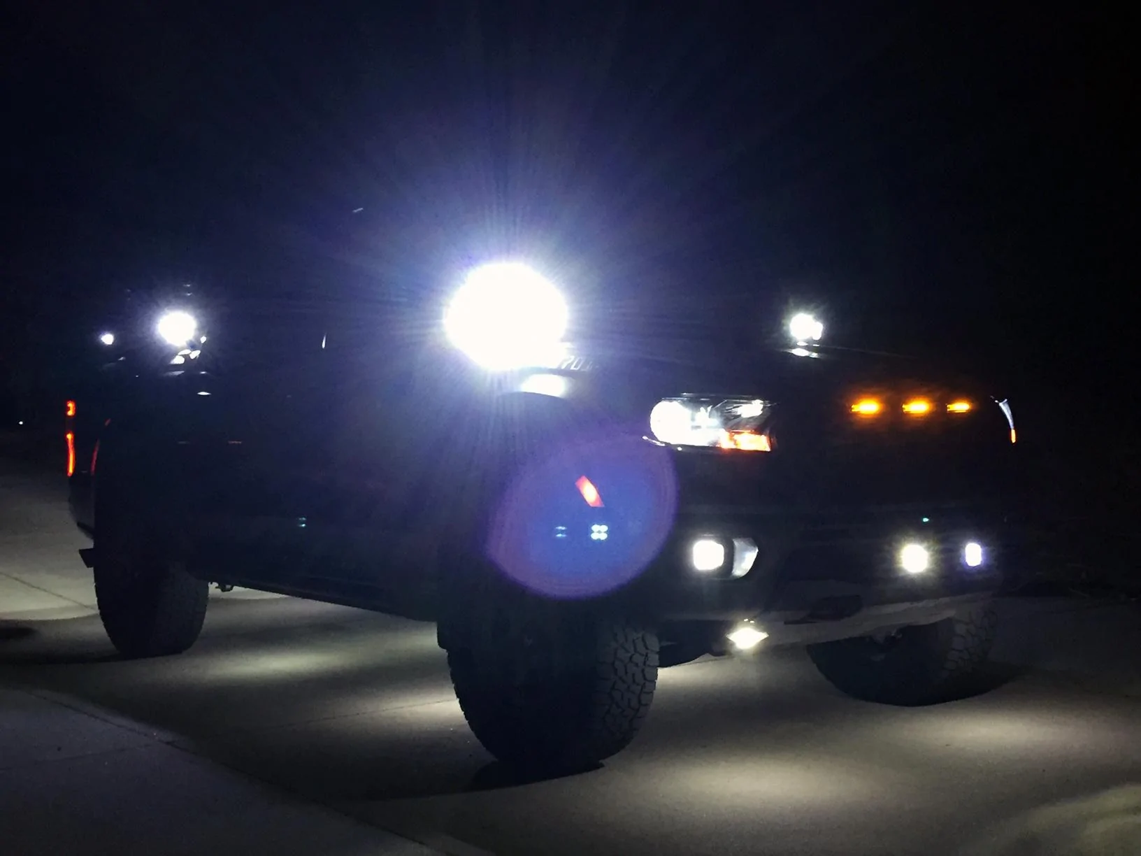

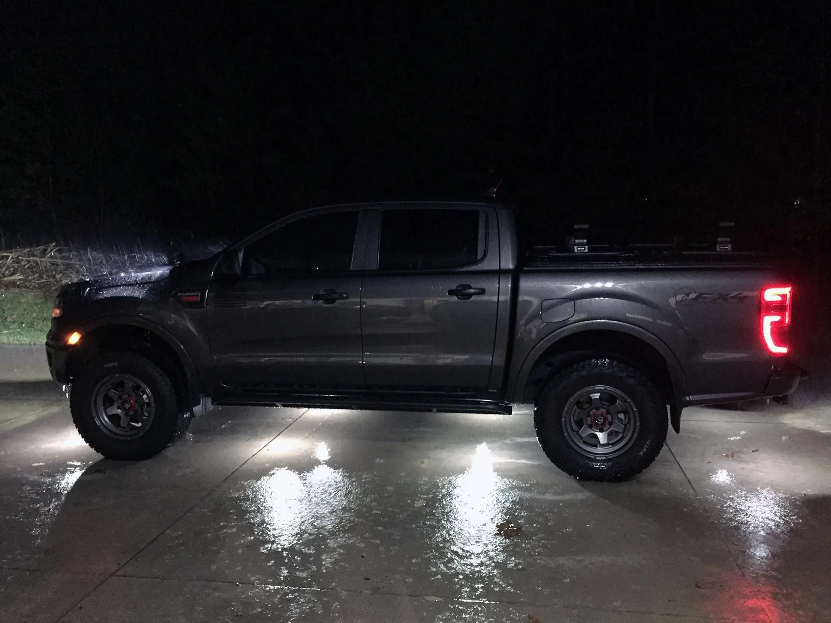

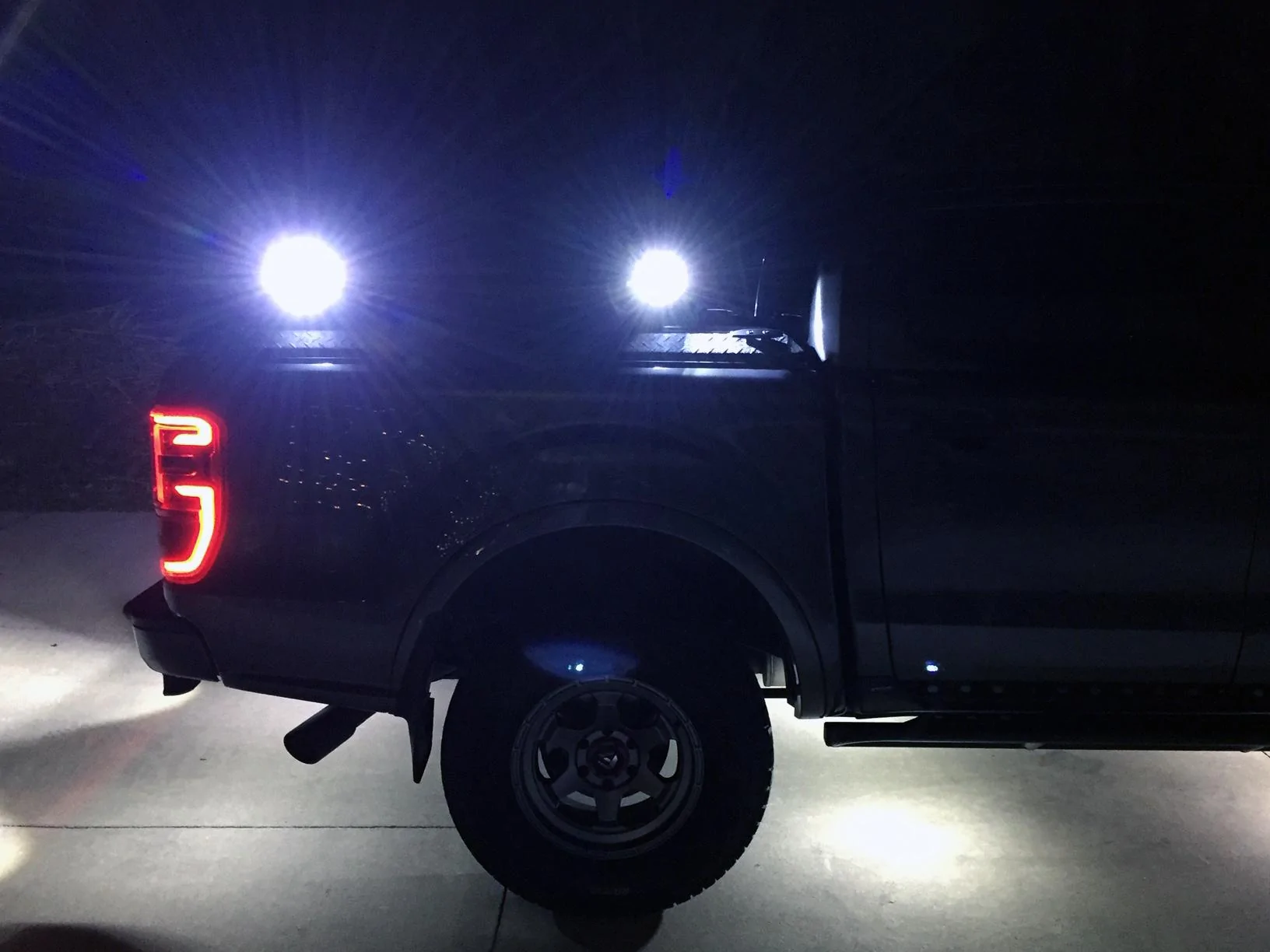

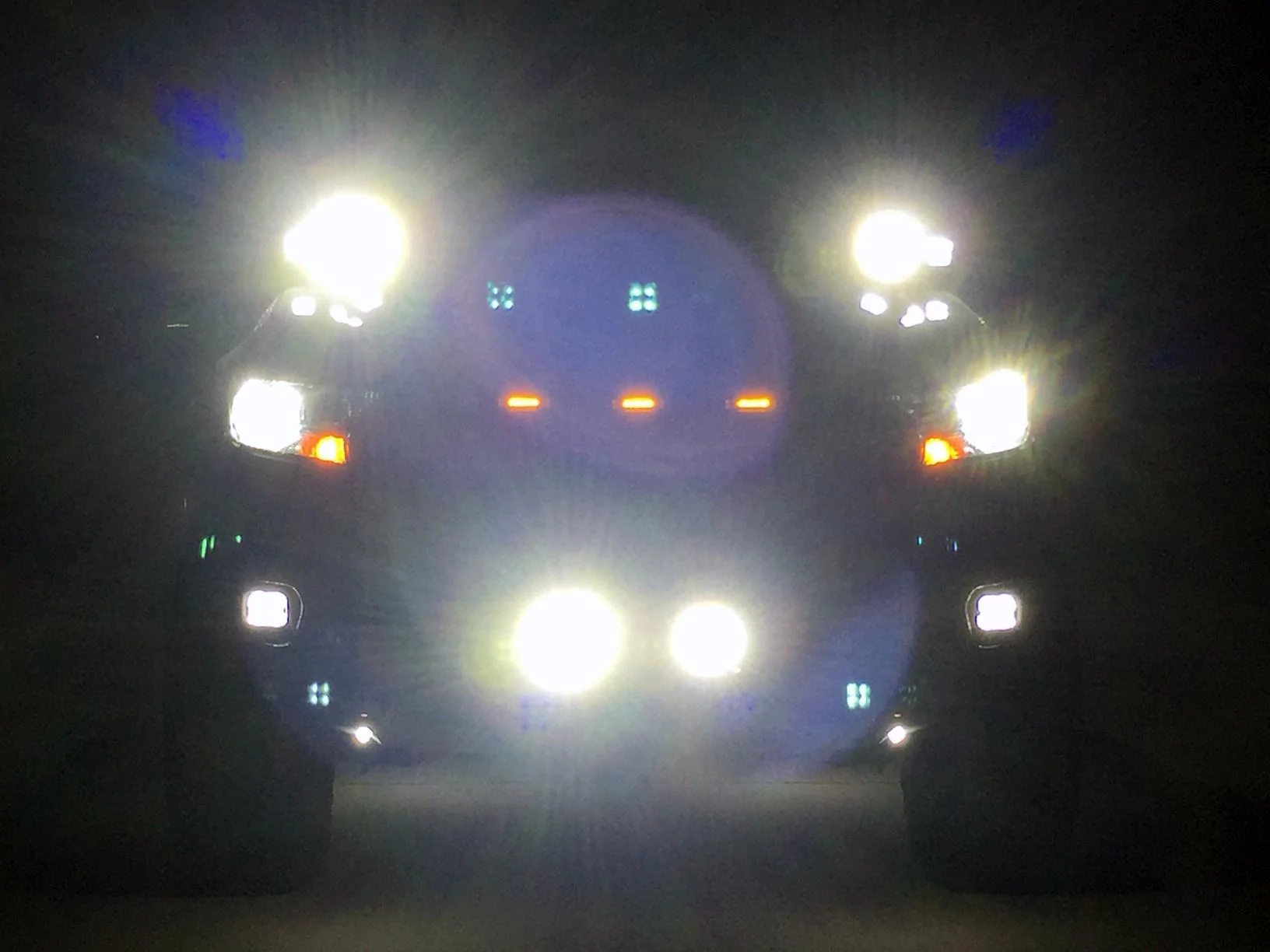

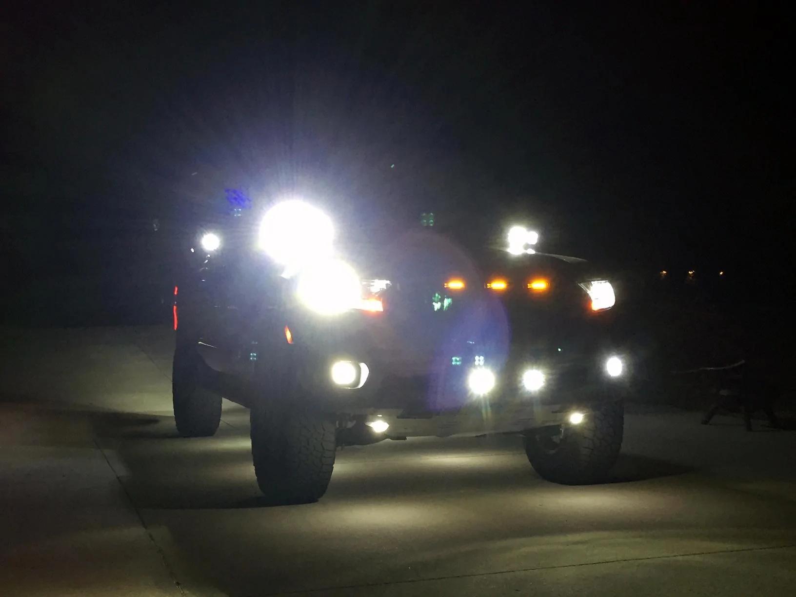

Let there be light! Sorry for the blown out pics but I think my iphone's found it's limit...I could barely aim the phone while being blinded LOL...reminds me of something from Spielberg's Close Encounters...especially when I had them all in flash mode:shock: That about gave me a epileptic seizure :giggle:
That's it...all 6 switches used up and I have no further need for more light:fingerscrossed:
