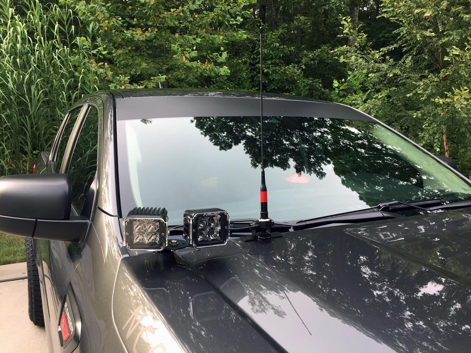

I'm trying to keep things low so my antenna is currently clip mounted to my hood which is why I'm looking for a pass through. Another thought is to see if there's a way to route the cable through the fender between the hood and door. This is a shortwave antenna.
