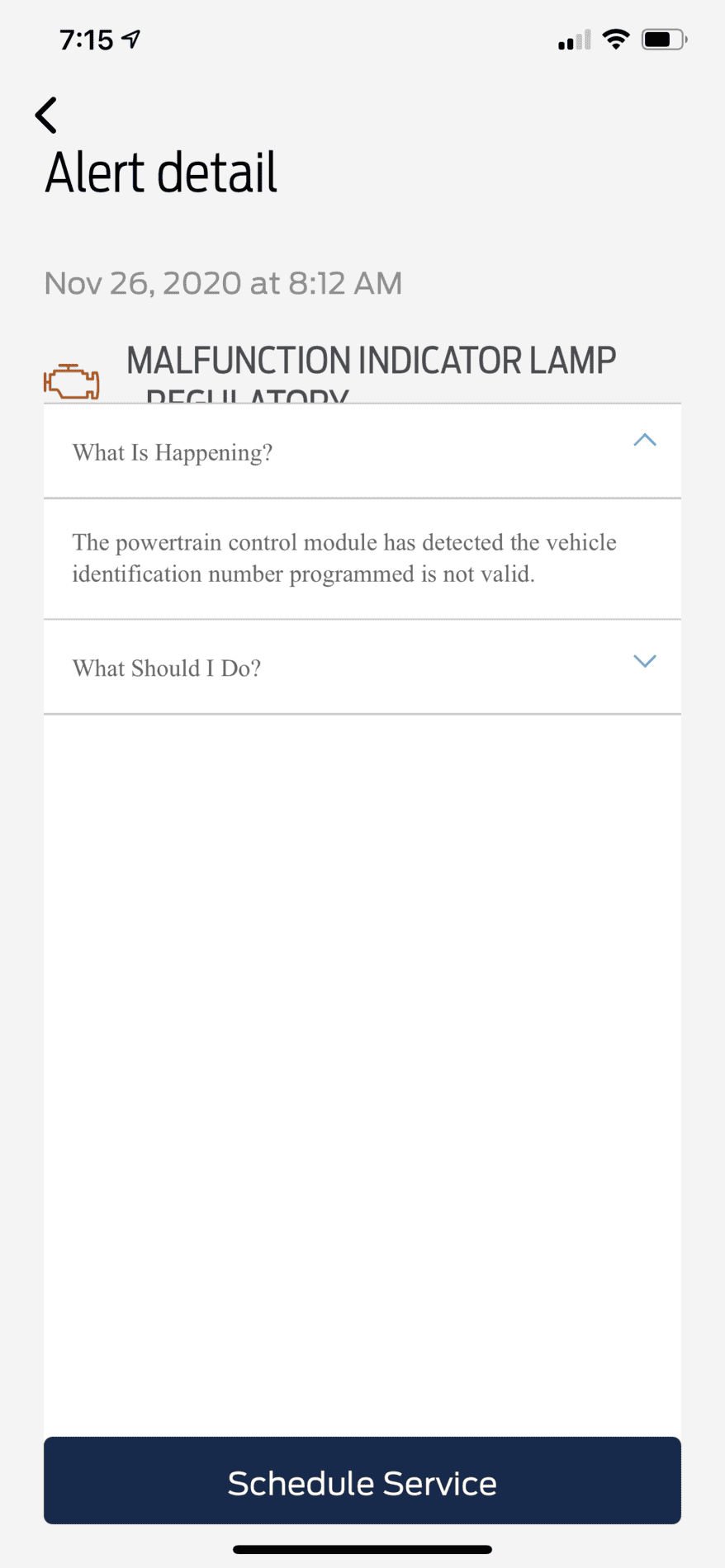

Power train control module has detected the vin profaned is not valid

This message popped up, after enabling hill decent control mod on FORScan. Has this happened to anyone else? Vin in abs module matches trucks. Set it back to factory code is still popping up. Any hints on how to correct?
