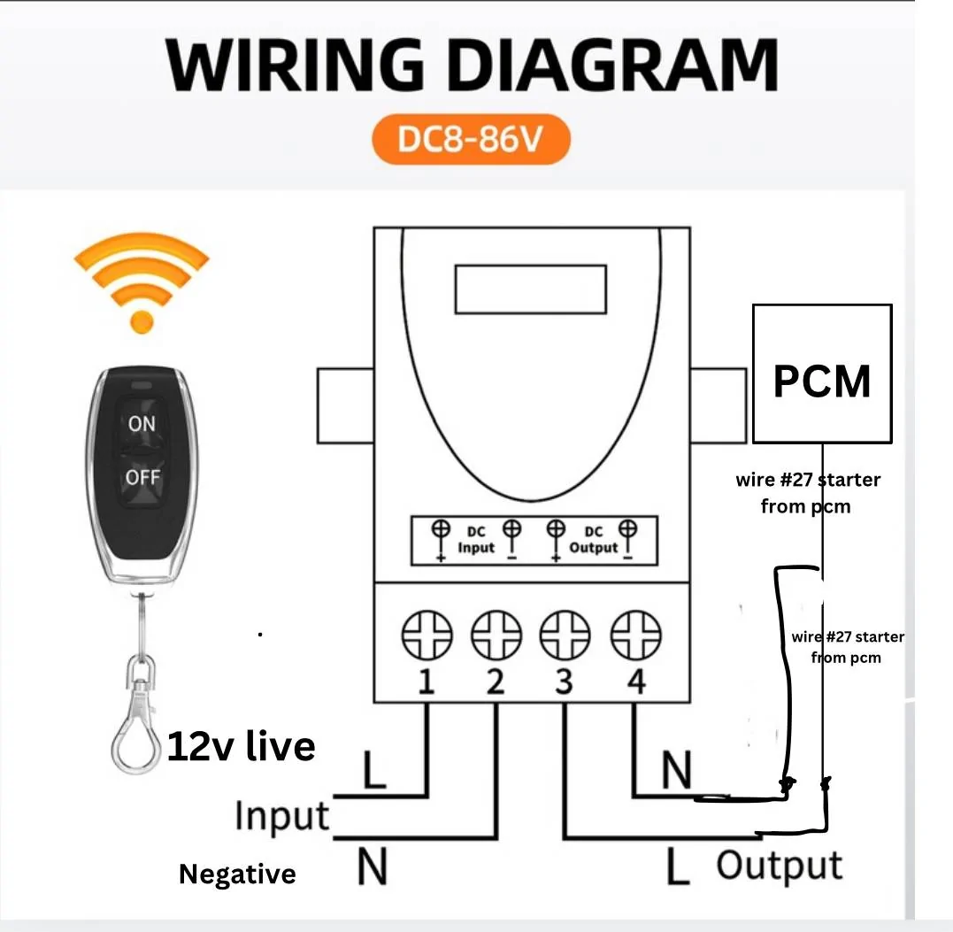

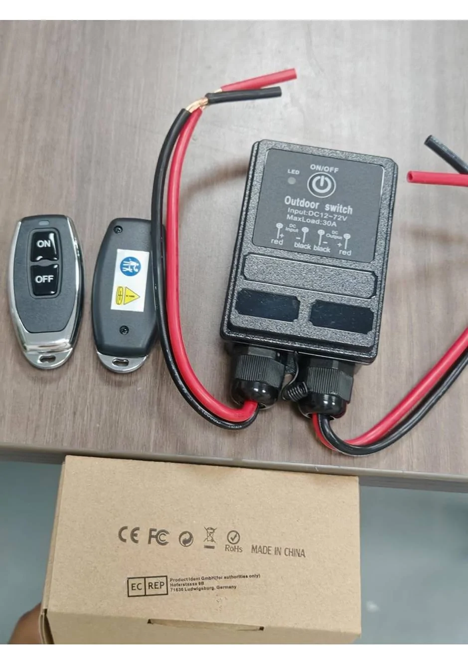

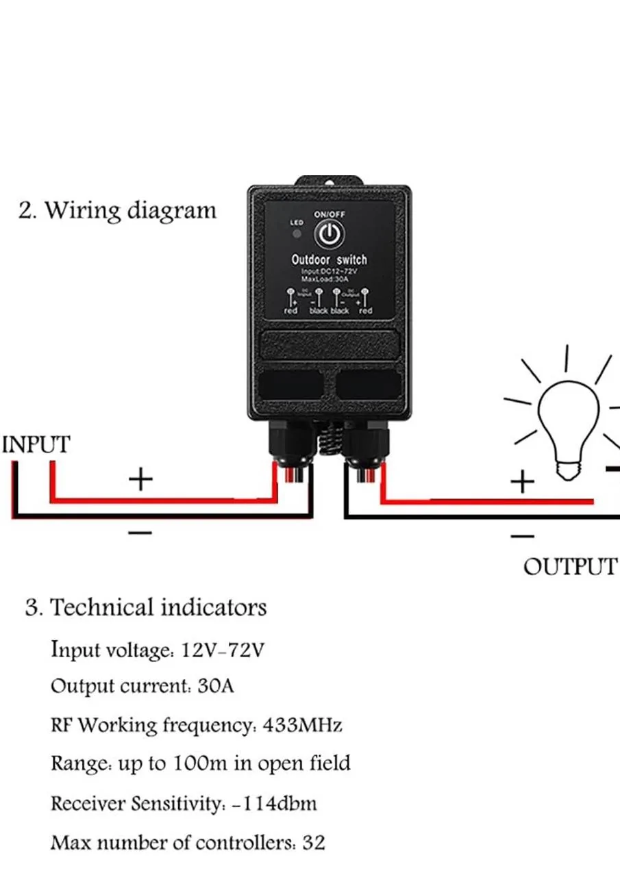

This is the exact unit I’m using
I have live to relay from the gps/kill switch with two middle pins to the cut #27 starter wire
White wire on relay to live 12v positive
Red wire from ct23 gps/kill switch to live 12v positive
Negative to car from the tracker device
No negative on the relay
Green wires on relay to cut #27 pcm wire
Yellow wire to control of gps/kill switch I’m guessing that’s the trigger wire to give command once you text it
That’s how the current set up is
So I’m just wondering what I can use to make it a remote controlled switch
I can draw a diagram if that helps?

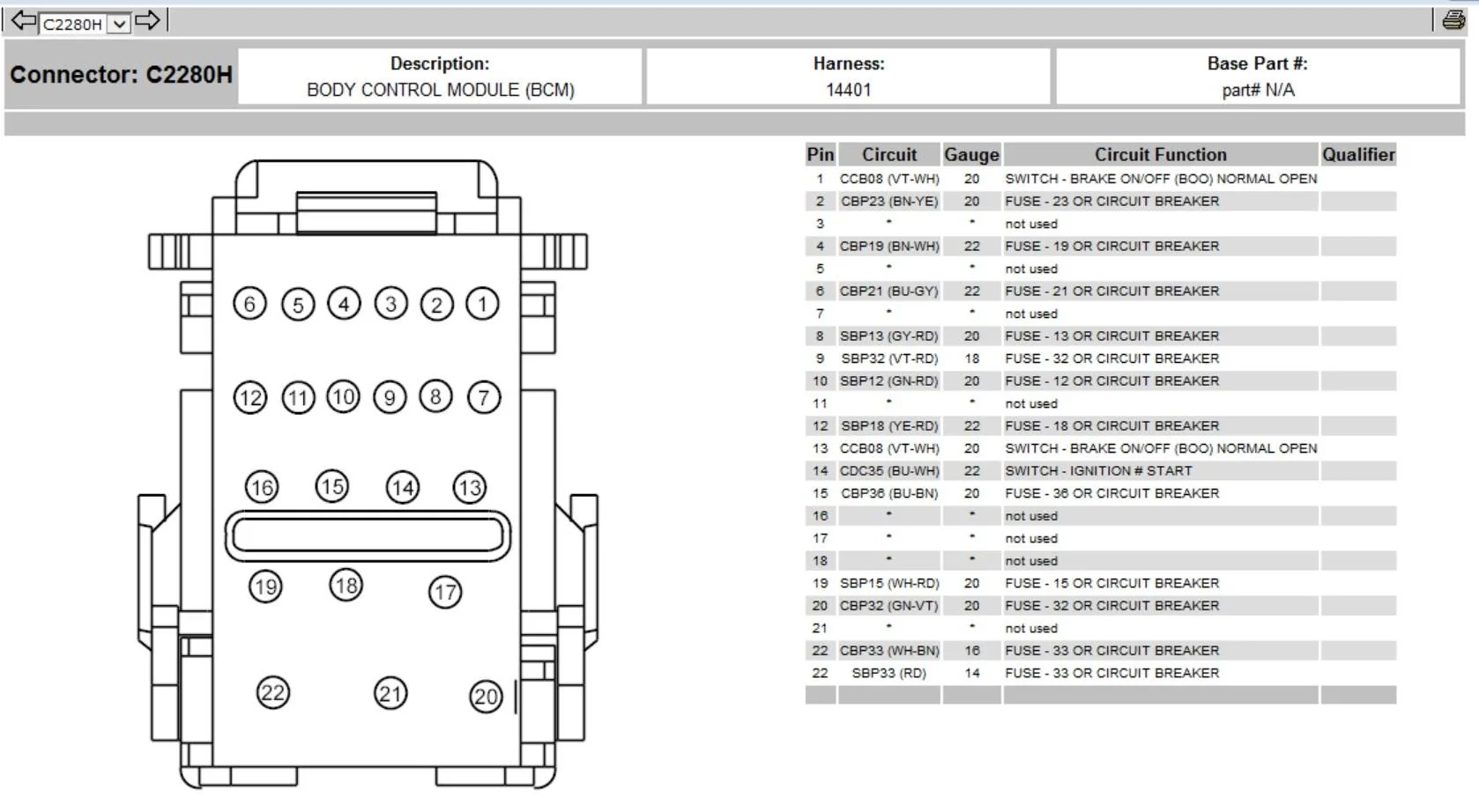

I would have to see how they want the relay powered - Coil Side for the Tracking Device
As a simple (Toggle / Rocker) switch will act as a (Kill Switch)

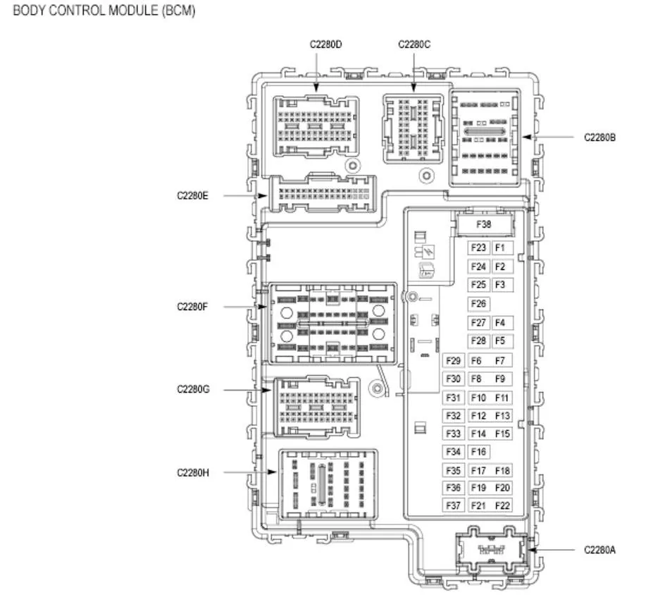

You would have to tap into either the PCM (C175) or the (BJB-C1035A) to get the wire feed you want.
Then very carefully as it is a tight clearance fit (just above the brake pedal is a wire harness run from the engine bay into the cabin) and I think there is a body plug just under the driver's floor mat where you could run your wires, just ensure its protected (harness tape and loom) as its exposed to the elements if you use the floor mat route.
Note: C1035A = I/B Connector

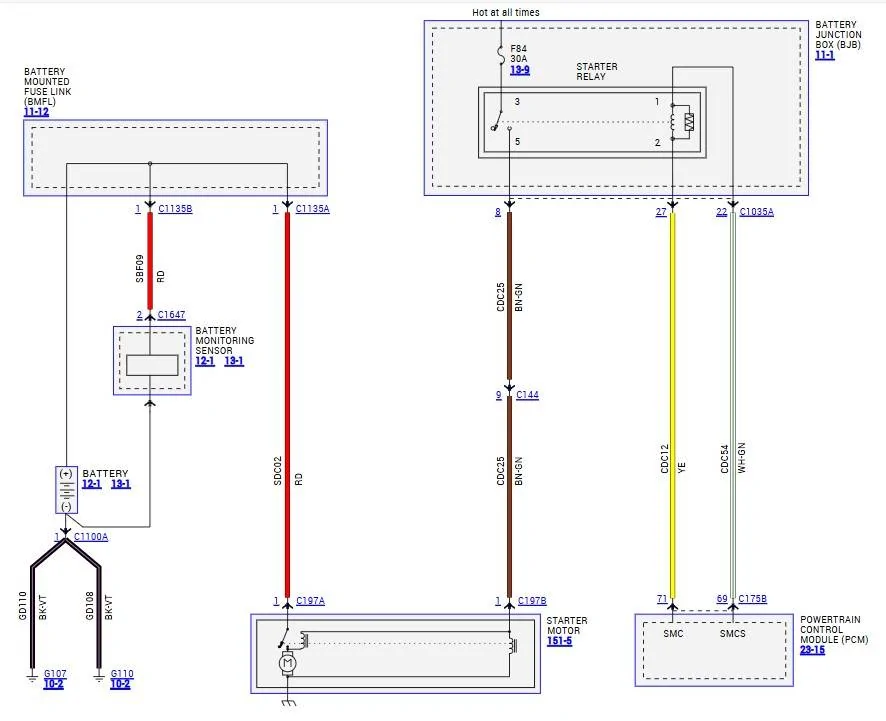

C1035A - As viewed from the connector face, you want Pin
Pin#27 = Starter Motor Control (Yellow)
Pin #22 Starter Motor Control (Sense) (White/Green)
I am guessing (as the manuals are not clear) is that Pin #27 is the Coil Power and when a start request is sent (Pin #22) opens the path for ground to complete the circuit, thus closing the coil and allowing the starter motor to power.
So simply cut and install a (switch) on either wire, run 2 wires into the cab and hook to both sides of the wires you cut.
With the switch engaged (circuit is complete) with switch (dis-engaged) circuit is open
It may be hard to find a (wire run) in the harness long enough for a good spot to (tap into and work)
