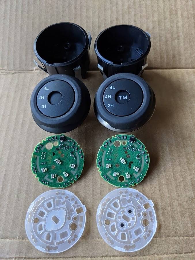

@airline tech Yeah the only data out of the US switch is on the can bus (HS2), I don't even think the US switch internally knows where it is. I think it just signals that the rotary knob was turned left/right (-/+) and if the TM switch was pressed, it listens on the can bus for what it should indicate. So, no real way to direct re-pin the ROW Ranger to support the US switch. As mentioned, it could be done if someone was really wanted to build a module to "rosette stone" the two systems.

As I posted in one of my previous posts, you can get little computer, like a raspberry pi or Arduino, and use a can bus shield attachment for it. But you'll still need to design all the circuits to replicate your switch to the truck's original expectation and the controlling logic to receive and send the proper can bus signals from the rotary switch and potentially other systems of the truck especially if you're trying to use the integrated TM switch.

i found this foto from here : https://www.ranger5g.com/forum/threads/terrain-management-upgrade.4901/page-23
