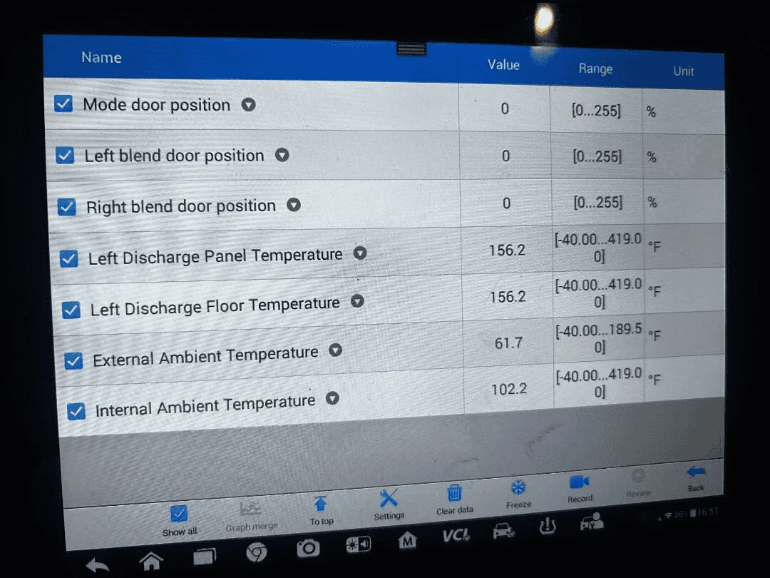

Copy and Paste from Previous Threads:
To highlight operation of the doors.
In Heat operation they open
In AC Operation they close
These PID's are from my Autel Scanner, I do not believe Forscan will display these Pids
Yet - Anyway
Notes: For T/Shoot
Mode Door Position: (Normal Readings as Follows)
Defrost = 100%
Panel = 0%
Floor = 50%
Blend - Panel/Floor = 25%
Left / Right Blend Door (This is the Temp Actuator/ Door) Position, this will check max travel open and closed.
Any selected temp in between the (percent) will vary.
Hi (Heat) = 0%
Lo (Cold) = 100%
Left Discharge Panel Temp / Left Discharge Floor Temp
These temps will vary but should be close to each other, if mode is placed in Blend (Panel/Floor) if you wait about 5 minutes or so the temps should be near equal.
External Amb Temp - Should match OAT Temp, using your phone etc.
Internal Amb Temp - This is the Temp/Humidity Sensor, this reading will read high and or low, if just sitting still as the heat/cold air is rising up from the floor vents through the dash.

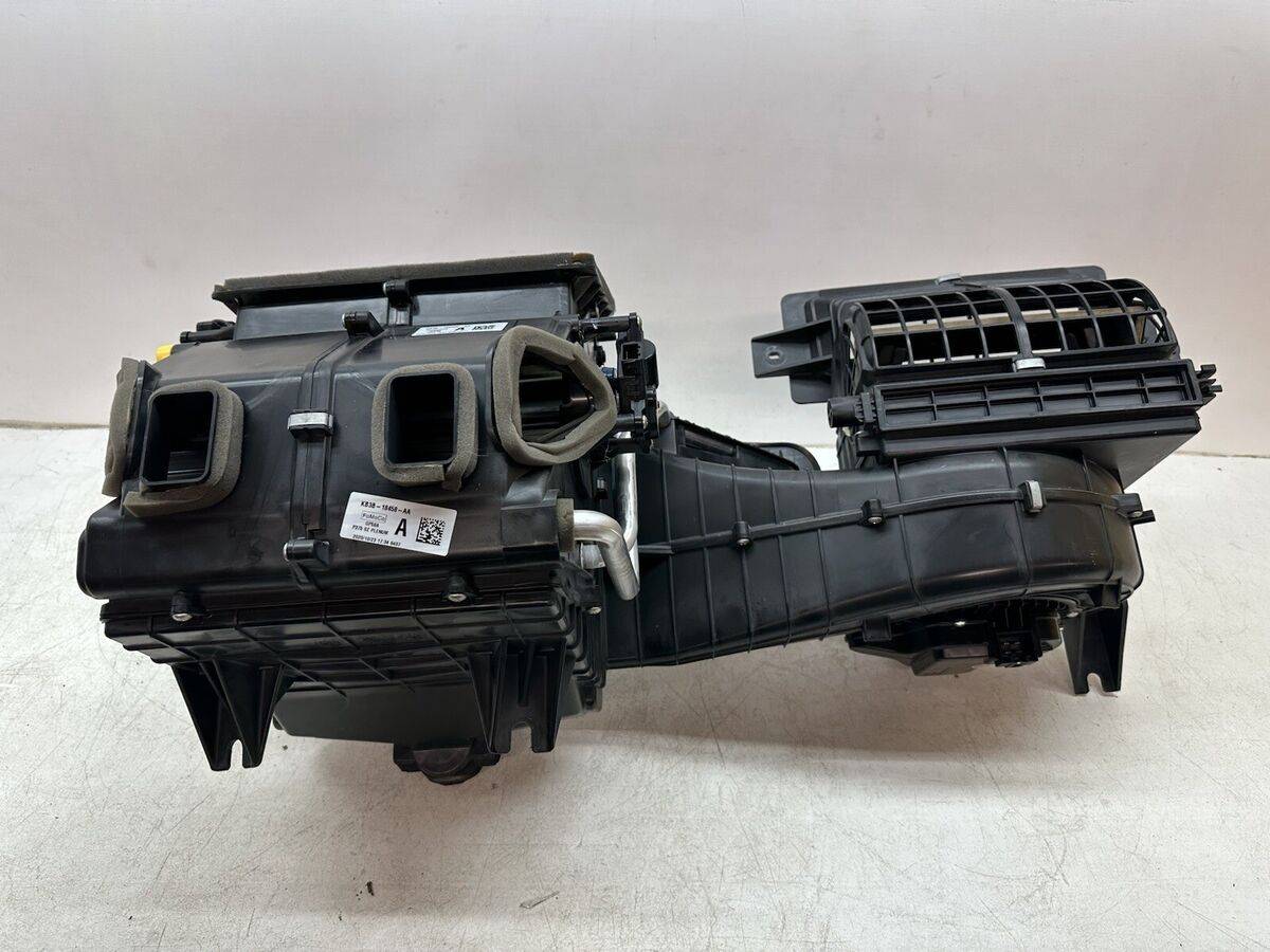

Figured id update this for anyone having this issue in the future. I just received a message from the dealership and I was told that they have gotten approval to replace my "evaporator case" under warranty. My truck is a Gold Certified vehicle, managed to get back from my trip with 422 miles left on the warranty. Hopefully when I get it back the issue will be resolved!
Good News
The latest SSM only replaces the actual problem part vs the whole assembly as above.
Still labor intensive for access though.

I took mine to the dealer, after all. They replaced the entire HVAC in dash air box, and it didn't fix the problem. I believe what they replaced was essentially the same as in the 2019 TSB. Just my luck. I suspect either a temperature sensor or whatever module is controlling the thing.
I would think a temp sensor as well.
It has 4
Drivers Panel Temp - Discharge Temp in the Duct (Provides feedback to the FCIM for output temp)
Drivers Foot Temp - Discharge Temp in the Duct (Provides feedback to the FCIM for output temp)
Humidity Temp Sensor - In Cab Temp & Humidity Reading. This is a feedback to the FCIM for actual in cabin temp, now in AUTO mode, this sensor will calculate an average overall temp based on what you have selected.
So, this means for the overall cabin temp to be let's say 72 deg, the system will adjust the passenger side about 10 degrees warmer or cooler to get the overall cabin temp to stay at 72 degrees. As measured at the Cabin (Humidity Temp Sensor) which is located above your right knee by the ignition switch. (small little vent)
Once, it has reached its calculated temp reading, it equalizes the drivers and passengers temp output. (I hope this makes sense) Think (Overall Cabin) not just per side (It's an AVERAGE - NOT EXACT)
Another way to put it (It will mix the air to get the cabin temp to the selected value) this includes pushing hotter or colder air into the passenger side which will push and circulate into the cabin and mix with the driver's side output air.
The above 3 - measure and control the temperature doors from the (selected temp on the Sync Screen) but the actual controlling module is the FCIM (Which is the panel the physical buttons are on)
Evap Core Temp - This is used to Turn Off the AC Compressor when the Evap Core reaches 35 degrees. (keeps it from icing up)

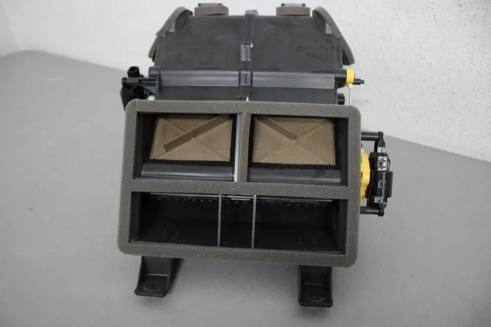

I am trying to understand how the system can have Panel Air on the Driver's side and Floor Air on the passenger side. There is only (1) mode door actuator.
Hopefully when (quangdog) replaces his and posts it opened up, we can see if it is actually separate doors being driven by (1) actuator.

I have never really paid attention to airflow , difference between drivers and passenger, and the only thing I can possibly see is that the passenger air temp door can position itself to block airflow , say from the vents on passenger side while the drivers side is blowing through the vents.
Giving you the feeling that is may be routed to the floor as I just tested mine with outside temp 60 degrees and selected temp (dual) at 70- have air from drivers (panel) and no airflow on any passenger vents - dial up the passenger temp and airflow moves to the floor , dial down the passenger temp and airflow moves to passenger (panel) vents.
So my conclusion is that we only have (1) mode door to direct airflow, but the temperature door has the capability to block that airflow if needed to get the overall cabin temp as read by the humidity temp sensor to the selected temp.
So it has the ability to adjust temp (hot/cold) plus block off airflow, the airflow that is blocked depends on what airflow mode the system is in.
And the mode doors themselves are not individually operating separately.
