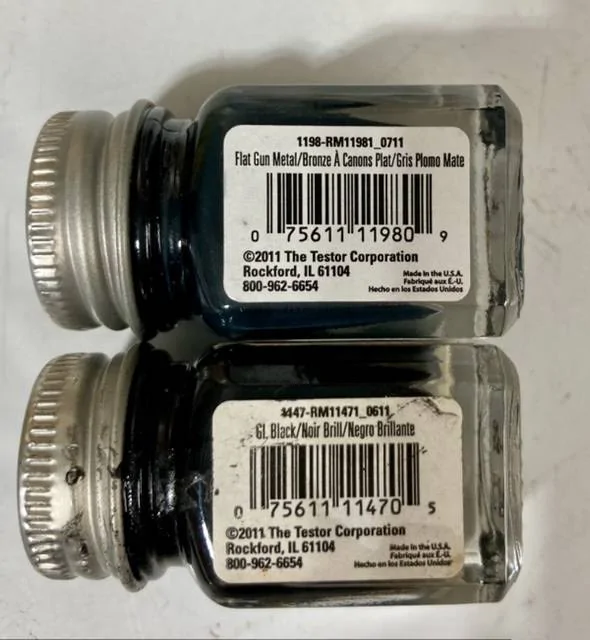

I had someone bump into me the other day on my 19 Ranger STX and what I did was took some Testors model paint flat gunmetal gray and it was pretty dang close - I then also had some gloss black so I did like approximately a 2-1 ratio and it turned out pretty exact - I’m pretty OCD with my truck so it passed my craziness test ? - these are what I used

Man, you brought me back 50yrs to the basement building models...

I Still use it on touchup of fishing lures, it's enamel slow drying but effective.
Yes, model kits brought me back too.

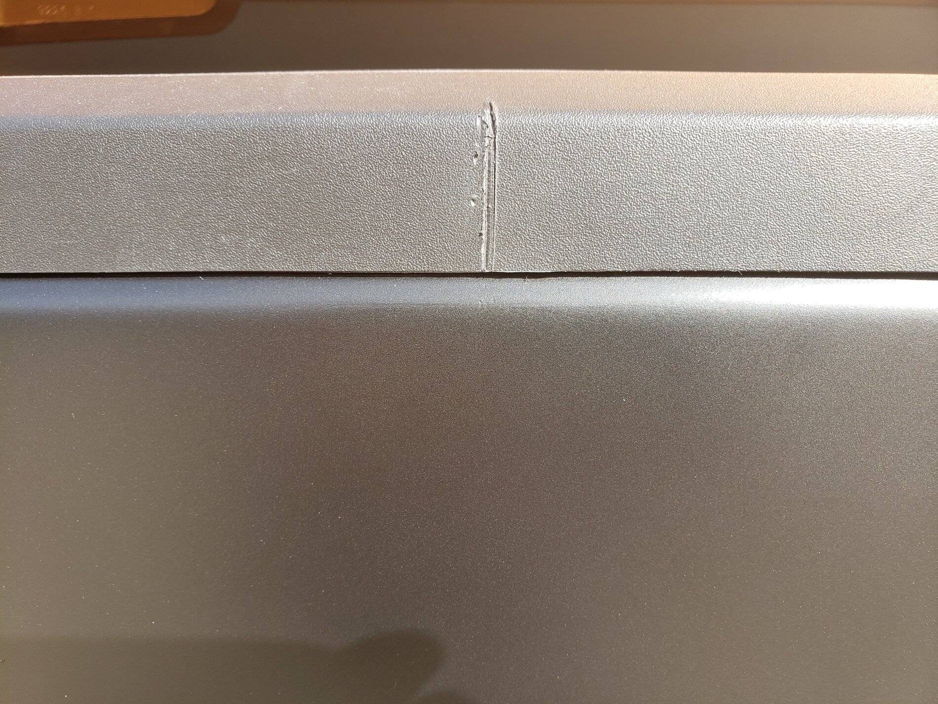

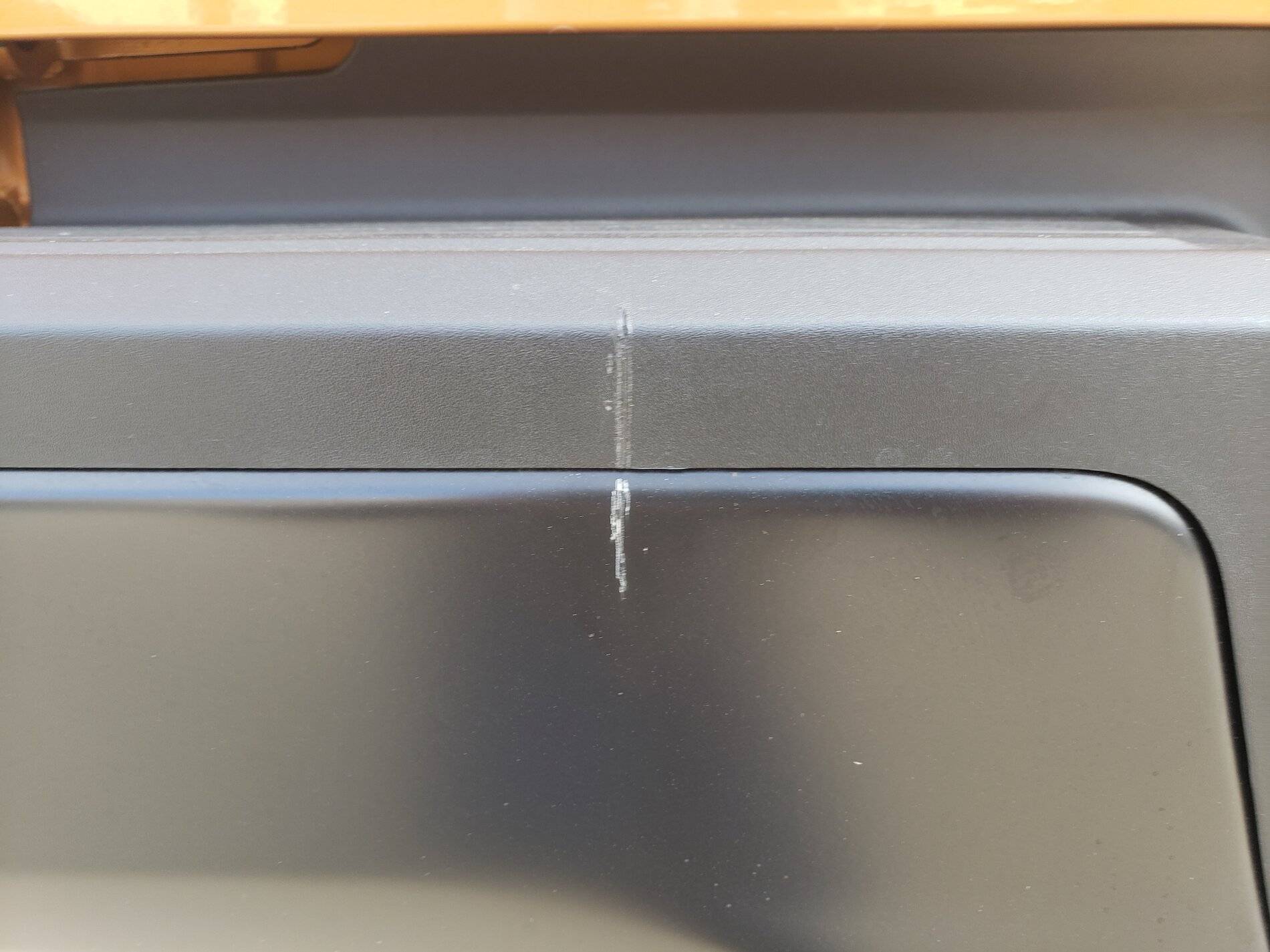

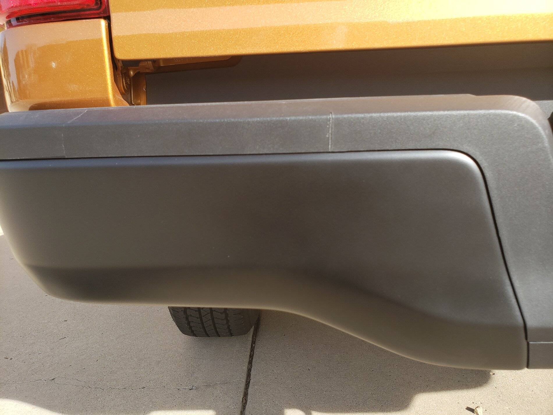

I'm not sure this applies to the same area that you are referring to (this relates to the rear bumper not the front bumper in your case) but I got a scratch on the left rear rubber part of the bumper and the metal panel below that when the garage door clipped it. I was going to touch it up but the dealer did not have a code for that particular area and couldn't find any similar touch up paint to match. Was fortunate to find a body shop to repair and re-paint the panel for 100.00! They matched the color perfectly with the panel on the right side. Left the rubber bumper unrepaired because it is not that noticiable. Hope this helps.:)

They couldn't find the paint code for Magnetic?
I'd find a new dealership.
It's J7 BTW.
