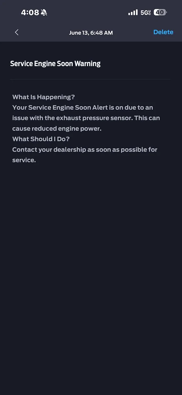

Hey all, my CEL comes on and off every week or so the last three weeks. Code: P0471 exhaust pressure sensor a circuit range/performance.
I replaced the DPFE assembly with the sensor and tubes. A week later, it's back on.
Anything I'm missing?
2021 Ranger XLT Tremor 45K miles.

I changed out the entire assembly and that didn't fix so I changed out EGR sensor and all is good.
