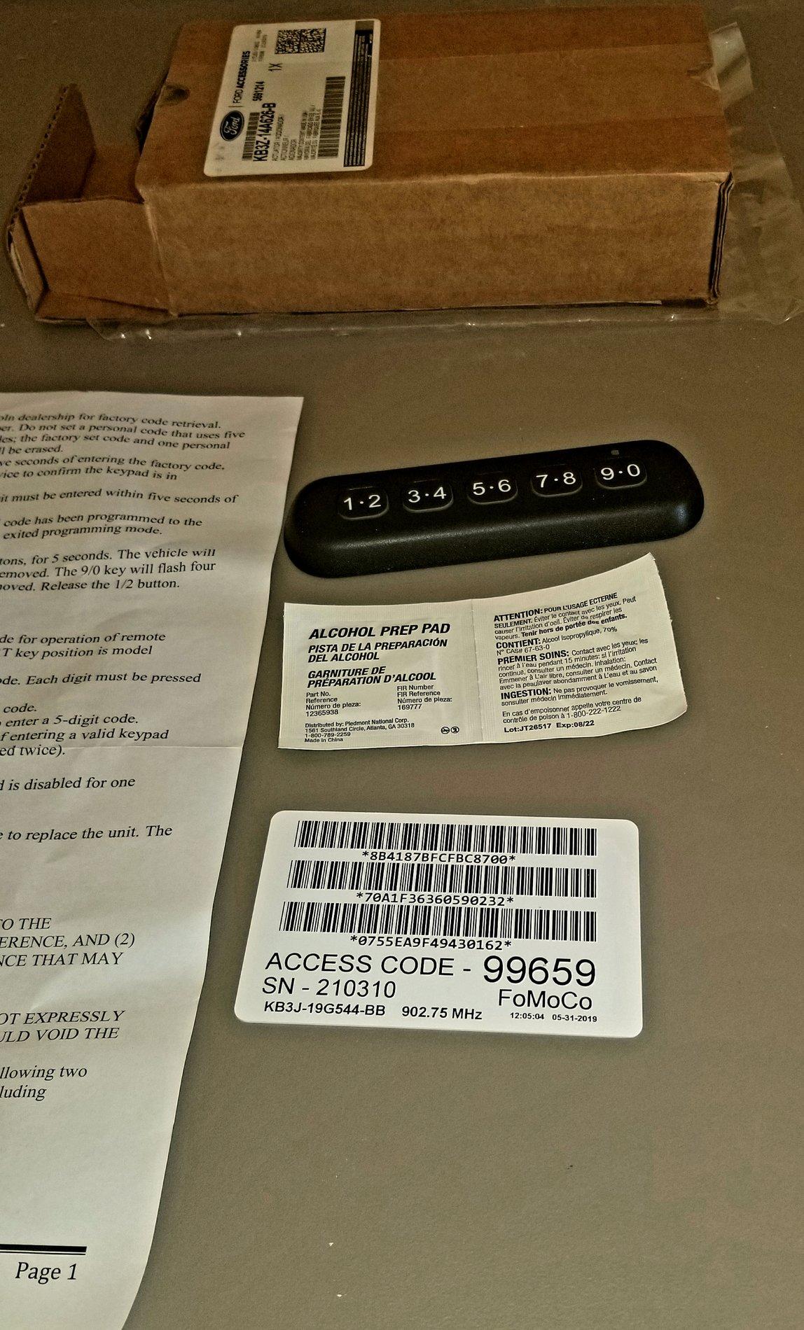

Not sure I would have posted the access codeJust received the replacement from Ford. See attached
-- Ford must program the new keypad to the Ranger or it will never work correctly.

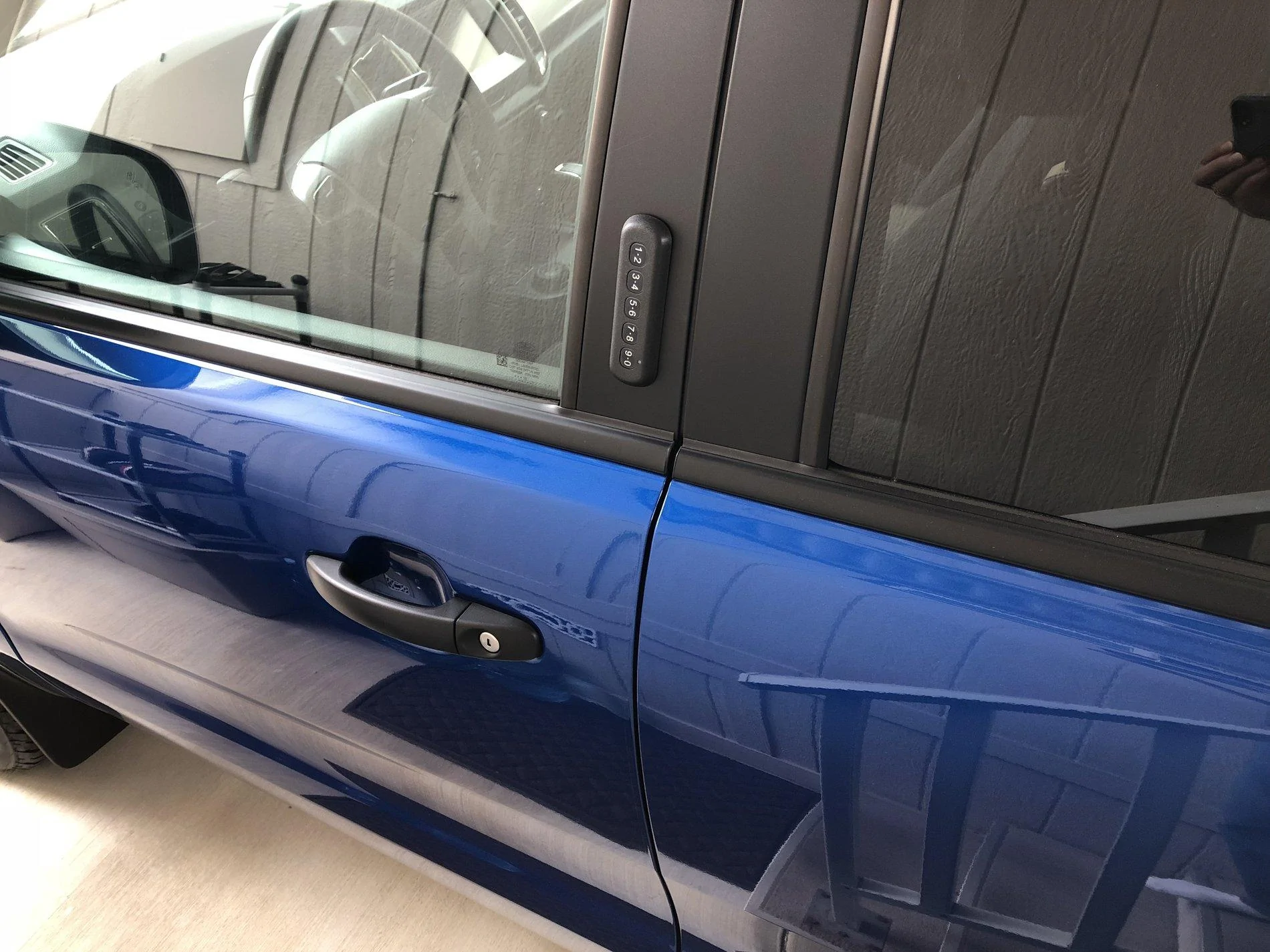

What about mounting the keypad vertically on the black door pillar?
Agreed, I like it better there than above the door handle as well. Think if I pick one up I may hide it on the inside of the fuel door like I have seen here.I just got the keyless pad and had it programmed by my local dealer. He told me I could install it wherever I wanted. It is mounted to the black trim behind the glass. I think it looks better than on the paint.

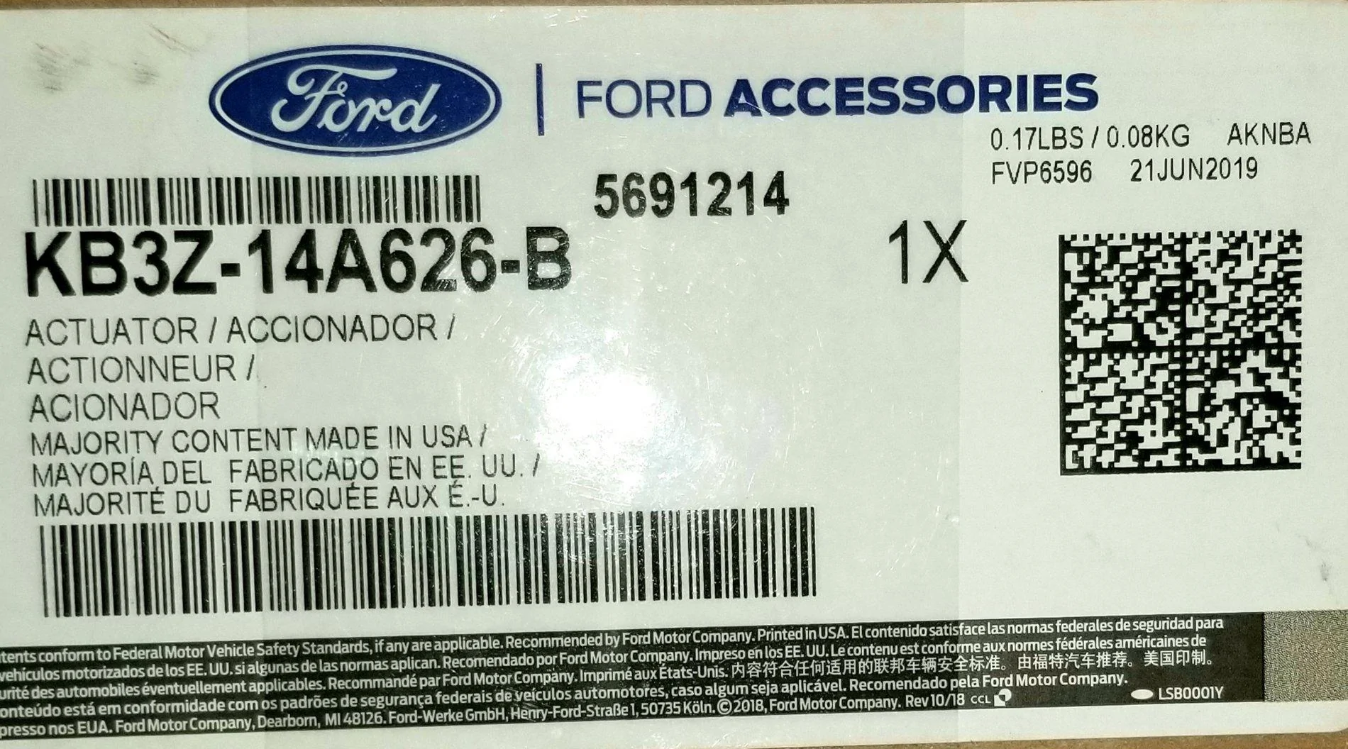

Yes you could try another dealer but make sure the key pad is still good. My dealer had a bad one that the Ford rep credited for him just the day before I did mine.I bought Ford part KB3Z-14A626-A keypad. My dealer could not program it to my truck. It sounds like my only option is to try another dealer. Any suggestions?
