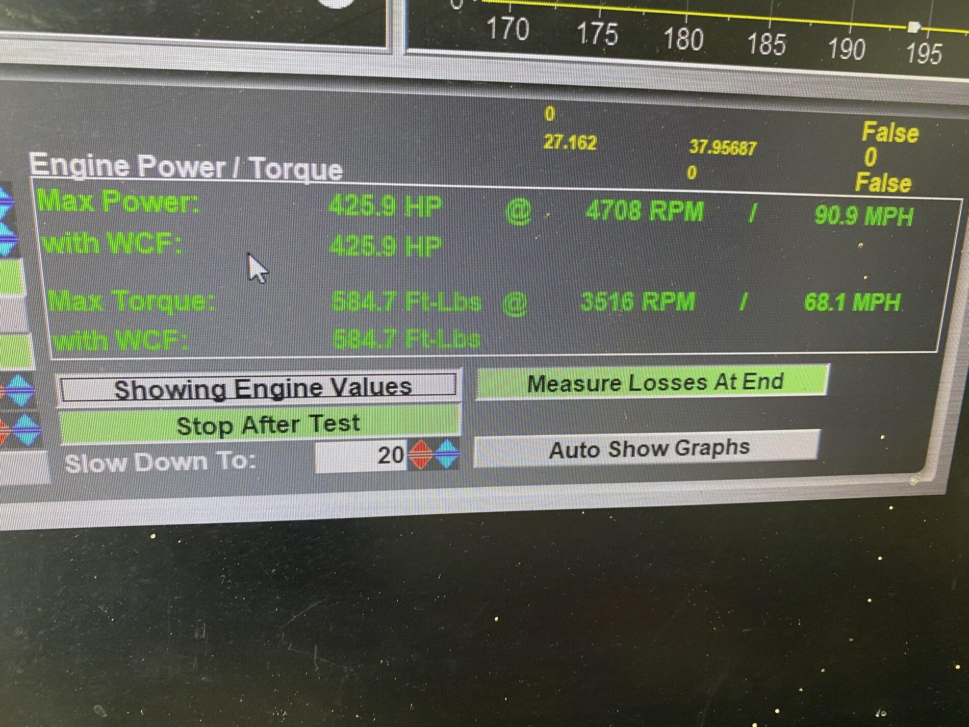

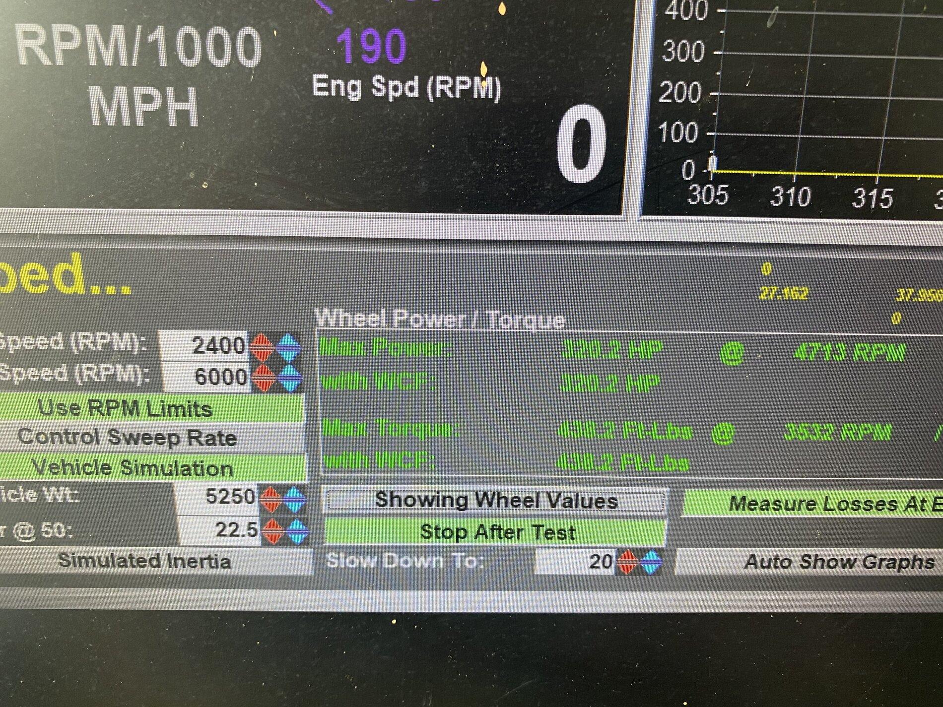

I am going to do a few Dyno pulls today. Not really going to help you but we will know the potential the truck has. I have a SPD high flow catted down pipe, full SPD exhaust, drop in K&N filter, and a 5Star Tuning 93 performance tune.

Wow! That is STOUT!

Those torque numbers seem a little off for only having a a tune and exhaust. What shop did you take it to?
I know the 5* 93 performance tune is good for 75hp and 92 tq on its own. But I have never seen an exhaust and K&N drop in produce that much additional hp/tq on top of that. Typically a full exhaust is good for around 10% additional hp/tq and a K&N is negligible with at best 5-6 hp to the crank. So by those numbers that exhaust is producing an additional 180 +/- torque. I want to say there's one of three possibilities here. A, their dyno is off. B, Ford under reported the actual numbers for the Ranger. Or C, if accurate that's an insane increase and the factory exhaust is incredibly restrictive.
