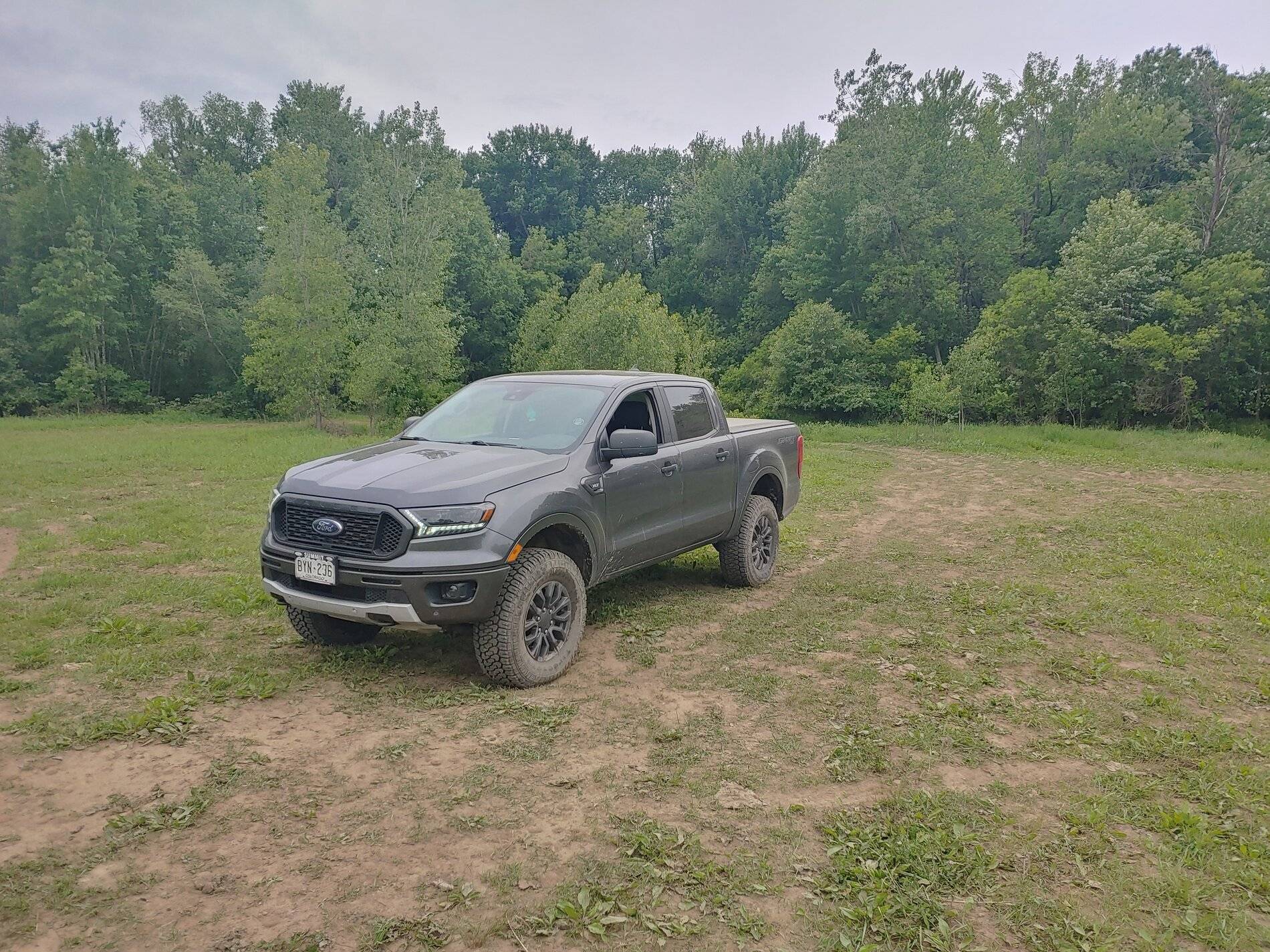

Im also very new to this and this is also my first truck. I have the same color and spec as you do and that is the look I was going for - Perfect IMO! Would you mid telling me about the lift? Did you only do a level kit? did you have to remove the crash bars for the 285's?

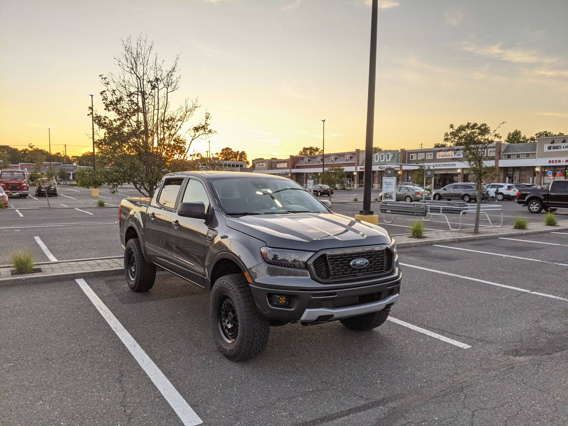

I just want to say that I was at your exact same spot during Q1 2021 and my stock-suspension-265s-plan evolved into full blown 2" coils, upgraded struts, fog lights, headlights, UCA's, and 285s with different wheels by June... LOL :crackup:
Best of luck. Here because my tires are 285/70/17 Wildpeaks and to be a bad influence :devil:

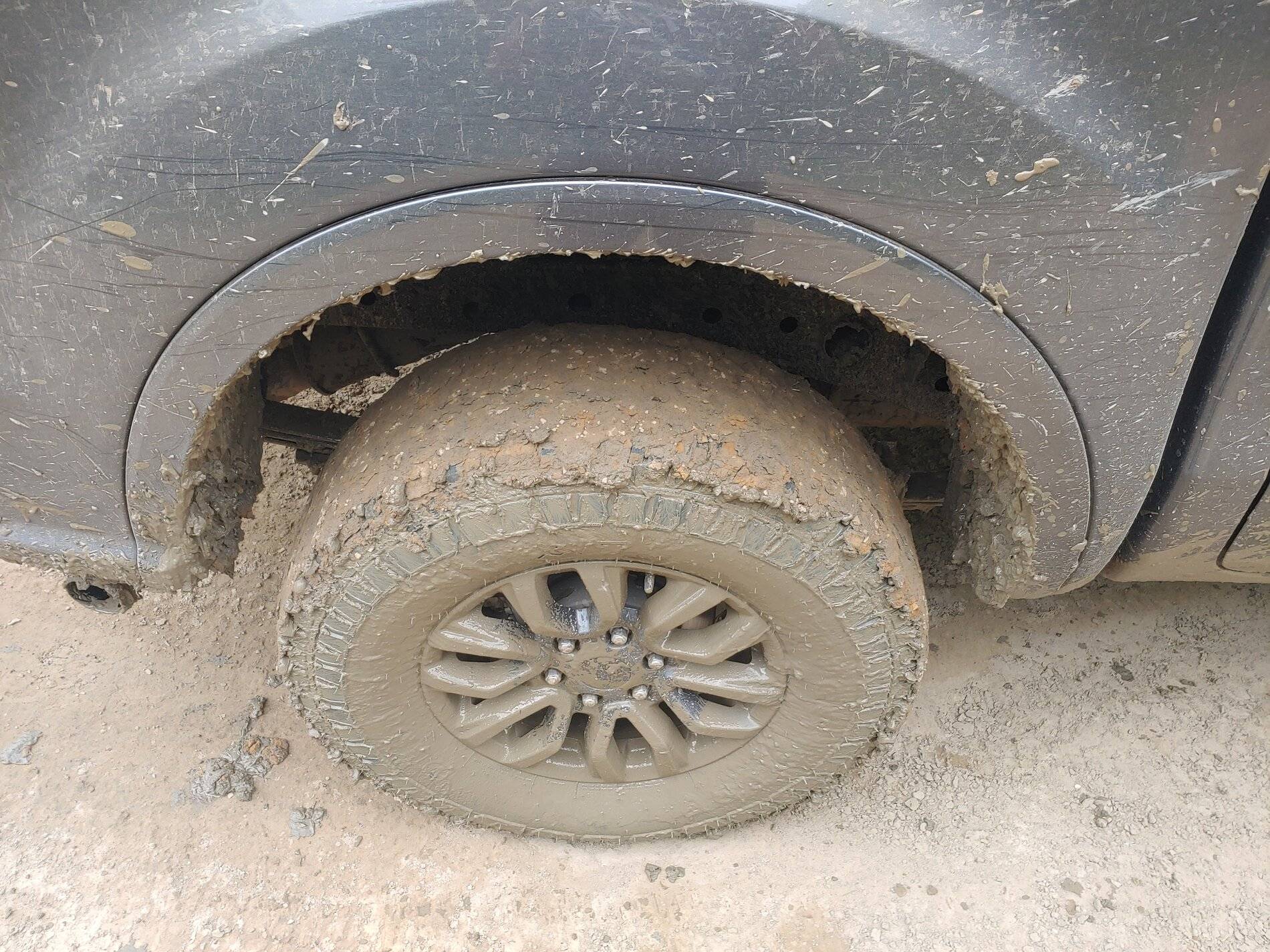

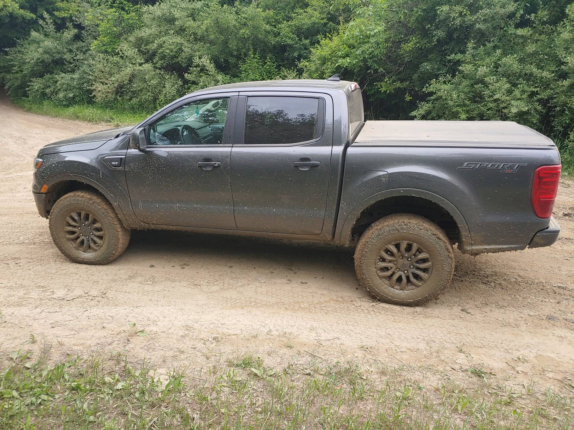

So I will start off by saying that leveling kits are dumb....... Simple as that and not going into explanation.
The Old Man EMU lift kit is just that, a lift kit. The front is raised by 2.4 inches and the rear is lifted by 1.6 inches. How is it done? It replaces all shocks and all springs front and rear. There are no spacers used what so ever.
Now I also have the basic OME kit. There is the BP-51 kit wich is nice but out of my price range at the moment. What is the difference? The basic does not have any adjustments what so ever. The BP -51 has compression and rebound adjustments available and the front struts can be adjusted for a heavy load(front bumper and winch).
The tires I have are 285/70-17 Firestone Destination XT's. Why is that important? Well I cant speak for other tires on the sport wheels with no spacers. This combination works well amd the only rub I have now is the sway bars at full lock. As for the crash bars they are still intact. Just removed the plastic covers and pushed them forward.

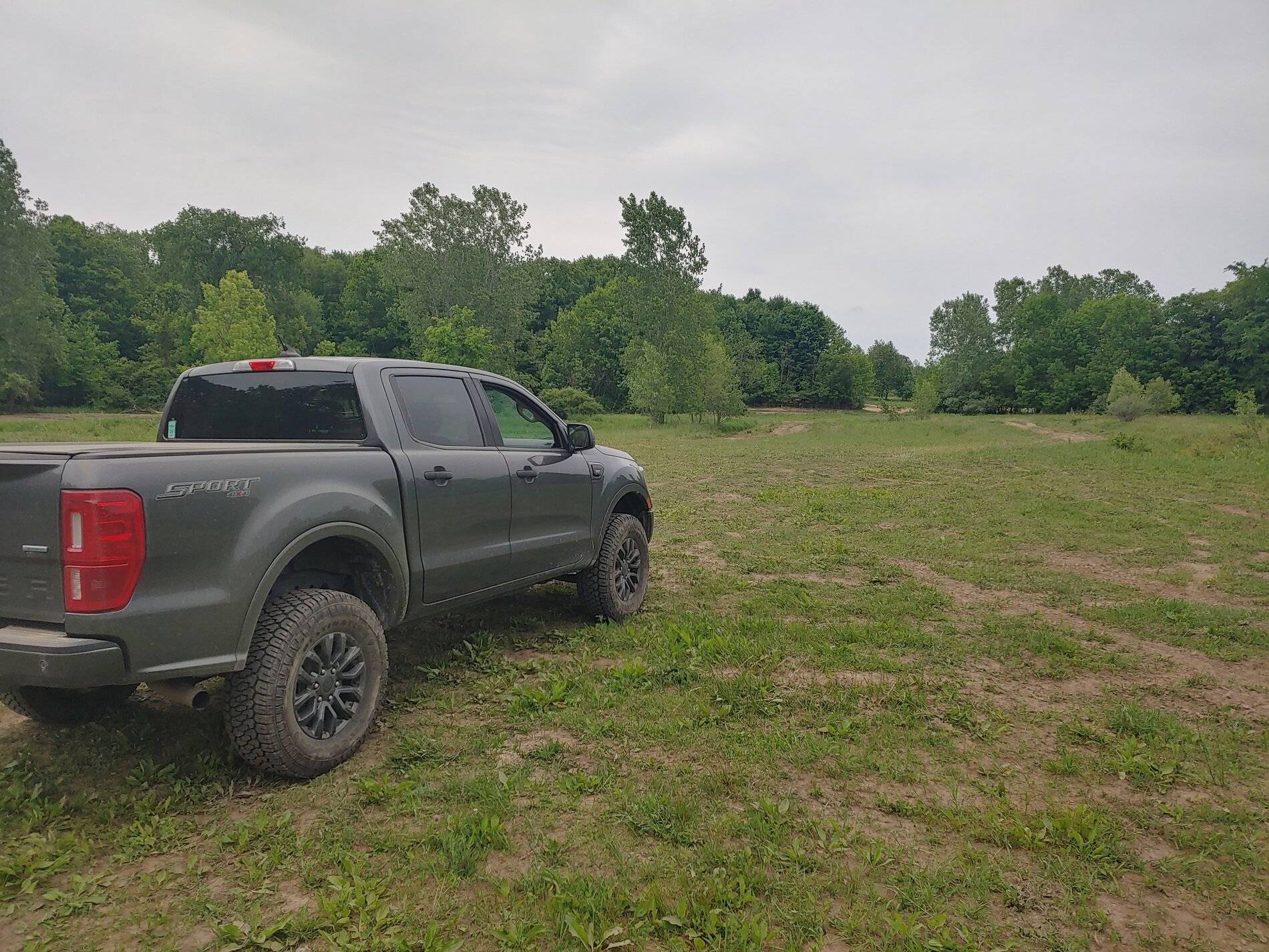

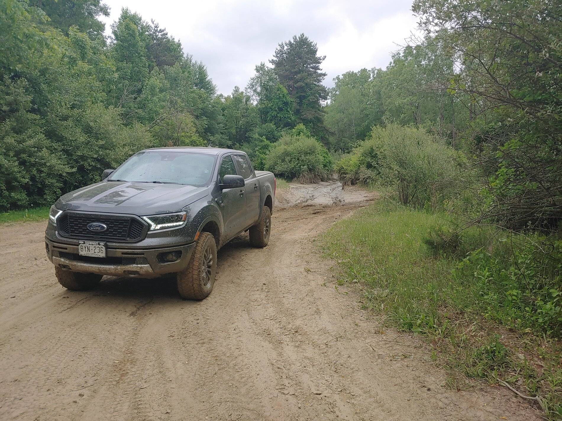

rspinajr
Jun 21, 2021
New Jersey
2021 Ranger XLT Sport
Restaurateur
HORRIBLE INFLUENCE! That looks so good!

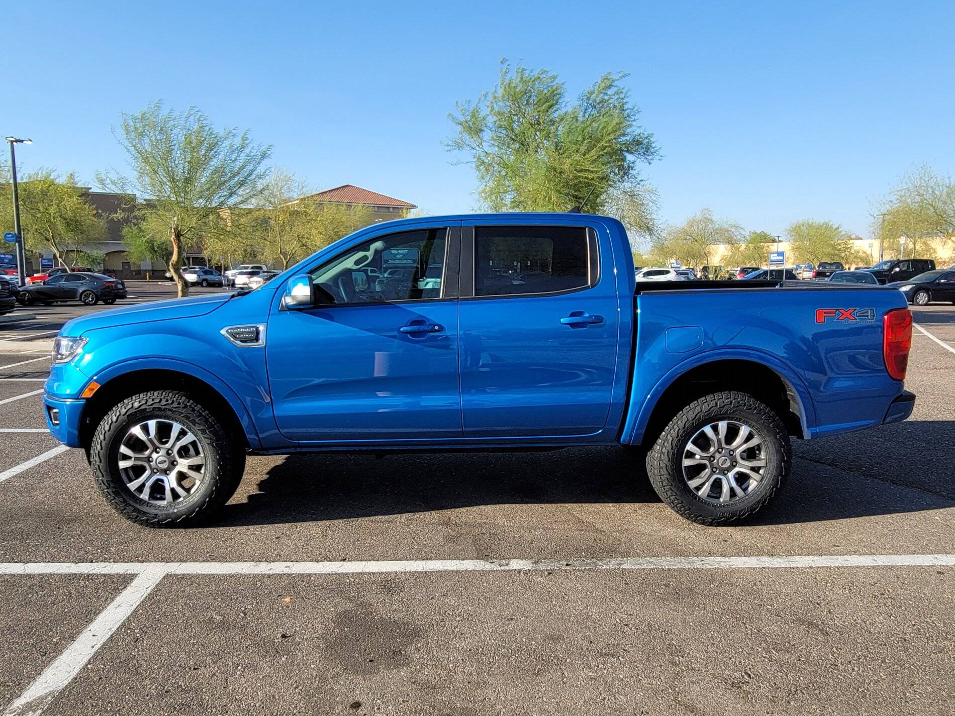

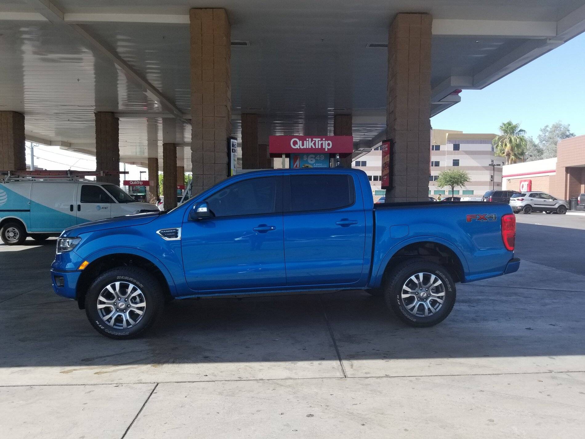

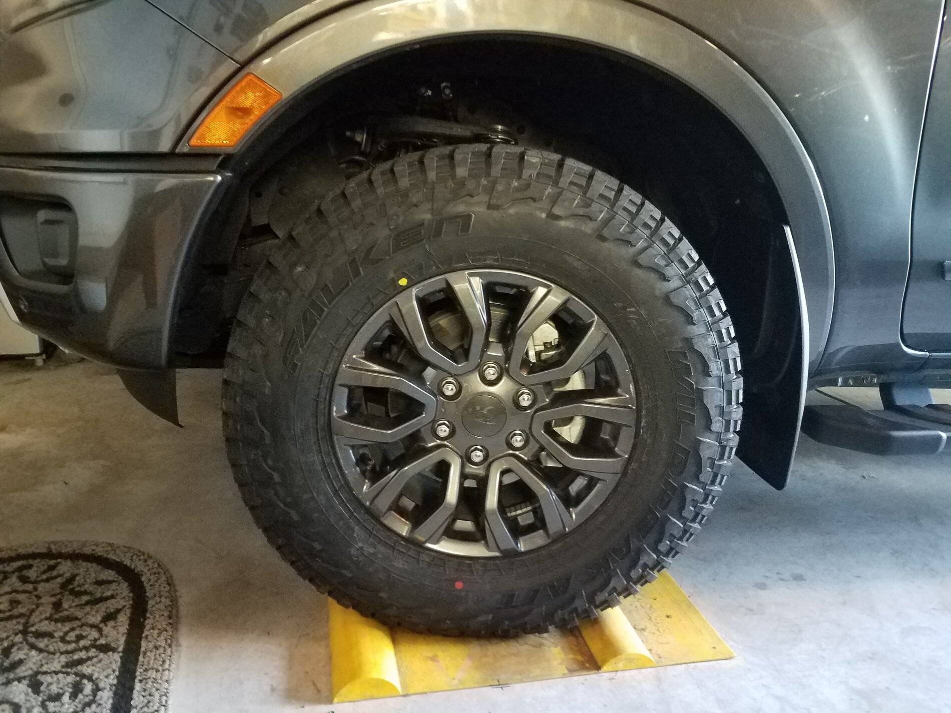

Just got 265/70R18 Falken WildPeaks. Just some slight rubbing when the front wheels articulate at full lock it looks like. Not to worried it about it since I will be getting the front lifted so that should take care of the issue. The crash bars have a small amount of adjustment that might take care of the issue. But if your plan is to keep the suspension stock then 32s would probably be better.
Before the new tires
With new tires
