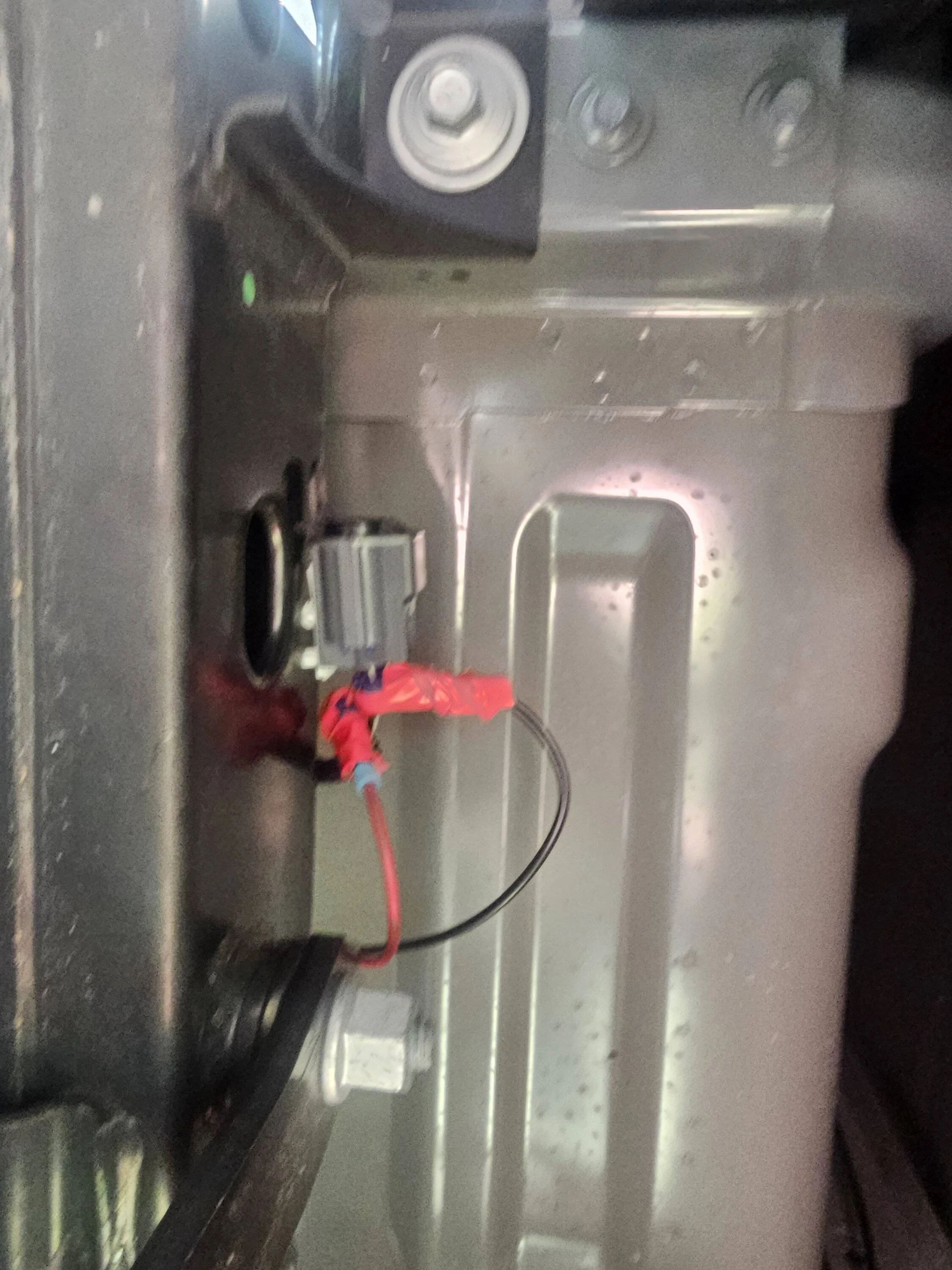

Ok. I figured it out. Light is working as it should now. I ended up calling Super Pacific and asked them what color the wires were for: Red-Brake, White-ground, Black-tailight. I ended up using a 2-prong water tight connector and attached the red wire from the camper to the red wire on the connector. I then connected the white wire from the camper to the black wire on the connector. When this was completed I used a wire connector https://www.amazon.com/Posi-tap-Con...95455&hvpone=&hvptwo=&hvqmt=&hvdev=c&hvdvcmdl to tap into the red wire and black wire on the tailight assembly. Afterwards, I cleaned everything up with shrink wrap and we are good to go!
Good to hear! Nice work.
