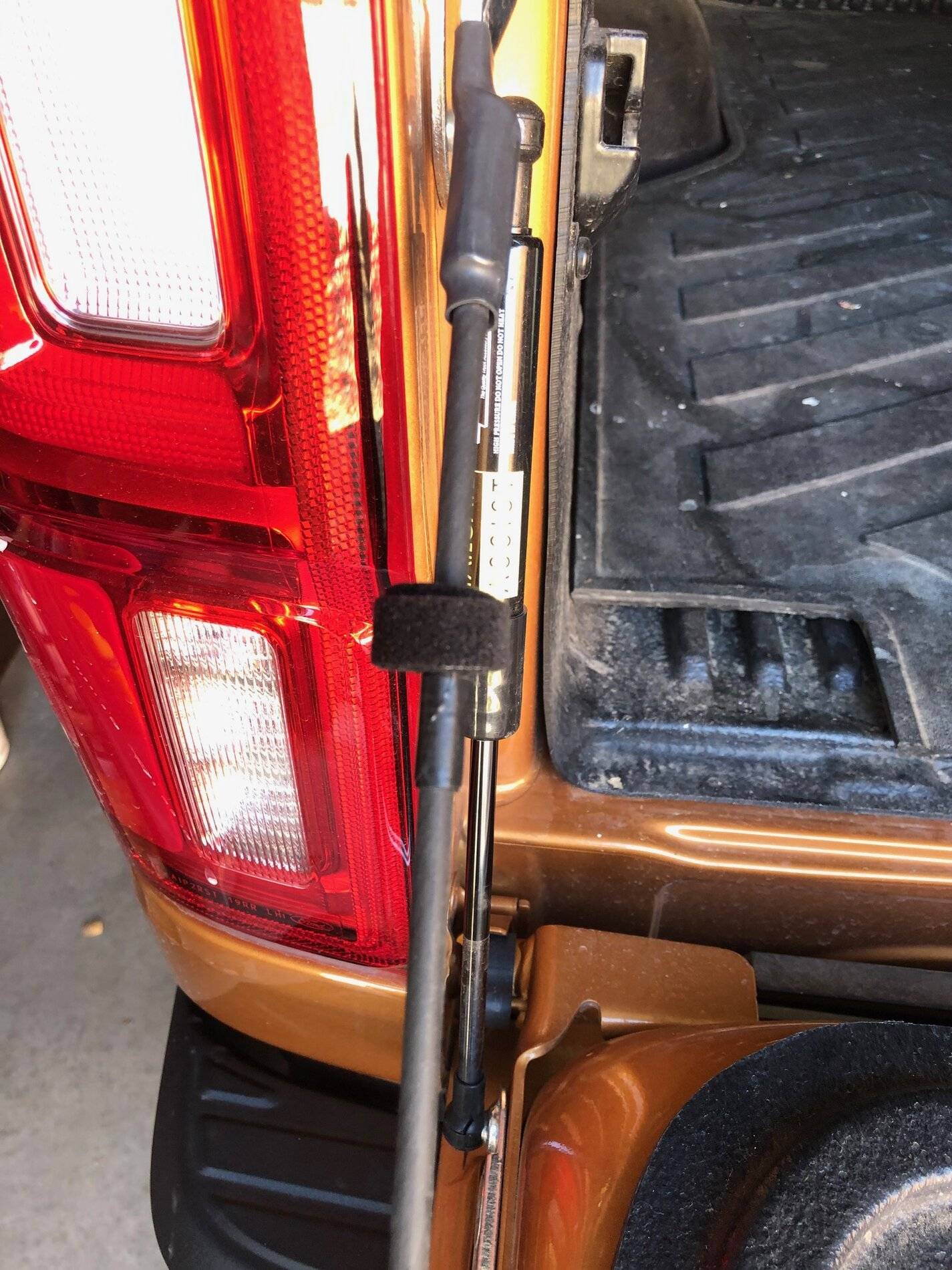

Scott, here's a picture of how it looks. I added a velcro tie so the cable doesn't get bound up. Yes there is a whole thread on damper mods here. lol ?
Velcro:Tailgate Strap.jpg
Nice! How does the velcro hold up? I just ordered the damper!
Mine has been on there since October 2019 and is fine. I added a little electrical tape under the velcro so it doesn't slide down. You could just wrap some tape around it a couple times and it'll do the same as the velcro.
Great idea!
Looks like not all tailgate cables need a fix with velcro. Mine, for instance, I trained by pushing it out of the way about 3 or 4 toimes. Something to watch after you first insta ll.
I'll let you know how it goes with mine.
Also be aware that even if you can train the cable, it still may get hung up on the mounting bracket for the damper and get pinched. Some people have used gorilla tape to cover the bracket. I used caulk. Both of those are shown in that damper mod thread.
Added: Page 5 and 15.
