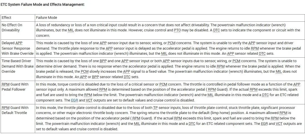

While researching the other thread (issue) I wanted to see what kind of fail safe the throttle system had (if any) as this is (Electric Control)
and found this:
Block, 2 or 3 would describe the OP's issue. I am thinking #2
Note: The Accel Pedal has 2 circuits (redundancy)
Note: BPP = Brake Pedal Position
I am thinking both posts are related to this: Failure Mode
