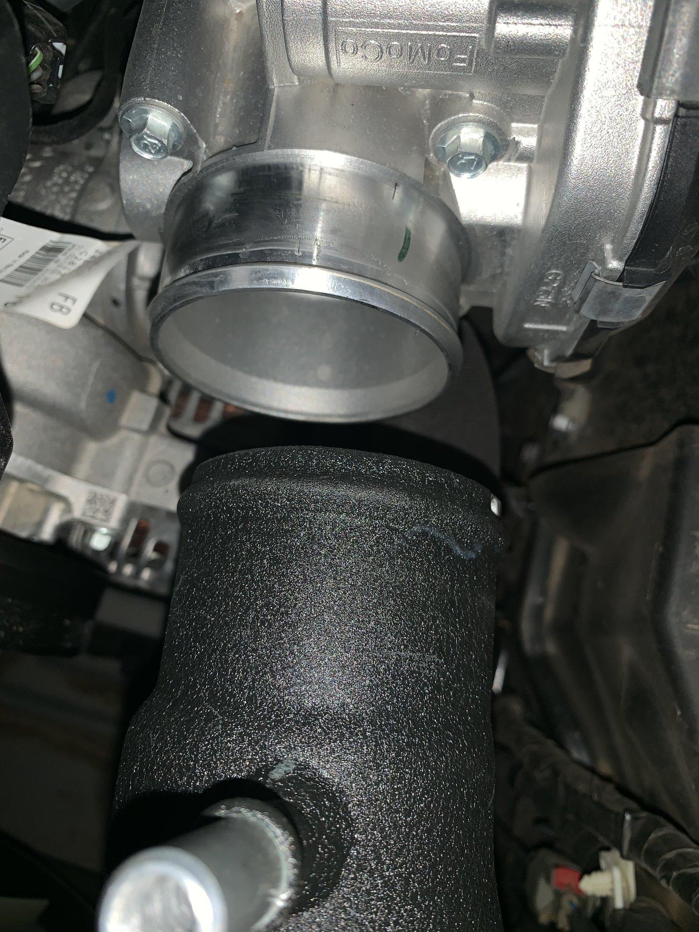

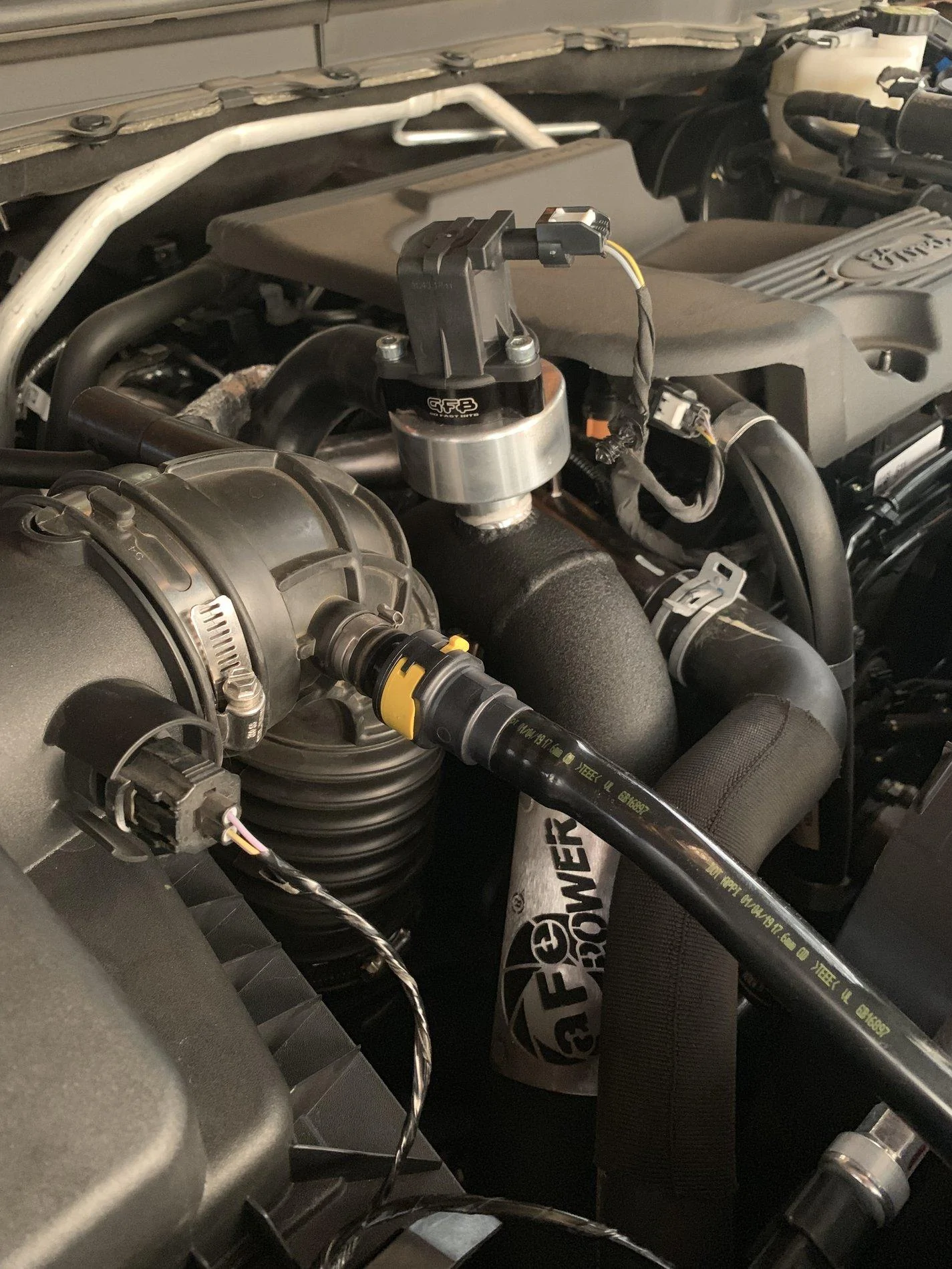

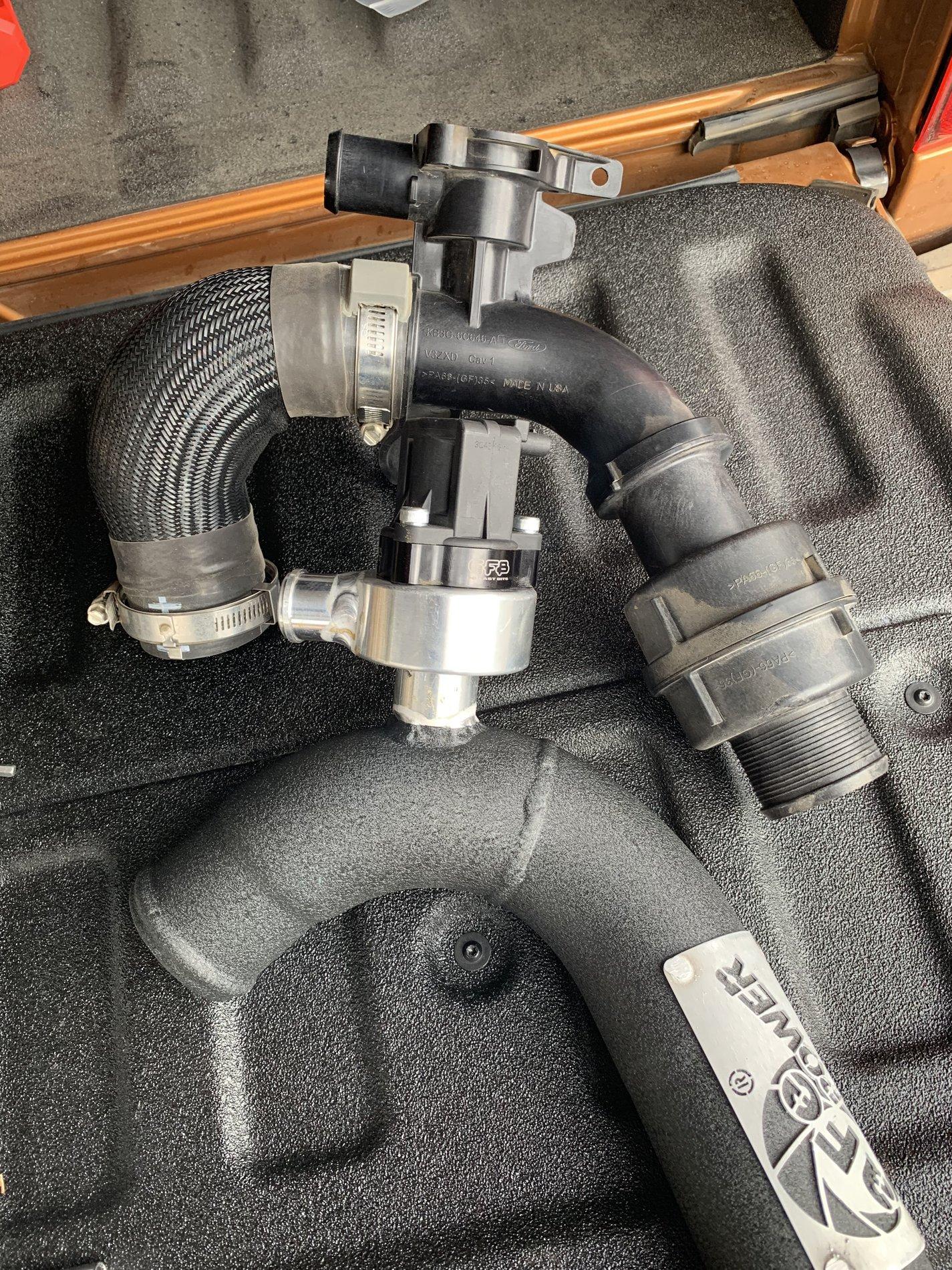

Got the pipes installed. Cold side is to long and should of been shorter with a longer coupling. It might be okay but depending on how much the engine flexes it could break the intercooler. Hot side is too tall and won’t clear the GFB add on diverting valve. Annoying little things that could of been avoided. But they look cool and that’s all that counts right?
