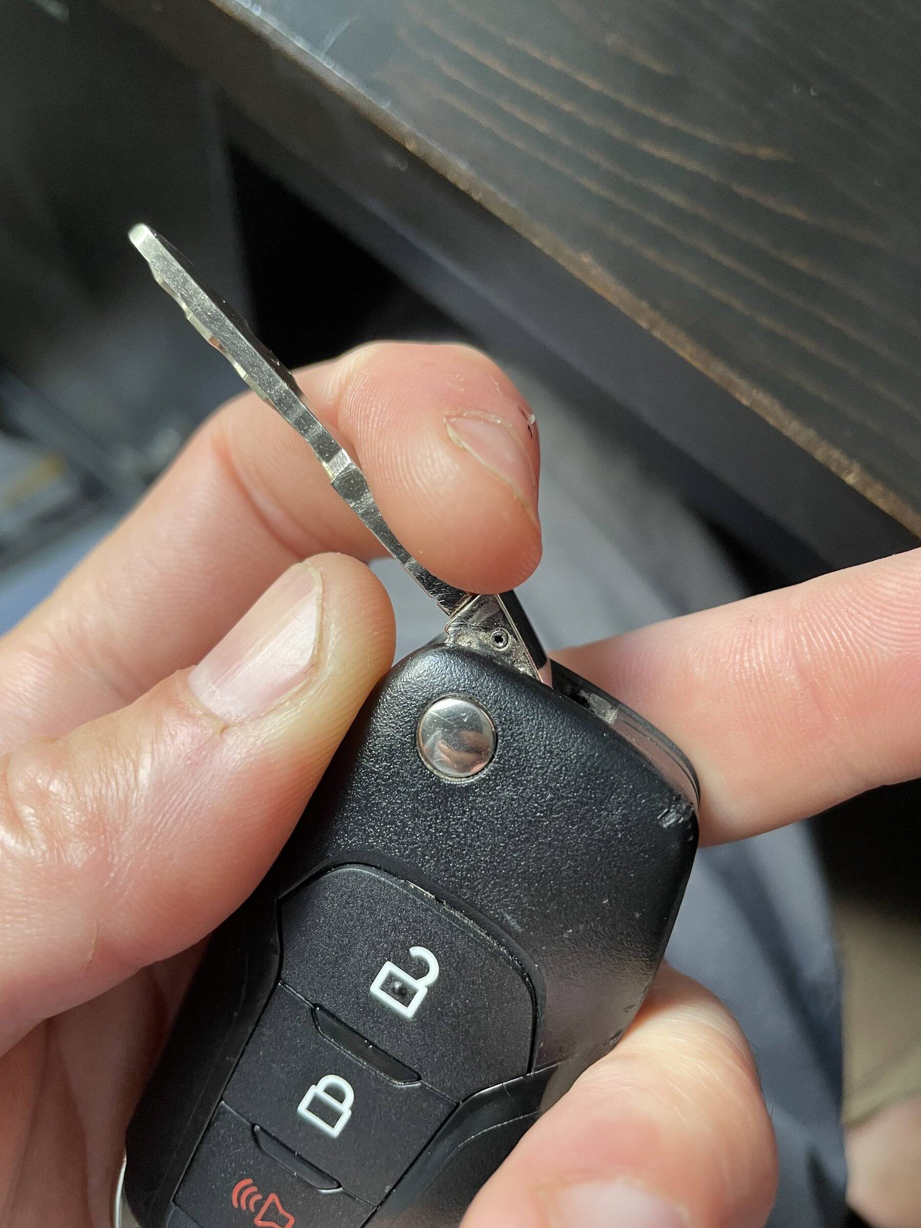

Hi, started my Ranger yesterday and my key came out after it started and I couldn't get it back in. I was able to shake and wiggle it enough to turn engine off but it's still in ACC. I called dealer and have appointment Monday for repair. Problem is now I can't start it. I had to disconnect battery to shut it off.
Anyone else have this happen to them or know how to get key back in?

You mean the switchblade part broke and you have the fob but the key shaft is in the ignition?

Hi and thanks. Nope no one tried to steal it. I just turned the key to start it and it started, when I was removing my hand from fob/key it (the key and fob) just fell out. So the truck was running, key won't go back in more than 1/8th. after trying and trying I finally got it to turn back enough to shut off, but then I couldn't restart because I can't get a full cycle, but it's in the ACC position so radio on. Really strange and I tried for 30-40 mins no luck.

The little pin on my fob slowly works its way out over time. Usually I notice because it makes the key a little harder to open, so I push it back in. The key on my 2015 Golf did the same thing. I can definitely see how it could get stuck in the ignition if the pin was gone and you didn't notice.
I don't think he is referring to the key detaching from the fob, but falling out of the ignition lock with the truck running. Sounds like a faulty ignition set to me, will need to be replaced and re-keyed.

Update: Had it towed to dealer and they are replacing the ignition. None of the techs had seen this happen before.
Seems like the unfortunate, but obvious solution. Something happened in the cylinder to allow the key out when not in the off position. Maybe a defective unit with sloppy tolerances or something. Should be a warranty repair though, hopefully.
