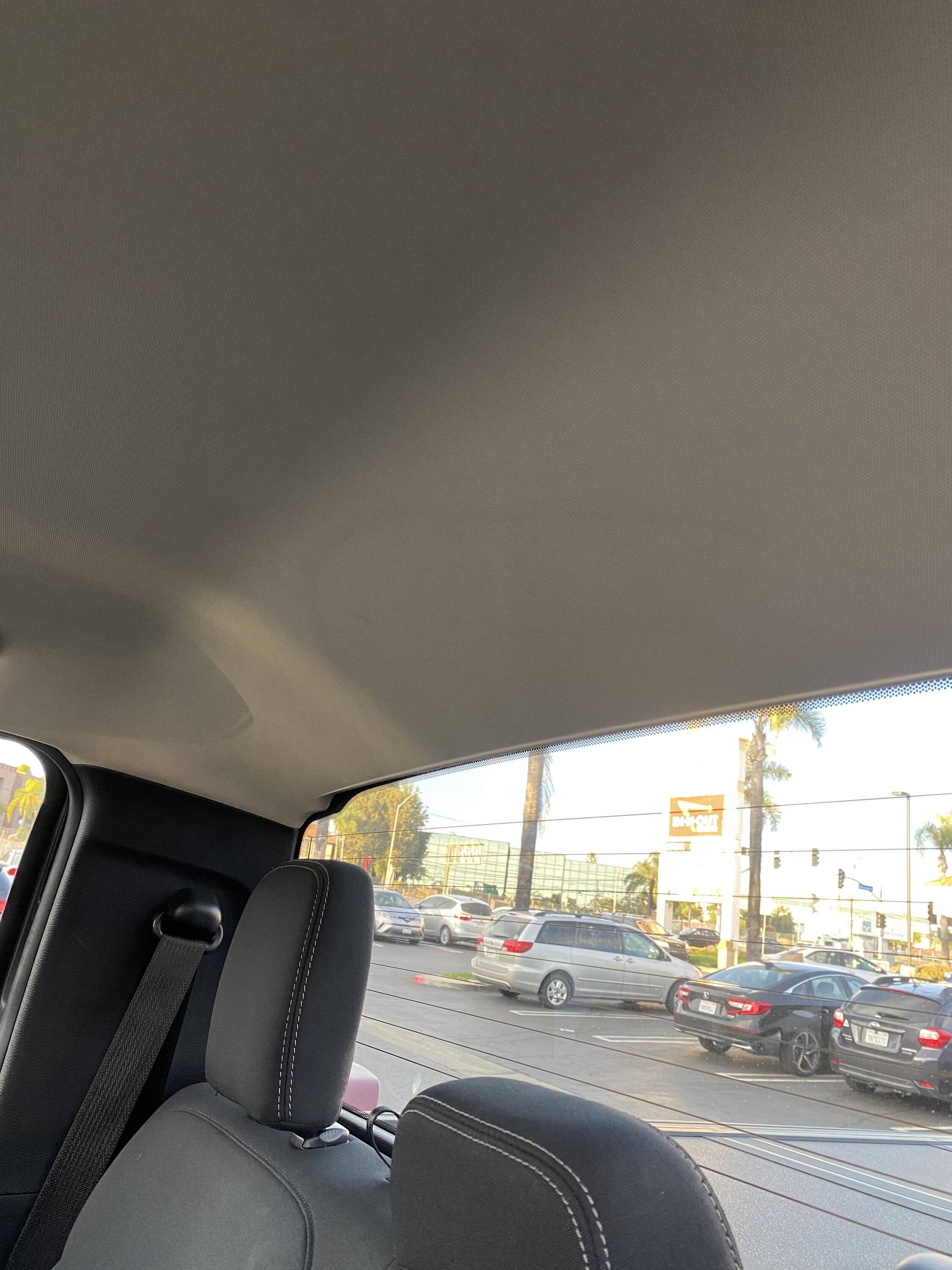

Noticed today that my Ranger is leaking water into the cab ?. Either through the 3rd brake light, antenna or back window. Hopefully covered under warranty. Will find out soon…
has anyone experienced this?
That happened to me after I modified my CHMSL....I made sure to seal it and cleaned the liner and it was fine after...
